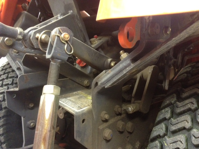

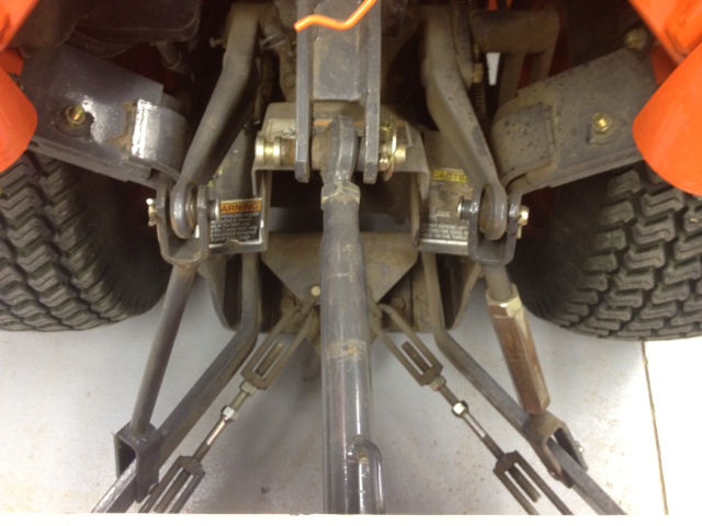

Thanks to all for the help....
Yes, I do have the alternate frame mounting points for the lifting rods to mount to, underneath the fenders...mine are actually part of the body/frame of the tractor, not a bracket like shown in the diagram. I don't think I'd want 500# on those points, but a couple hundred lbs is probably OK.
If I get the weight box mounted to permanently on the tractor, it will prevent me from running my lawn sweeper, as it obstructs the hitch. Hmmmm. As it is, I can take the weight box off in about 2 minutes. I do have a concrete pad to mount/dismount my loader. My yard has lots of hills, so even without a loader, rear weight might be a good idea.......
I also have a rear mounted bagger that came with the tractor which I don't want to use, as I have about 2.5 acres of grass and end up doubling my mowing time (it seems) because I spend half my time emptying the bags. BUT, it does add ballast to the back, and I noticed it does not mount with the 3 point, per-se (it mounts in a static position to the lower arms). I'll see if I can post up some pics to explain. It is awkward to remove, just thought I'd throw that out there because of how it is mounted.

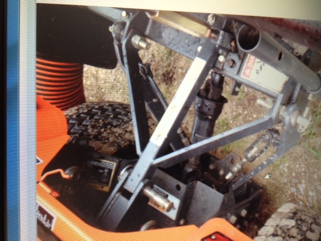

mine1.JPGmine2.JPGBagger.JPGmine1.JPGmine2.JPGBagger.JPG (pic of the bagger attached is not my actual tractor but one at the dealer I snapped a pic of last year as I had forgotten to take a pic with my bagger installed)

5) How does a 3 point mounted salt/seed spreader mount........does the height go up and down, or are they mounted in a static way? That is something I had considered, for seeding the yard in summer, and sanding/salting the driveway in winter (in which case, I'll sell the weight box).
I've only seen 3pt spreaders that mount in the typical way to the three links, but I haven't looked a lot either. However, in looking at your grass catcher pictures, it seems you could make a similar mount (or use that one?) that would make a spreader static. (Could probably use it for your weight box for that matter.)
The catcher mount is static because it forms a solid triangle (really a pyramid) from the lower links to the top link frame mount point and out to top of catcher frame. The disconnected lower links can't drop because of the catcher mount pieces that go from the lower link ends to the top link frame-side mount. The whole thing can't tip backwards because of the top of the pyramid - the mount piece from the top link frame mount out to the third point up above on the catcher frame.
It looks like you can unbolt that mount from the grass catcher frame? If so, it may be you could use it for other 3pt implements. You'd have to drill a hole through the implement end of the top piece of that mount so you could put a pin through - basically making that top part a top link. Or, you could build or have built a similar mount to use if you wanted to leave that one on the catcher.
