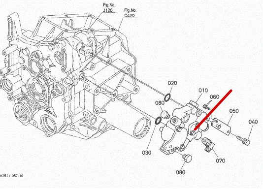

Hello,
I blew everything off with an air compressor to get a better view of the area. When the 3PH lever is raised to max, oil leaks from behind the plate shown in the diagram. In my case there is a hydraulic valve installed where the plate goes. This valve controls a cylinder at the front of the trator for a snowblower.
I removed the valve and cleaned the area thoroughly. I then made a gasket from RTV silicone on the valve and let it dry. I installed it on the tractor and it no longer leaks.
I wish I could find documentation for the valve I added, but I can not determine whether it was supposed to have a gasket or not. I am using blower 2750D with quick hitch kit BX2711 and mid pto kit 2712.

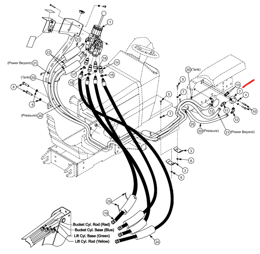

There were no seals or gaskets to be found. There is no groove for an o-ring either. The closest thing I can find to relevant information is this brush hog hydraulic kit for the BX series. The red line points to a valve that looks identical to the one I removed today. It shows 2 o-rings on the back of the valve, maybe they install on the mounting bolts?
We need to find the documentation for the BX series add on valve. I will keep looking.

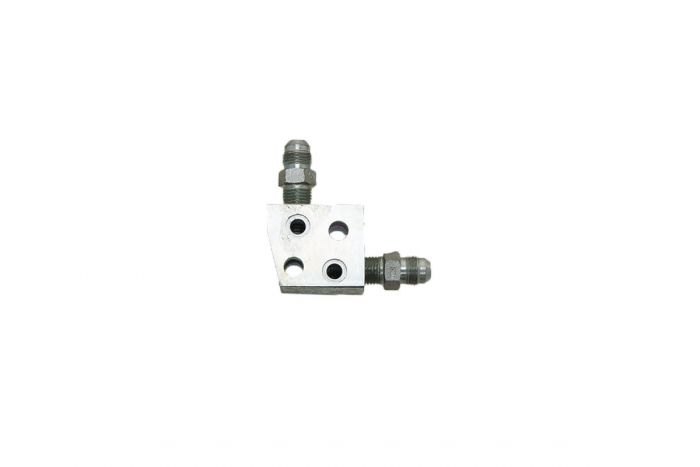

Blake,
I find it concerning that you did not see any grooves for the O-rings in the valve mounting surface. The seals must go around the ports - oil passages so some form of counterbore or groove is required.
Here is a photo of the adapter block. Looks it has recesses for the O-rings.
Thanks for your assistance Sir!
   / BX1500D leaks HST oil when hitch is raised #18
That picture certainly looks like it has recess for O-rings and would explain the leak if they are missing
Glad I was able to assist in diagnosis and appreciate you confirming diagnosis since this could help someone else in the future.

In that spirit - the part numbers are
O-rings: 75538-68130
Hydraulic Adapter Valve: 75538-68112
