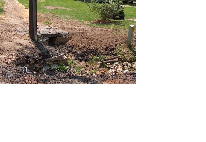

Finshed results,

One last photo of building new culvert, notice, from left to right, gas line, telephone, culvert, tractor, road.
Fun project, all in all. /forums/images/graemlins/grin.gif

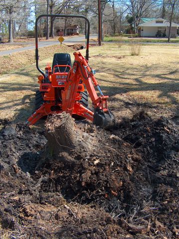

Also as part of this project, I removed this large oak tree stump, its about 16 inchs in diamater, took, about an hour, but got it out.

Dayum....that is a big stump. No worries then using a BX24 for such tasks I would assume.

Just take your time, and use leverage, put bucket under stump, and curl, it takes time, but works. Also, if you have a come a long, it some times helps to put a cable, around part of the stump, and pull it so that it twist the stump in the ground, so that it helps to break the wood.
