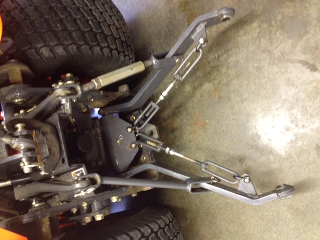

I need to put the 3 point hitch on a BX22, but don't have a copy of the instruction or parts manual. Does anyone have a copy that they could scan and email to me?
I need to know what to put into the center hole on the triangular piece that goes over the pins that the arms slip over. The part that I am referring to is the gray part at the bottom of this picture.
I also need to order some spare pins, etc.. Searched Tractor Supply for pins, but they didn't have anything small like is used on the BX.
Thanks for the help... Dusty

Hmmm..
I assume the pieces with the threaded adjusters and the loops on each end are the stabilizers??
I also assume the adjustable links with the U ends are the links that raise the 3pt arms?
That leaves the part you mentioned at the bottom of the pic as the piece the solid shaft goes thru after passing thru brackets on the tractor? Then the 3pt arms go on each end of that solid shaft?
What I can't comprehend is how the adjustable stabilizers with the loop ends fasten to the 3pt arms and to the 2 outer holes of the mentioned triangular bracket?
Seems there are parts missing??
Go to the Kubota website and click on "parts". you might have to use a dealer site such as "Messicks". Then work your way toward the part schematic for this machine and the 3pt assembly. Should be able to see a detailed pic of how it all fits and if you are missing something.
Good luck.

Looks like you are missing a bag of hardware??
   / BX22 3 Point Hitch Manual / Instructions #5
It looks identical to my BX 25 hitch. You are missing a lot of small parts. The OM does not give good directions for installing the unit and it is somewhat baffling until you see one being assembled or taken one off. One of the poorly engineered part of the BXs (in my opinion). Pages 216, 217, and 218 of the parts manual show all the pieces. It does not tell you how to install. I have taken mine off many times and I could never assemble it from info in either the OM or PM. I have made a lot of modifications to mine to make it more installer friendly.

At the start I replaced the cotter pins with the removable hairline clips. Makes it way easier, sometimes 3 hands is a must. Once you remove the plate covering the lower link pin and move the arms and bushings to the center, the lower link pin can pushed left or right thru the hole, then pull it out. Took me a few times to figure it out. Reverse for installation, I think its harder to re-install than take off, thats where 3 hands come in.

Here it is installed on my BX22
