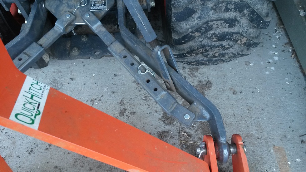

I bought those Hodges adjustable arms and they do not work with my Land Pride Rake or my Kubota mower bagger, so I don't use them at all. It's a much bigger PITA to switch between the standard adjustable arms and the Hodges adjustable arms every time I change implements, so now I just use the standard threaded ones. I'll sell you my Hodges adjustable arms cheap.

If I didn't already have 2 of Marks set ups I would. The one thing I did have to do to his was cut an angle where the pins attach. Maybe try that and see how they fit. Originally his were all right angles

Yes, I tried filing off an angle on the square ends on the adjustable arms, but they still interfere with my attachments. I think Mr. Hodges should make it known to his customers that this problem exists. Oh well, add it to the bucket of stuff I regret ever buying.
have you contacted Mark he is a great guy and sure he would take care of problem.
I've have had mine for 2 years with no problems on any of my implements.
   / BX22 3 Point Hitch Manual / Instructions #18
Mine are the same as yours. Yes I contacted Mark and he in fact acknowledged that others have had similar difficulties with the Landpride rake. He cautioned me not to file too much from the arm but other than that he had nothing else to offer. The pic shows the issue...
