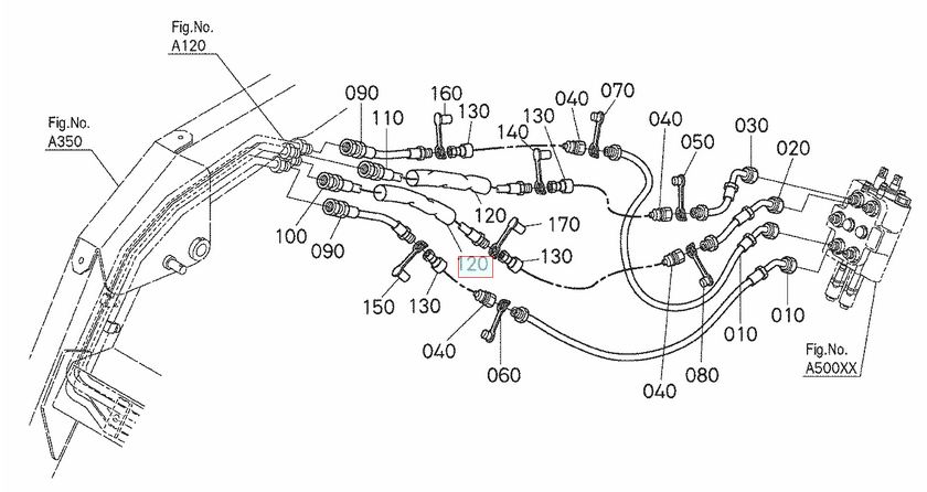

Ok, so to revive an old thread. I recently acquired a BX22 and it has a 4 position control valve, just found that out. Some hoses/disconnects were leaking on the loader so I decided instead of replacing three out of seven hoses, i'd replace all of them. Assuming I had a 3 way control valve i ordered from the dealer and got them yesterday. When I went to install this morning I realized hoses are all different and that is when i went back to schematic and realized i had a 4-way C/V. I know, dumb of me not to even click on that pic to compare earlier but here I am. After examining everything, I am wondering if I can just use these hoses off the 3-way valve to connect my 4-way valve onto the loader. There are 4 outlets in question off the C/V and the only difference i can tell is with 3-way they use one long hose to connect to rigid lines in the loader, with 4-way they use 2 shorter hoses for each line with quick disconnects on them, i guess if you want to connect something else onto the control valve. I really dont want to be down for another week - returning these hoses and getting new ones, so I am thinking i can just use the 3-way c/v hoses on mine and everything should be fine. Below are schematics for each off the kubota parts site. Let me know if I am crazy to do this. And i never plan to add snowblower, blade, broom in the front, and if i do, I can then order proper hoses and go back to the current setup.
3-way hose setup:
4-way hose setup:
   / BX22 4-way valve or 3-way? #13
Your loader can't know if it's connected by two short hoses or one long hose, so it will work fine. I think you're right, the 4-way hoses just allow for connection to some other implement whose connector terminates at a different location and with the opposite gender of fitting, so wouldn't fit the control valve connection.
