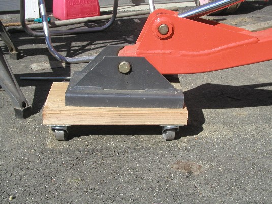

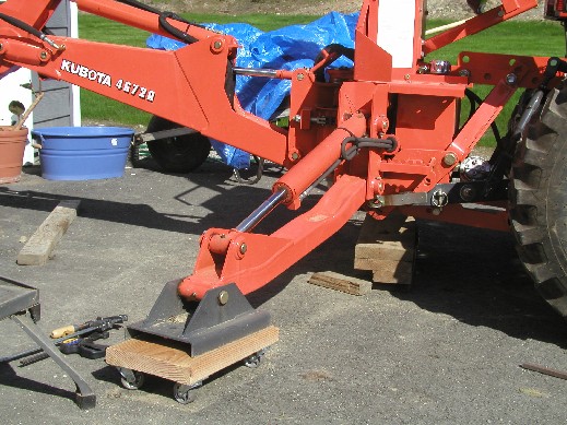

I used a larger dolly then need because I used the dolly for my old tractor loader. I would probably make the larger dolly 2 X 3.
I put the tie down to help relieve pressure on out riggers.

Thanks for making the web site and posting the pictures of back hoe removal and storage. I may try and store my backhoe the same way. out of the weather under my porch. After all it is the most exspensive attachment that I own for the tractor and the 2nd most useful next to the loader. David
/ BX22 BH install warning! #24
No problems guys! That is the least I could do for the great info out here.
I might add one note. I would add a like a 2 x 4 on edge under the long part to aid in deflection, due to weight. I wil add a picture to show what I mean.
