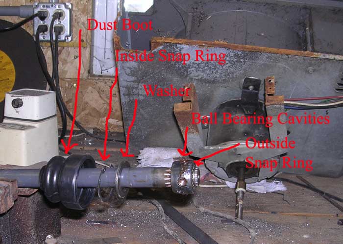

I found that just unbolting the propeller shaft was not enough. I had to remove the flanges to get it out of the way. To do this requires inside snap ring pliars. I also replaced a broken dust boot on the shaft in the process. Warning, after you remove the inside snap ring and pull out the shaft, there are 4 ball bearings on each end that tend to fall out and roll away! Don't lose them! Attached is a detailed photo of how the shaft mates into the flanges on both the engine side and the HST side:

So as you can see you also need to remove an outside snap ring to replace the dust boot. Time from start to finish 3.5 hours. Next time will be faster; I was going slow to make sure I knew how to put it all back together. The new fan installed:
