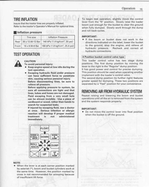

</font><font color="blue" class="small">( 2) I see a post here and there about 4 way hydraulic valves on the BX 22 loader, I get the impression that this is a optional item. )</font>
It is optional, although my dealer told me he won't order a tractor without it. It doesn't really effect the operation of the loader except that the 4 way offers a "rapid dump" option. The 4 way is mostly used for power angle front plow blades and front mounted snow blowers. It is cheaper to add it at the time of purchase / order than to have to buy it later.

2) 4 way valve - If the 4 way does indeed enable a rapid dump on the front bucket it could be useful to have provided it doesn't make the loader more complicated to operate or add significantly to the cost of the tractor. I will look into it further. If any one knows for sure about how this 4 way valve would operate the loader as compared to the standard valve please let me know.

</font><font color="blue" class="small">( 2) 4 way valve - If the 4 way does indeed enable a rapid dump on the front bucket it could be useful to have provided it doesn't make the loader more complicated to operate or add significantly to the cost of the tractor. I will look into it further. If any one knows for sure about how this 4 way valve would operate the loader as compared to the standard valve please let me know.)</font>
Here is the page from the manual about this.
