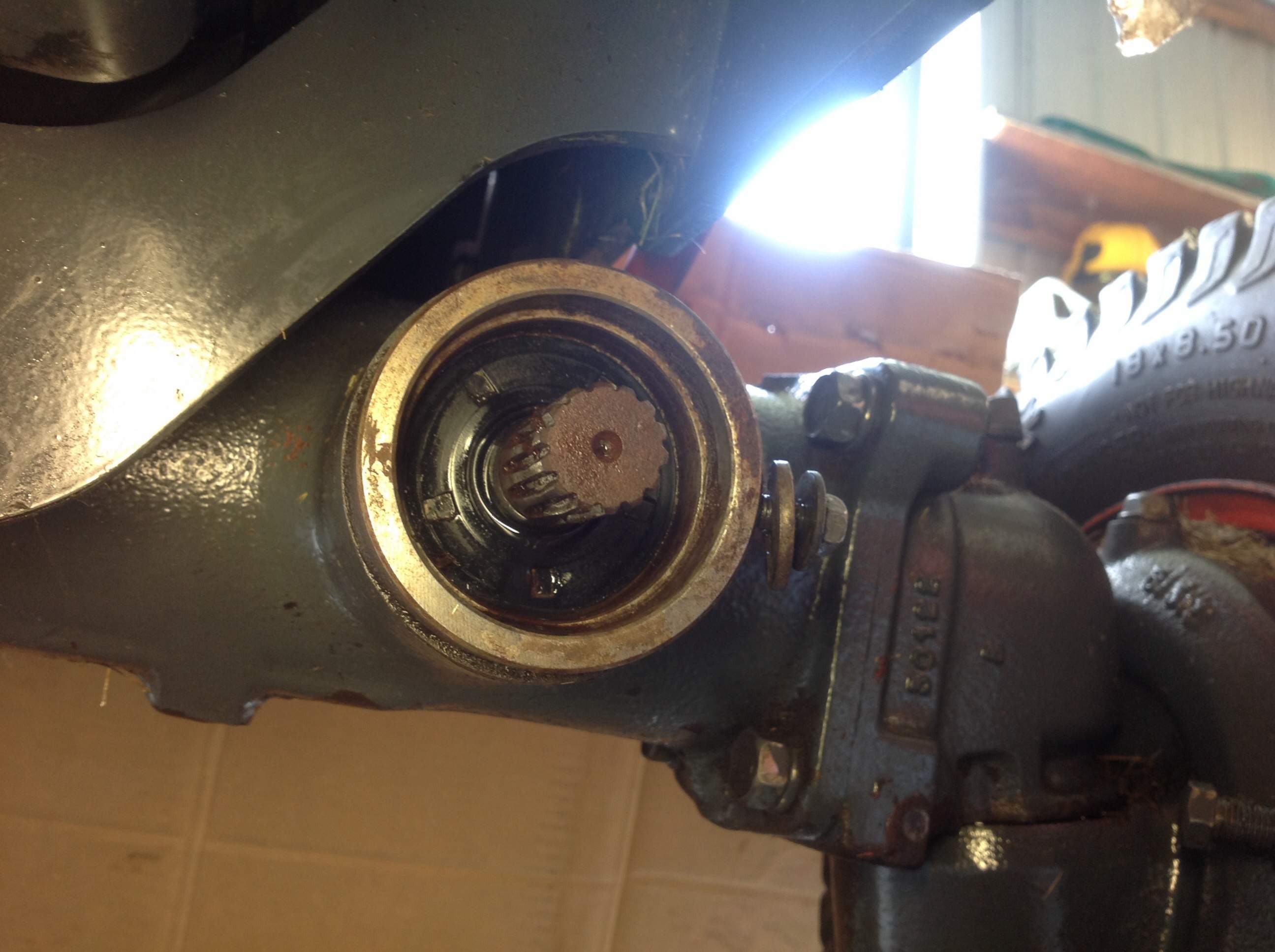

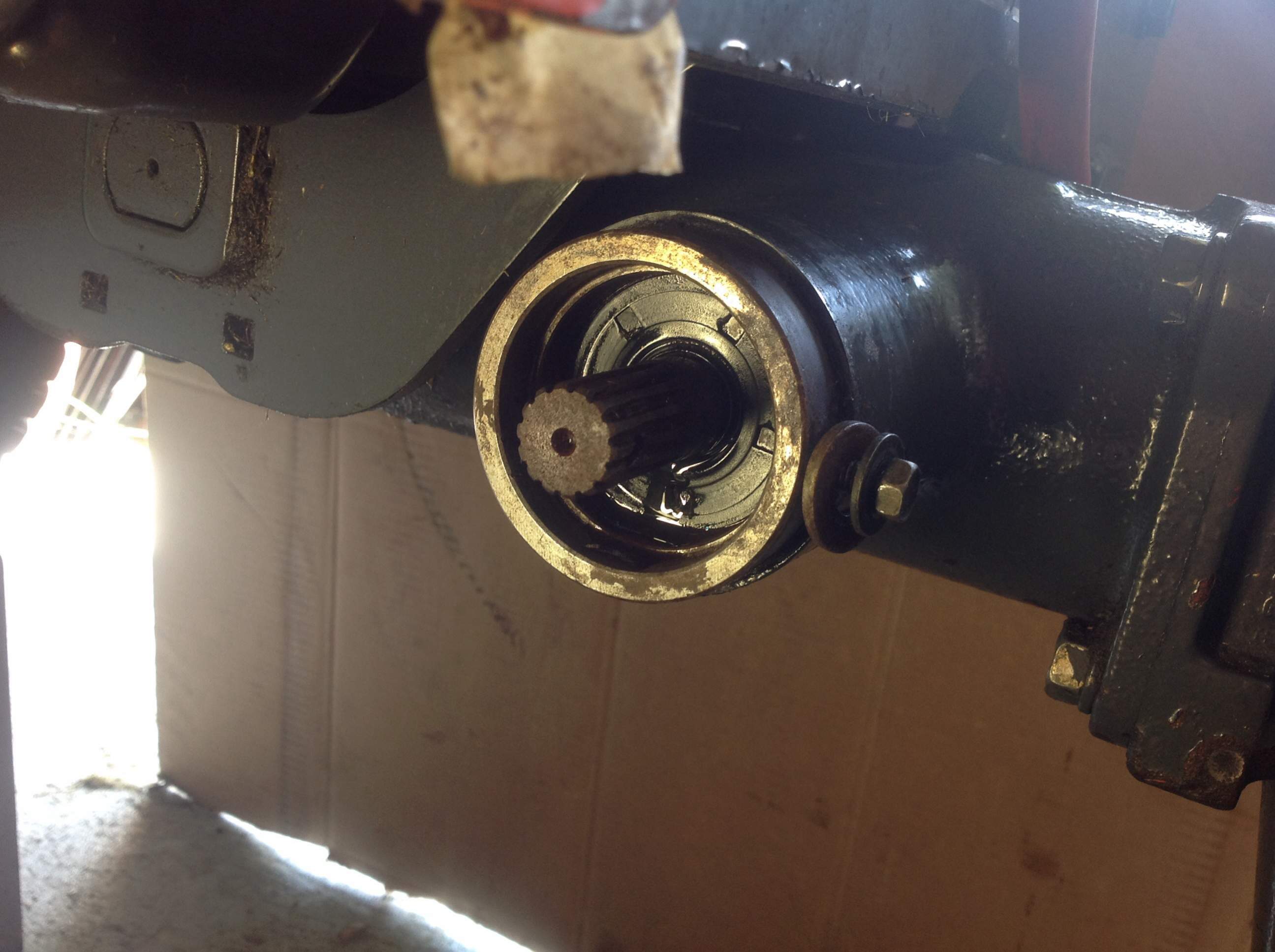

Where are the vents located please? I may have overfilled the front axle and oil is dripping on the floor. I have just changed the pinion seal. image.jpgimage.jpg
   / BX2200 front axle #5
Where are the vents located please? I may have overfilled the front axle and oil is dripping on the floor. I have just changed the pinion seal.View attachment 412963View attachment 412964
The vents are those bolts that are on what looks like a brake housing. They are almost blocked by the tire.
You can see one in the first photo over by the tire on the right side.
I fill from both sides until the oil starts coming out of the vents. It will take a while before the oil seeps into all of the nooks and crannies so check the level again after five, or so, hours.
You'll have to find out where the oil is dripping from since the front axle is supposed to be a completely sealed system once all the plugs are secured. There is no overflow valve that I'm aware of. Hope it is not a power steering leak!
