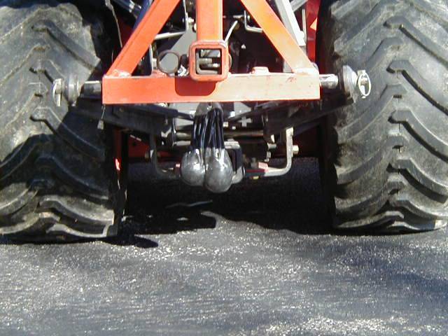

   / BX2200 lift capacity #8
you might want to check, yours probably has them too
