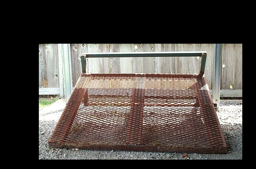

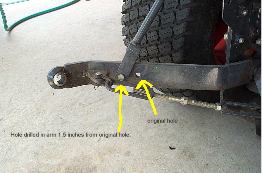

I had the same problem with a high sided truck. By using some expanded metal and scrap iron, I made a ramp that is light and easily moved with the FEL. I first used the car ramps as someone else suggested but they are hard to keep in place and easy to miss with the front tires. The only problem I had with the ramp was my box blade scraping the ground when used as ballast. I fixed this by moving my lift arms 1.5 inches further out towards the end of the three point hitch to give more lift height.

Your the second person who has move the 3pt lift arm mounting hole.
Can you post a picture of this change?

I got the photo today of the three point hitch modification. Will also attach a photo of the ramp used in the next post.

Photo of loader ramp. It was made with scrap metal and stays out in weather but it is helpful when extra loader height is needed.
