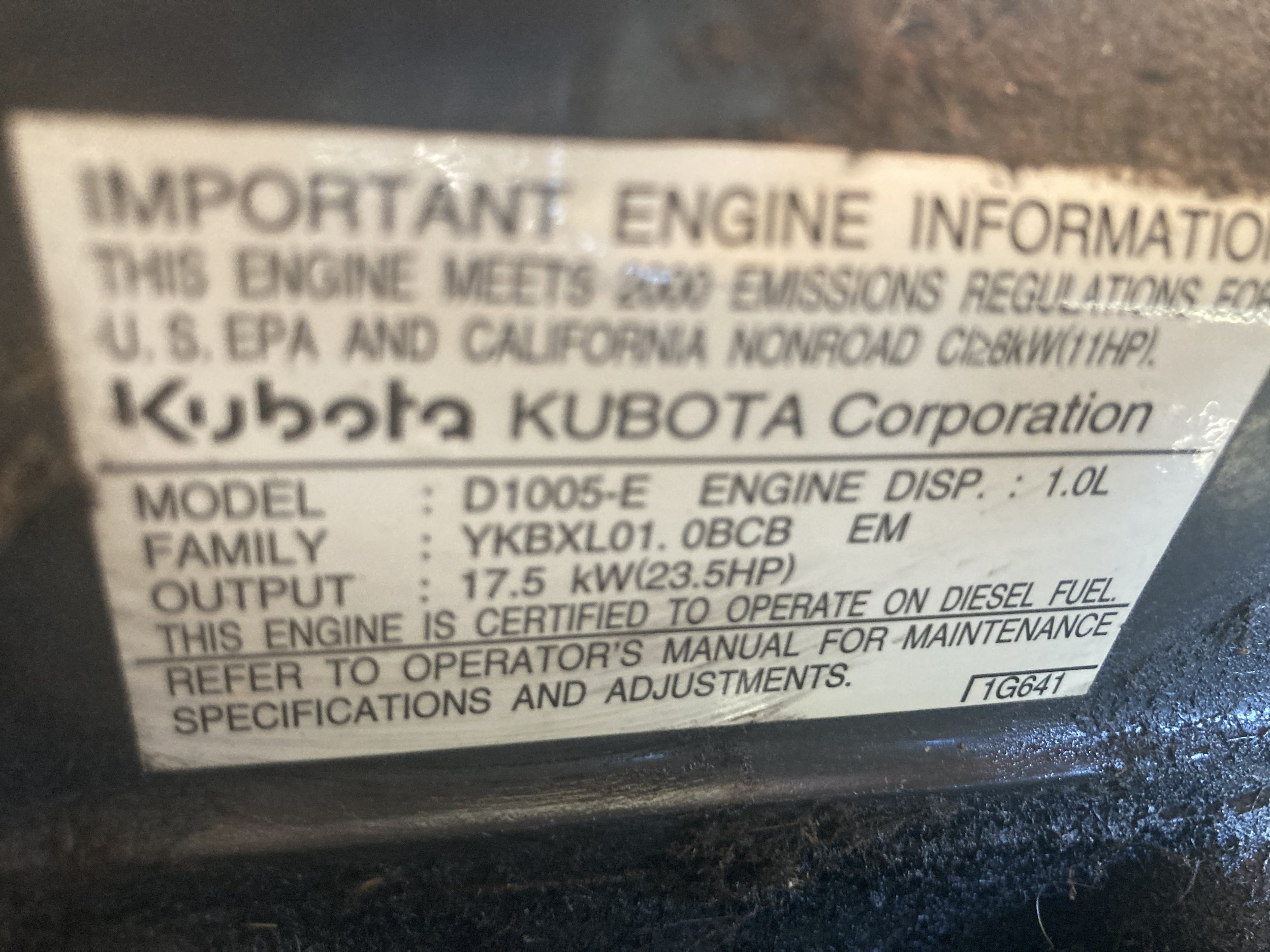

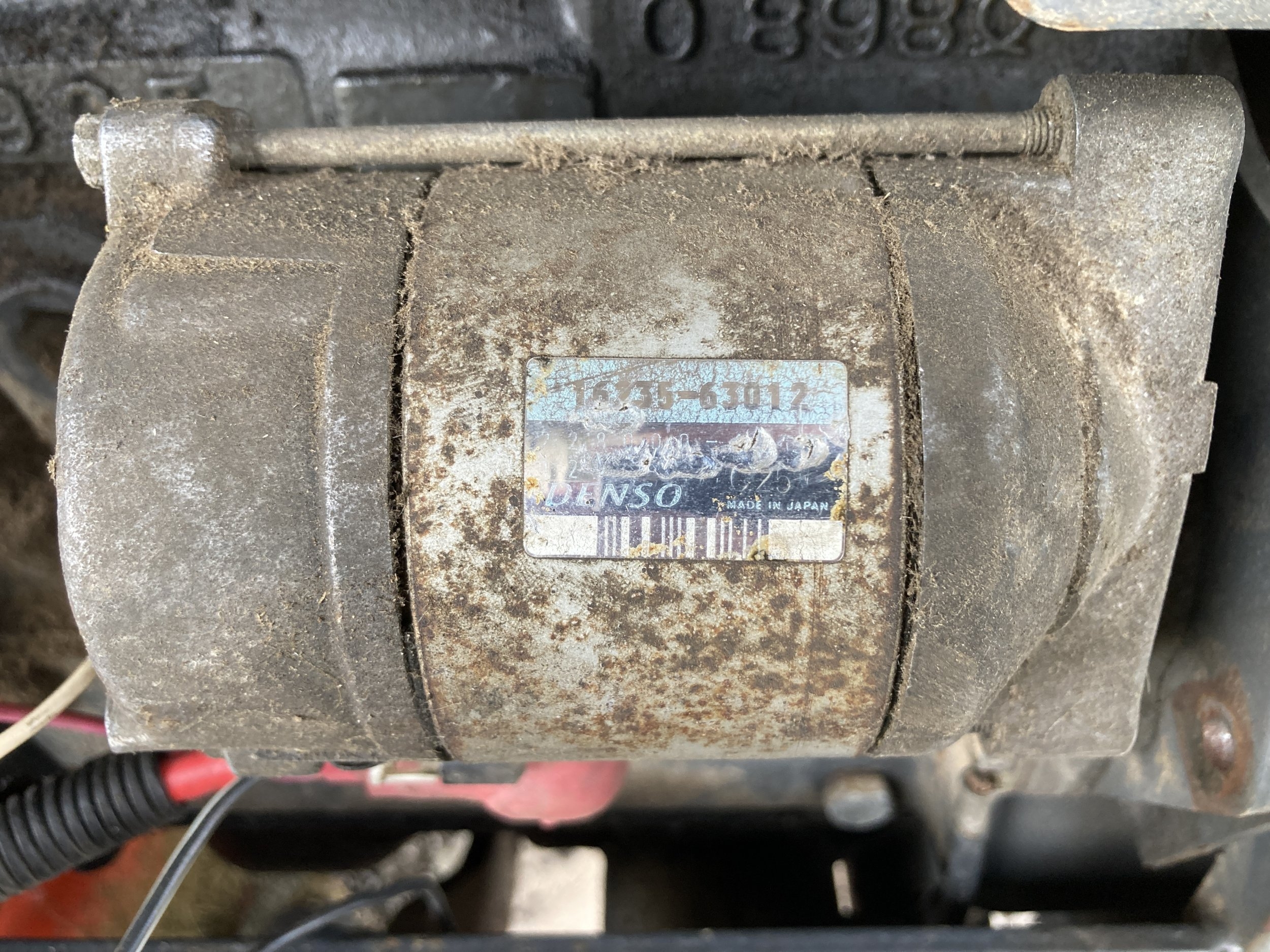

First post - So fingers crossed!
I've an old Kubota BX2200 D - Its always been a little temperamental starting. Takes a good few go's before things turn over. I serviced last year cleaned starter motor & new battery. Everything seemed peachy and motor would start almost immediately.
This year all good - until suddenly it wont start. Varies from 1) all dash lights come on ignition, glow plug warming....clicking...but no start. 2) ignition lights, but no glow light and no clicking from starter motor (pinion doesn't pop out) or 3) Dead.....tried jump starting and nothing.
Installed a new ignition switch (waste of money) and that didn't make a difference. BUT! today I used jump leads from battery to starter motor directly (normal leads connected) and bingo - starts like a dream. So I've come to the conclusion that something is dud between battery & starter motor - and its not the ignition switch.
Is there a starter relay on the OLD Kubota's (there are no safety switches as I can start with PTO , Seat, etc. etc. ). Could it be a bad earth? HELP welcome and starter motor/engine details are in photos.
And....I am learning...no idea where the starter relay would be (or what it looks like)

   / BX2200 Starter Issue #15
Tell us more about how you connected the jumper wires... did you also connect a (-) wire? Or just the positive?
I'm thinking starter solenoid or the lead from the battery to the block.
   / BX2200 Starter Issue #16
Hey - I tried first just negative jumper cable. (Id read bits around the grounding) with tractor positive connected - Nothing
When I put both jumpers from battery to starter motor (black on the body of starter motor, red to positive connect point). Turned the key and started straight away.
Made me think the starter was OK, but by using both jumpers I'm skipping something that is faulty in the connection. (I dont have any electrical test gear)
Thanks for the reply
