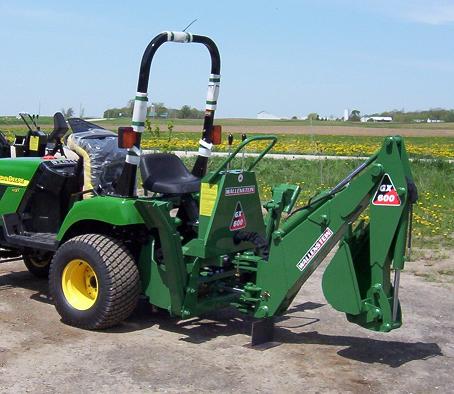

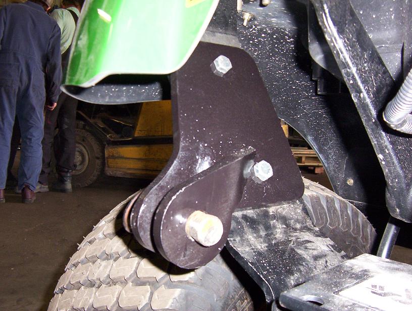

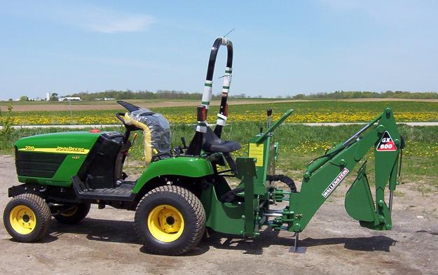

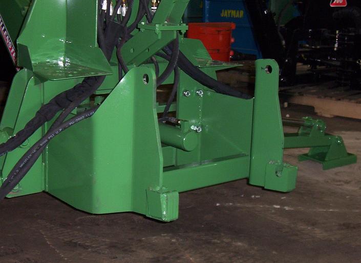

Yes it is a subframe "type" mount, it's a four point mount. See attached pics.

   / BX2200 w/ a Backhoe! Why not??... #12
more

   / BX2200 w/ a Backhoe! Why not??... #13
another

   / BX2200 w/ a Backhoe! Why not??... #14
Last one

jrlichina,
One of those photos was of the tractor without the bh attached. but it was a closeup of one attachment point. The next time you have the bh off, I'd sure appreciate a photo from a little further back so I can see how much hardware stays bolted onto the tractor while the bh is off. Does the subframe lower your ground clearance or get in the way of other 3ph implements while trying to attach them?
Did this bh come with your tractor new or did you buy it later? How much was just the bh?
Thanks for your feedback. I appreciate it.
   / BX2200 w/ a Backhoe! Why not??... #16
These are pics Wallenstien sent me when they were developing the mounting system for the JD, I don't have one. The upper mounts take hitch pins and the lower part of the backhoe mounts to a replacement bar that holds on the lower lift arms. Their system does not add any additional bracing or hardware other than the upper mounts so ground clearance is not diminished.
