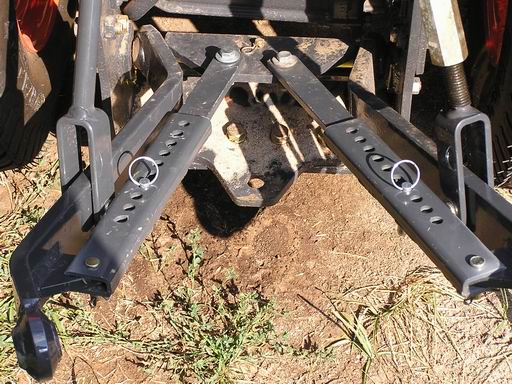

Search in the Bota forums for stabilizer bars. As I recall, it was about $70. I ordered through tractor smart.
Links here describe in detail how to mod them to fit. It requires that you cut about one inch out of one side of each tube, to allow the arm to fit.
You can use some of the pins from your original setup to attach. I bought some ball detent 3/8" pins for the adjustment holes. Works slick.
Attached is a pic of mine.
Ron

Hey Danny,
Now you'll have the neatest setup any of us have come up with when you get the stabilizers installed, I got those before I got the quick hitch. When you get them installed, you can sell the spreader bar on E-Bay. /forums/images/graemlins/grin.gif here's a pic of the stabilizers when i first installed them

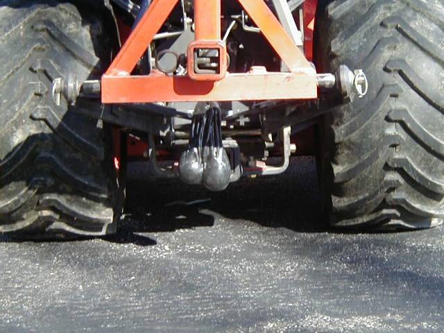

Re: BX2230 and the Pat\'s Easy Change System
Don't be suprised if you go out some morning and find that your bx has these.

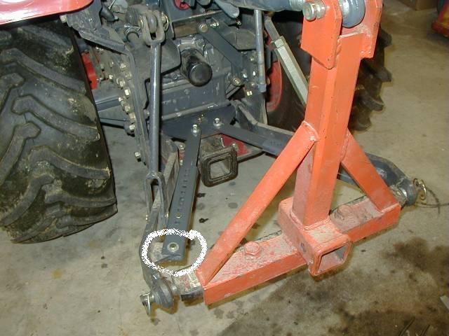

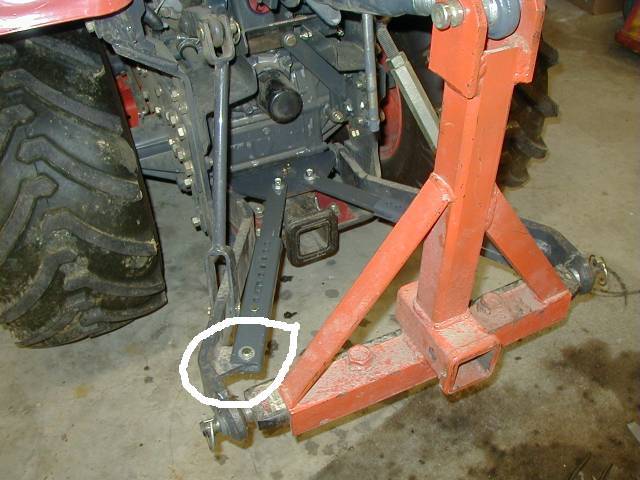

Danny,
The only thing that isn't just bolt on, is the end of the tube section, see circle on attachment. I put the tube in a vise and used a small angle grinder to cut the slot in the side of the tube, don't slot the wrong end of the tube like I did on one of them.
