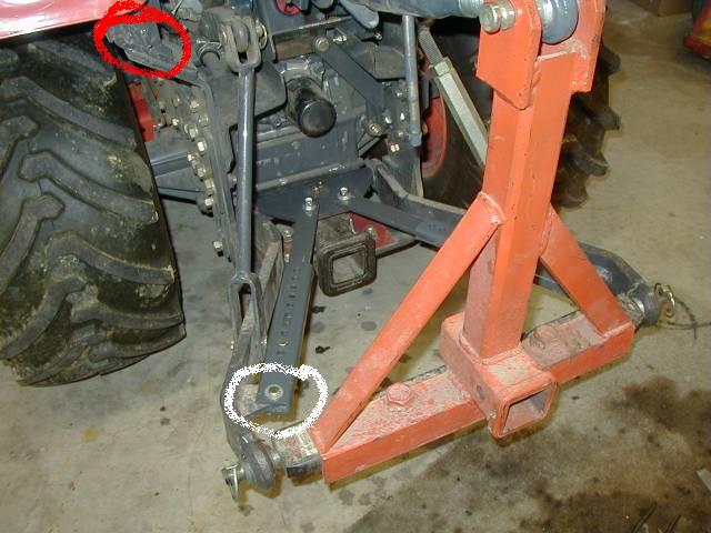

Danny,
The tabs to hold your lift arms are circled in red in case you haven't located them yet. I have more pics of the stabilizers if you need them.

I've not tried this, but I think instead of undoing the lift arms to attach them to fixed points while you mowed, (and if I needed to keep the arms up), I'd try running a bungee cord or two between the two attach points, and under the arms. That would be a lot faster than undoing the link arms. Or even use a light chain or rope.
Now this would only work if you didn't have anything mounted on the 3 pt...................
Am I missing something?
Ron
   / BX2230 and the Pat's Easy Change System #33
Re: BX2230 and the Pat\'s Easy Change System
Im not for sure but i think if you chain them up without unhooking them your mowing deck will not go down /forums/images/graemlins/confused.gif
   / BX2230 and the Pat's Easy Change System #34
Exactly, or more correctly it will go down but will be uneven, as at some point in the travel, these two items work together....... /forums/images/graemlins/ooo.gif
That was what I was posting about. I tried to tie them up, then the deck was unlevel at the cut position.
Taking them loose and hanging them on the hooks is the reason they are there. This gets them high enough and lets the actual lifters work with the deck
   / BX2230 and the Pat's Easy Change System #35
Ah, thank you for the enlightenment!
ron
   / BX2230 and the Pat's Easy Change System #36

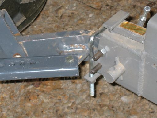

Thanks, I found the tabs, now I know what they are for. I got the bars today, will be putting them on tomorrow after my trip to a local auction that has some interesting items in the implement line. Your photos of the arms were very helpful. Now I know how to do that too!
   / BX2230 and the Pat's Easy Change System #37

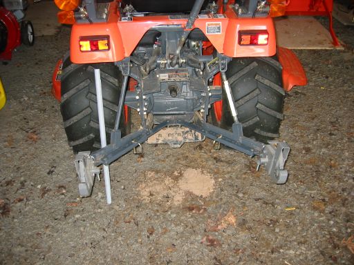

Hey guys and gals
Here are the new links on the Bota, with the Pat's system to boot, and set up to MOW!
ok, could not resist!

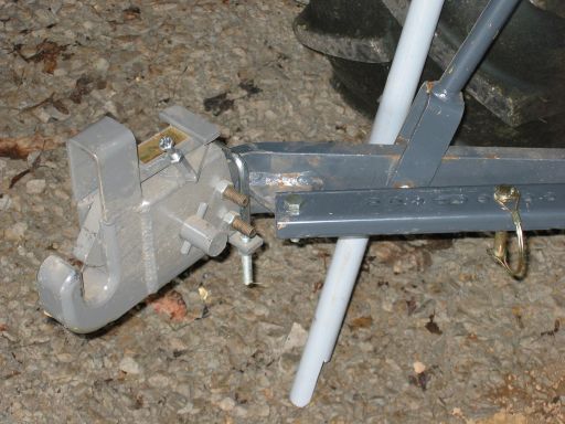

   / BX2230 and the Pat's Easy Change System #38
Another view of them with the Pat's hitch in place
Now if it would just quit raining on my parade and let me play

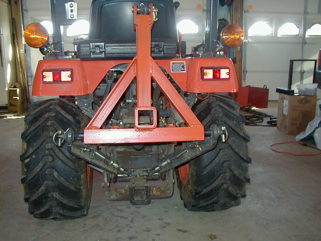

   / BX2230 and the Pat's Easy Change System #40
Super job Danny, I noticed that your tires are different than the ones I have, yours must be a newer machine, mine was 06/01
