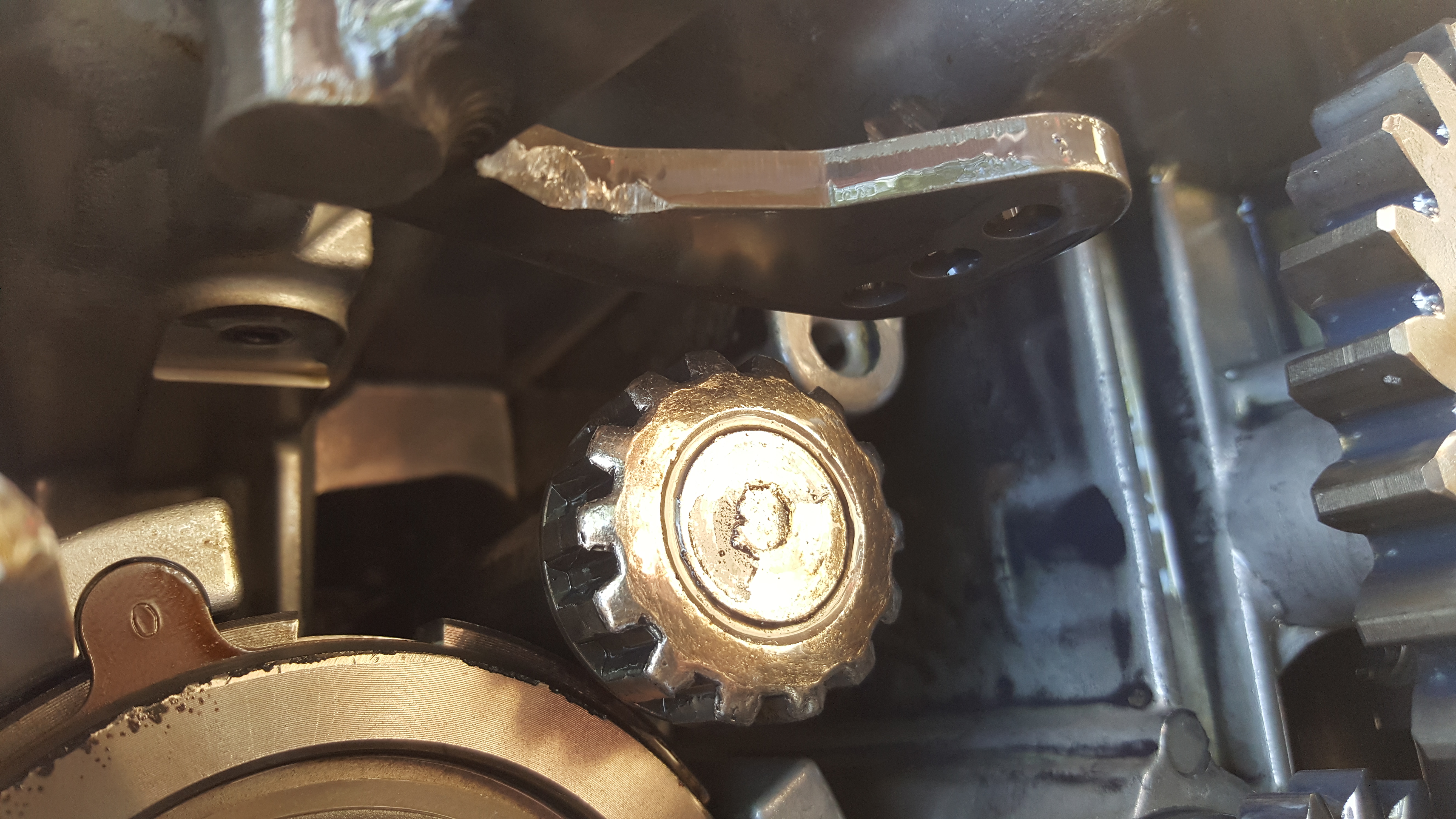

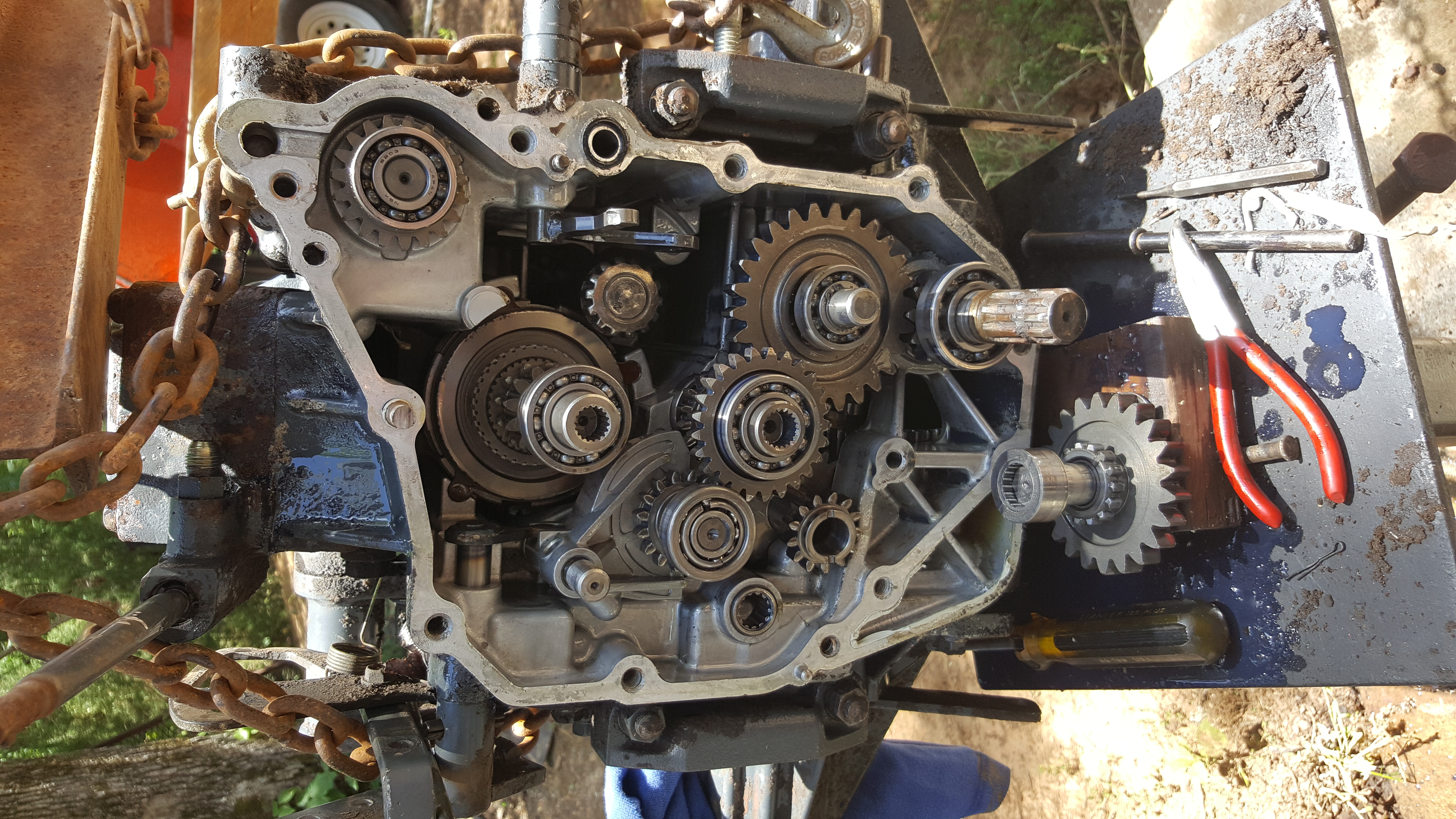

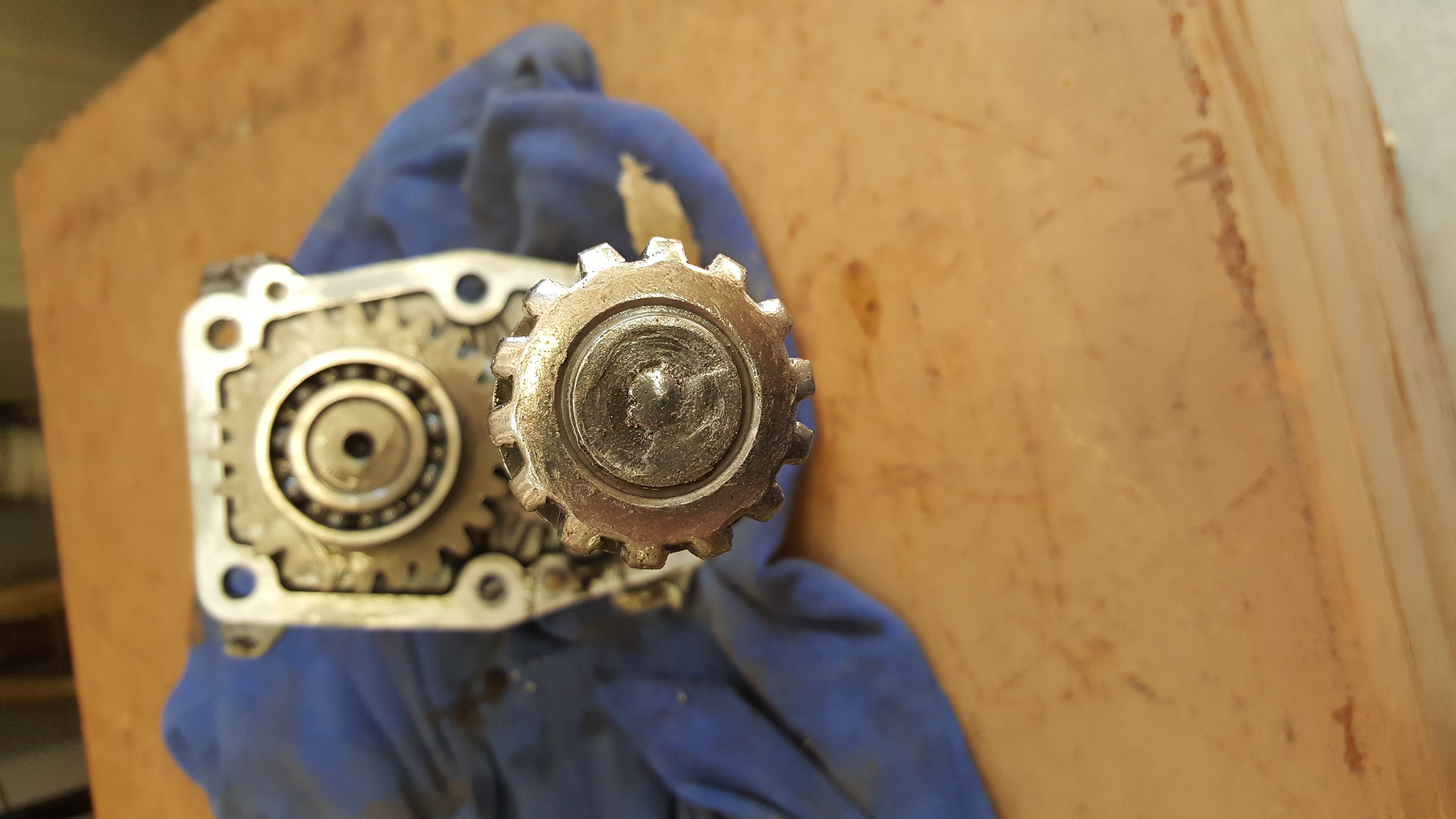

Just a few pictures to show the broke shaft I wonder what he hit!
   / BX2230 PTO not working #12
I finally got some time off of work to work on the little tractor, got the transmission out and cleaned up and Dad came up for a visit at 76 years young he still likes working in the shop so we tore into the transmission and found three gears with bad teeth and a broken shaft, four bearing with some rough spots while rolling them so I ordered the parts to put it back together and now I am waiting on the time and parts.

some times I read where people don't follow up and report on a project so let me put some more information out about my little project. My dad and I got the transmission back together and a few days after he went home I was able to put the transmission back in the tractor, got it all back together and it works great. Took it over and cut my father-in-laws grass to help him and check the mower out. decided it needed a new belt it already had new blades, so I ordered a new belt and two new ball joints for the front end. when I removed the belt it worn out I believe it could have been the original one. Replaced the belt, the ball joints and both front tires so basically I started at the back and worked my way out the front and I believe my little project mower turned out to be a success. :thumbsup:
