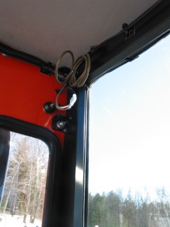

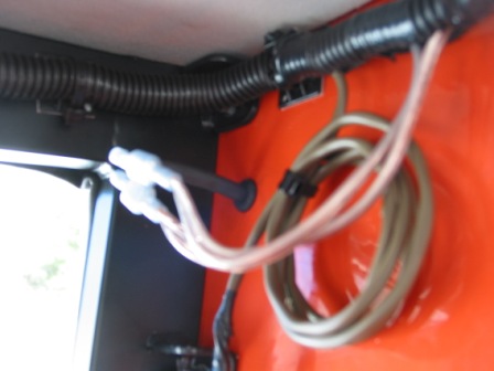

#31
Rear light, speaker wire and the Antenna wire from the console.

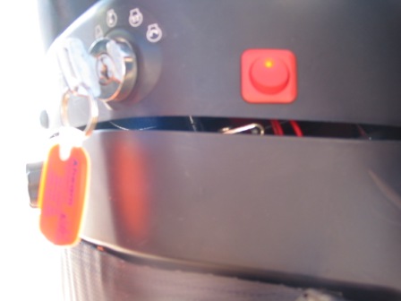

   / BX2230 with Curtis Cab and Snow blower: Let it sno
#33
This red switch that works off the key, activates the 30-amp relay that supplies the power to the console.

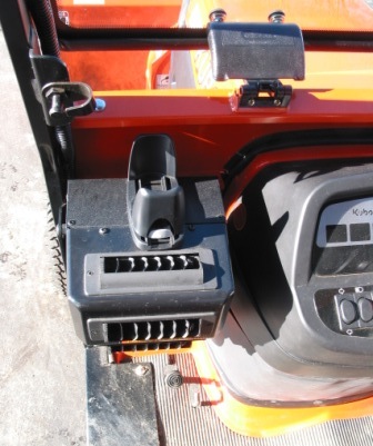

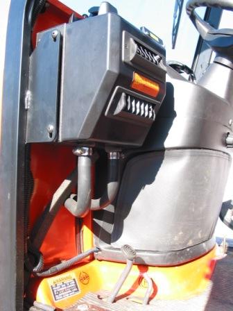

#34
This is the Heater. I must say…this little thing really throws the heat.

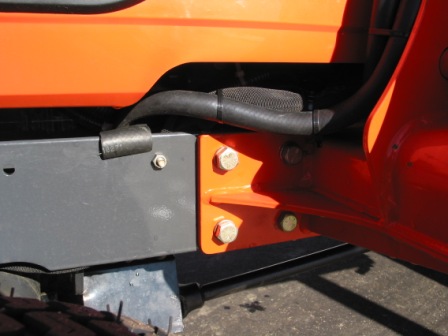

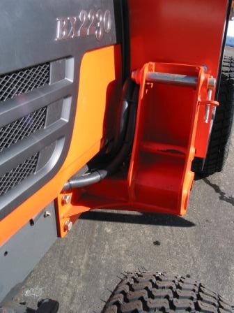

#35
This is how I routed the heater hoses. I wanted to make sure I didn’t pinch them putting the loader on and off.
#36
This is how they route into the engine compartment. Note anywhere where the hose could rub, I cut an extra piece of hose so that it wouldn’t wear.

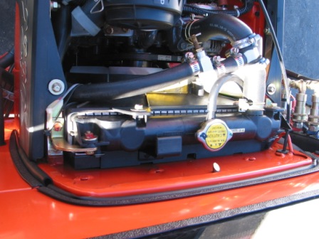

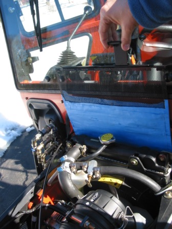

#37
I ran one hose up along side the radiator to the top hose. I spliced in the provided valve that has a shutoff for the summer. Be sure to tywrap the hose away from the radiator fan. Note the valve.
#38
The temperature was not getting warm enough so I covered half the radiator screen with painters masking tape. Works great. The temperature gage runs about ¼ of the way up towards half way. Plenty warm there.

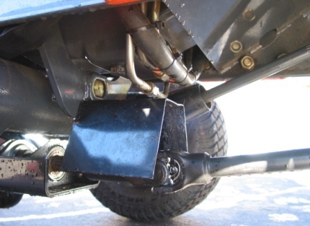

#39
I ran the other hose under the tractor to the bottom radiator hose and made sure it was tywraped up and out of the way. I had a heck of a time bleeding the system through…anyone have any tricks out there for doing this?
