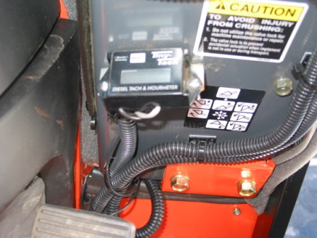

#41
I installed the Tiny Tach on the joystick control. It is right below the throttle and I can see it well.

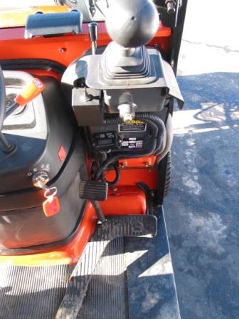

#42
I mounted the Tiny Tach with angle steel to an existing bolt on the tower. I tilted it slightly towards the driver.

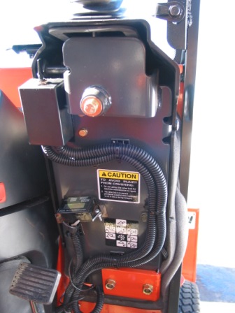

#43
The other wires you see here control my Electric chute rotator. They go to the switch box that contains a single pole double throw switch from Radio Shack.

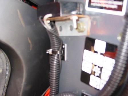

#44
Another look.

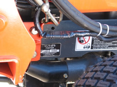

#46
The cabling routes out towards the blower. Below the hydraulic quick disconnects I put a trailer harness assembly.

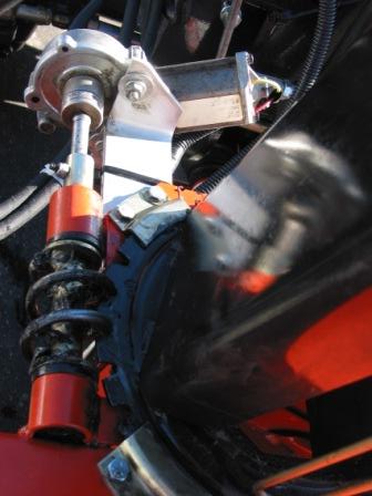

   / BX2230 with Curtis Cab and Snow blower: Let it sno

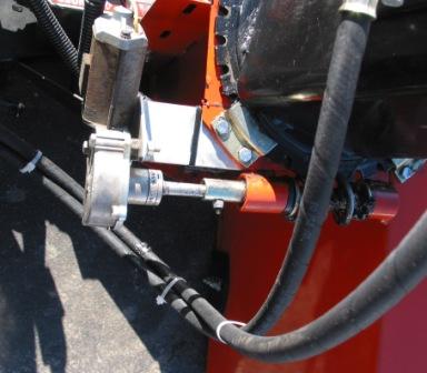

#48
This is a shot of the Electric rotator. I used a 1994 Ford Explorer Electric door motor. Note…when disassembling it from the door, be very careful as it is under spring tension.
#49
I purchased aluminum flat stock from Home Depot. I bent two L pieces in the vice, did a little grinding to fit it under the chute and then drilled holes to match the ones that were currently on the chute bracket and bolted it on. I then matched up two of the three holes on the motor and bolted it on. I found that an old warn out S&K 7/8 sockets fits on the spline. I then took an old 3/8 extension from my socket set cut it to fit and added it to my assembly. I drilled the hole through it and inserted the stock sheer bolt. The assembly works fantastic. The wiring took longer than fabricating this setup. All in all…a 3 hour project. Not including the running around. This is how a person with limited tooling capability gets around situations.
#50
Different view. Note, I ground the flat stock sticking up on an angle so there were no sharp edges. The angle flows with the motor and looks better as well.
