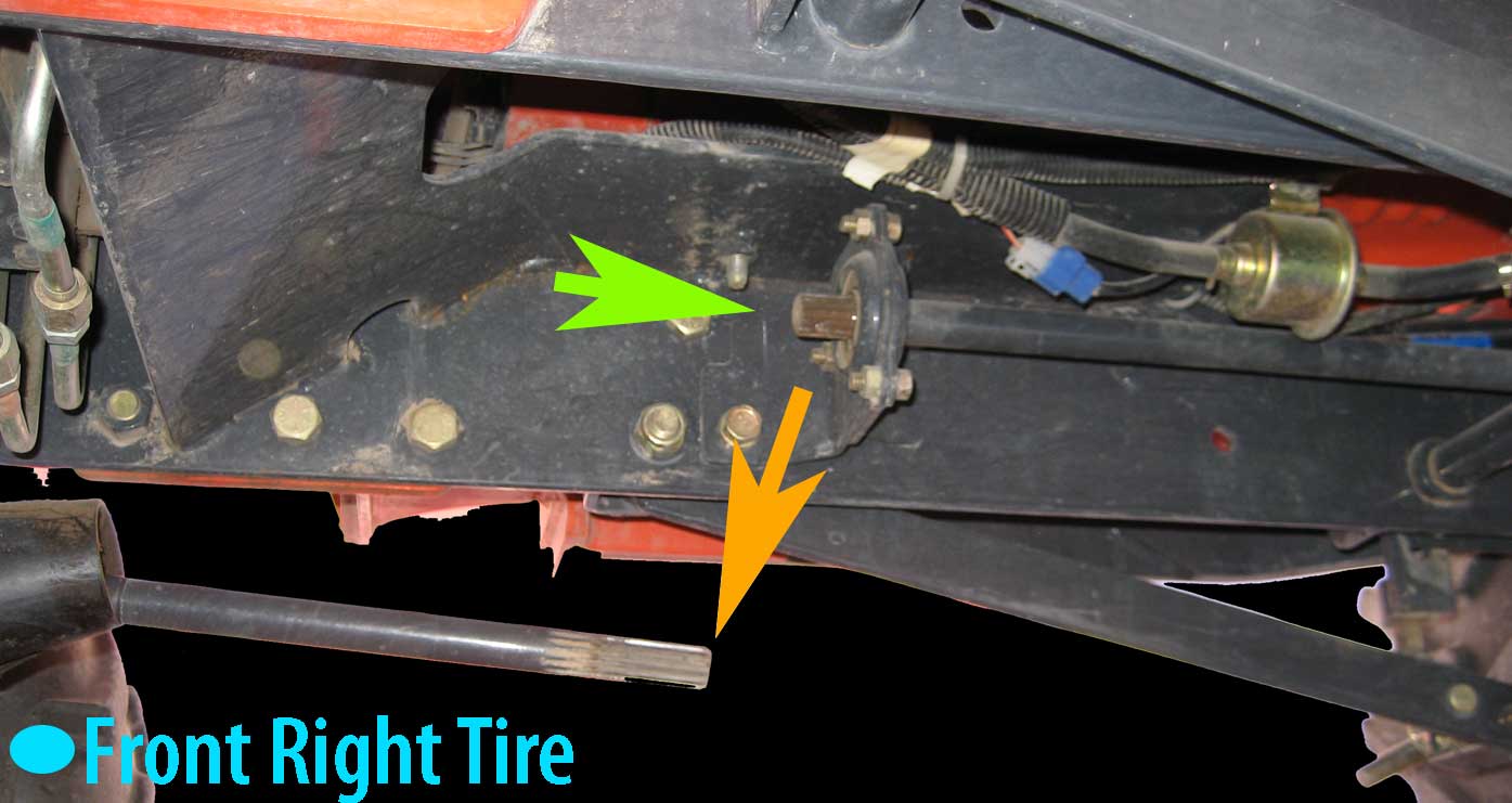

The new picture look so much more clear. Definiately the u joint is missing, and I second conur the comment about rust on the shaft on one end. Hopefully you can order a new joint and install.

You are missing the rear most universal joint it is pinned to the shaft closest to the transmission and slides in and out as the front axle changes position.
It looks like item #160 part #K2561-16820 for the universal and o5411-00650 for the pin that holds it on.
tom
Tom is exactly right with his prognosis and parts numbers. I have a BX23 that had the same thing happen. The roll pin will shear off and the U-joint and yoke assembly will fall to the ground. I obtained the parts Tom listed from my local Kubota Dealer and replaced them in only a few minutes. The U-joint and yoke assembly cost $72.36 and the roll pin was $.96 out here in California. Its a very straight foreward repair that you should be able to handle with a little mechanical ability.

Hi all,
I own a little BX23 which I loan to one and all. I am a single woman and I've found that the more helpful a person is, the more help you get in return.
I loaned my BX23 to a neighbor and never noticed that the 4x4 train was damaged until I went to use the tractor yesterday. I'm not mad, I just need some good advice from the knowledgeable folks on this forum.
I have read this forum for years and I know that I need to purchase a repair manual if I'm going to try to fix this myself. I believe the best place is SSB Tractor ($79.95 for the Service Manual).
Does anyone have any knowledge about this kind of repair that they can pass along? I am not afraid to try this myself, but I know there are people with lots of experience that might keep me from making a mess of this.
Thanks in advance for any help you can pass along. I've attached pictures to this post so you can see what I'm talking about. The damaged part is the part that is hanging down - unattached to anything - on the right in each photo.
- Grace
UPDATE:
Per everyone's help I've attached a better photo. With your help I was also able to better identify the missing parts.

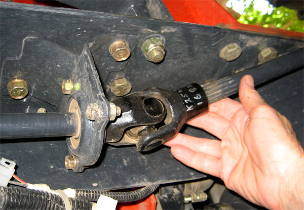

FINAL UPDATE - IT IS FIXED :)
About two weeks ago I came to this forum asking for help.
I did not know the right terminology, much less how to detail my problem. I did the best I could and posted my question and included a photograph of what was broken.
In less than 4 hours I had 5 replies - all of which were helpful.
I ended up with more than I ever imagined. One reader in particular (tommu56) knew that I would never get anything fixed without knowing the parts and installation sequence. He carefully guided me along until I could get the part.
This weekend I installed a new universal joint is on my 4x4 driveshaft and my BX23 is back in business. Thanks to everyone.
