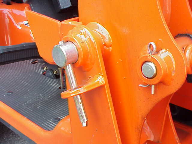

redesign of the loader pin.... Would be an easy "upgrade" to the earlier BX loaders if you were so inclined to do it.

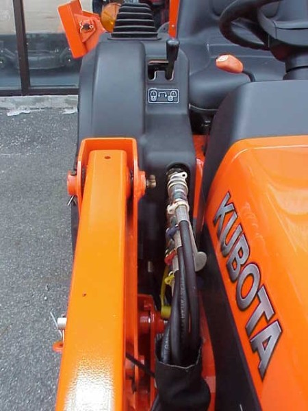

Here is how they now mount the hydraulic loader control to the machine. I have studied this design and believe that it might be possible to incorporate the old loader control into a similar design change for the earlier BX models. I am still working on the possibility of making this modification.

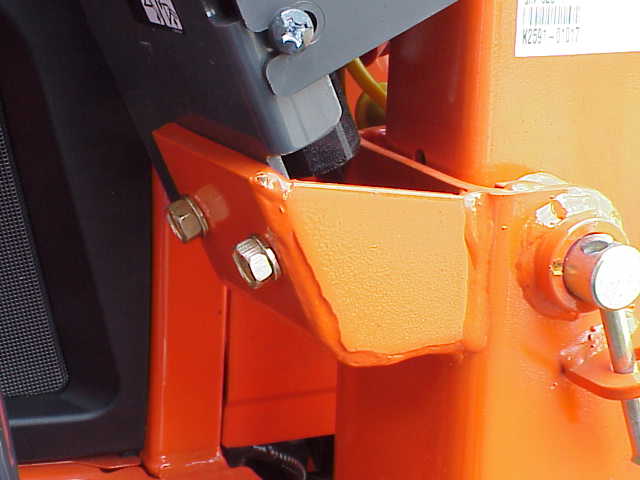

This is what it looks like from the top side... You will note that the right loader tower is now the same as the left tower on the earlier BX machines. If you were to make this modification, I am not certain if the old tower might have to be reworked or the tower replaced with the thinner design as used on the newer BX's....
