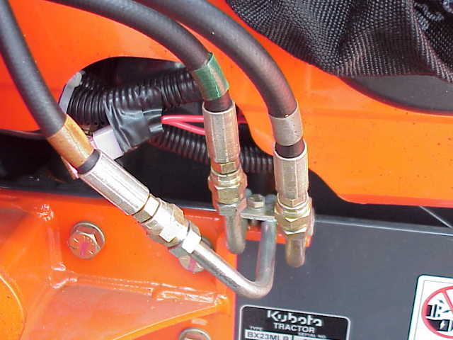

I was at the Kubota dealer last week and I was looking the BX23 over closely to see what changes there were between my late production BX22 and the new BX23. I did notice a switch on the seat where my BX22 has none. I don't know what functions the seat switch works with, but there is no question in my mind that it was designed to do something if you got off the seat. There might be an interlock between the switch and the hydro speed selector, but I was unable to discern this from a casual observation of the machine. The only other changes that I saw were the loader control valve and the way that the loader pins were retained. The new design for the loader pins is identical in design as the pin that holds the backhoe boom on the BX22. The other changes were cosmetic and were of no consequence in my opinion. There was a fuse located on the front right side of the engine where the hydraulic hoses mount, but I have no idea as to what that fuse is for. Would need a BX23 owners manual to determine that. (See Picture). With the exception of my loader control, I prefer the BX22 to the BX23...... Oh.. almost forgot.... the seat is now a high back..... didn't seem any more comfortable to me, but that might just be a personal choice. Would have to park my rear in it for more than a few moments to really tell. /forums/images/graemlins/grin.gif /forums/images/graemlins/grin.gif /forums/images/graemlins/grin.gif
