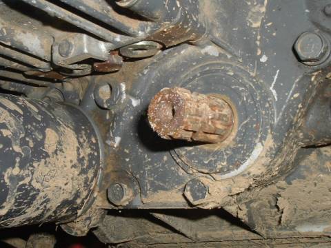

   / BX23 Mid-PTO Cap/Cover #16
I ran around without the skidplate and now you can tell it really needs a cover.

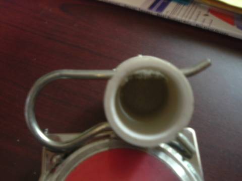

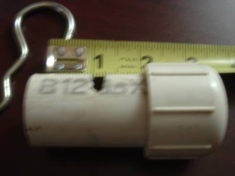

   / BX23 Mid-PTO Cap/Cover #17
I took a piece of 1" PVC, needs to be at least 2" long, I cut it 3" so I'd have more to hold onto, and capped the end, cut a slot 1 1/8" back from the open end.

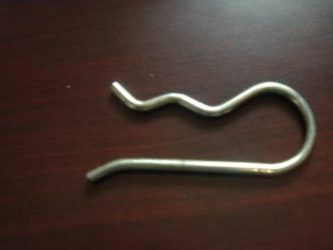

   / BX23 Mid-PTO Cap/Cover #19
The part of the hairpin clip that you can see inside the cover, fits in the grove around the PTO shaft.

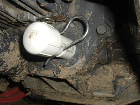

   / BX23 Mid-PTO Cap/Cover #20
Leave the clip on the cover and stick the end over the PTO and smack it with your hand and it slips right on and locks. To remove, lift the straight end of the clip with your thumb and it pulls off. Aren't I a jeanius /forums/images/graemlins/grin.gif
