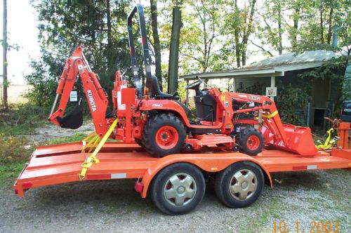

I have been lifting 500 Lbs with my BX-22, and I have hooks on order from JC whitney that will be here in a couple of days that I will be adding onto the FEL.
As far as trailers, I bought a used one for $800. See attached photo.

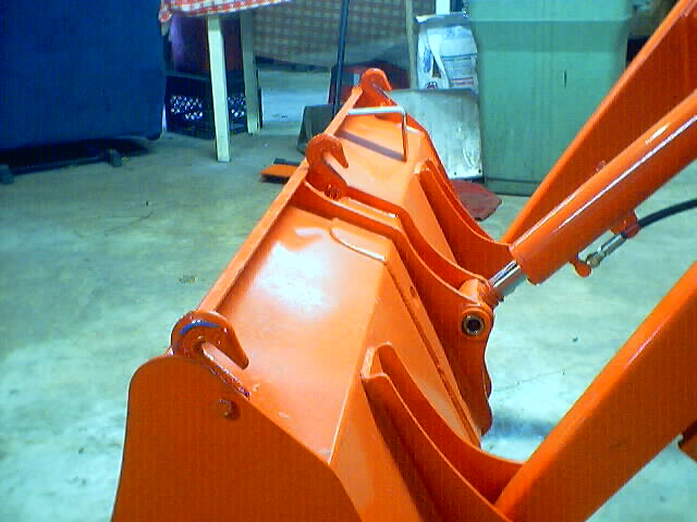

This is not a bx-23, but it's a good photo of hooks on the FEL that someone else posted. Sorry I did not keep track of his name.

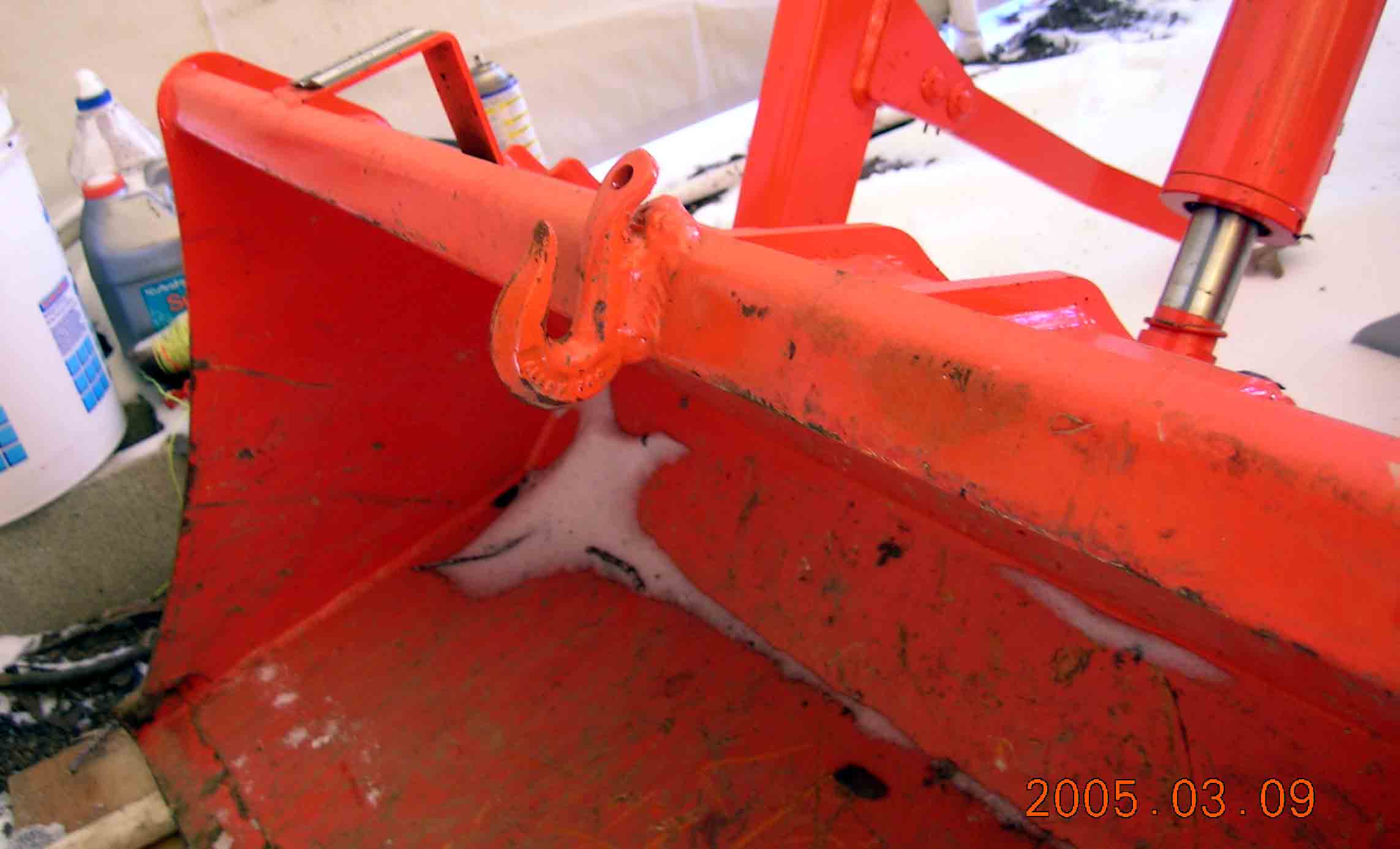

Congrats on the BX23. Here's a closer pic of the hook welded on. I only have 1 in the middle, which works fine for me, but many weld on 3. I have 91 hrs on my BX23 and am very happy with it.

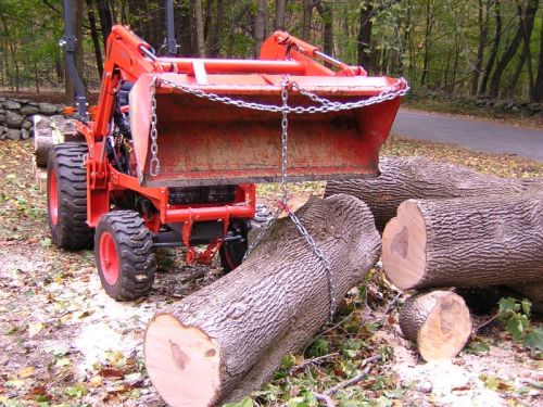

The hooks are std chain hooks with a eye hole for mounting. I bolted the two outside hooks to the side flange of the bucket that extends up past the top lip. The middle hook is bolted to the top via a chain link clamp. It uses a U bolt to secure, in this case the hook eyelet, to the clamp frame & the bucket.
I could have gone more elaborate in this fabrication but I find this works out very well. I'll estimate I've lifted at least 300lbs on several occasions with this setup without any problems or worries.
