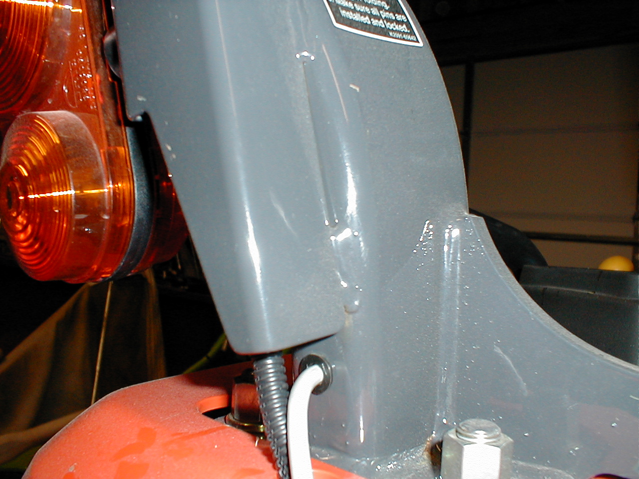

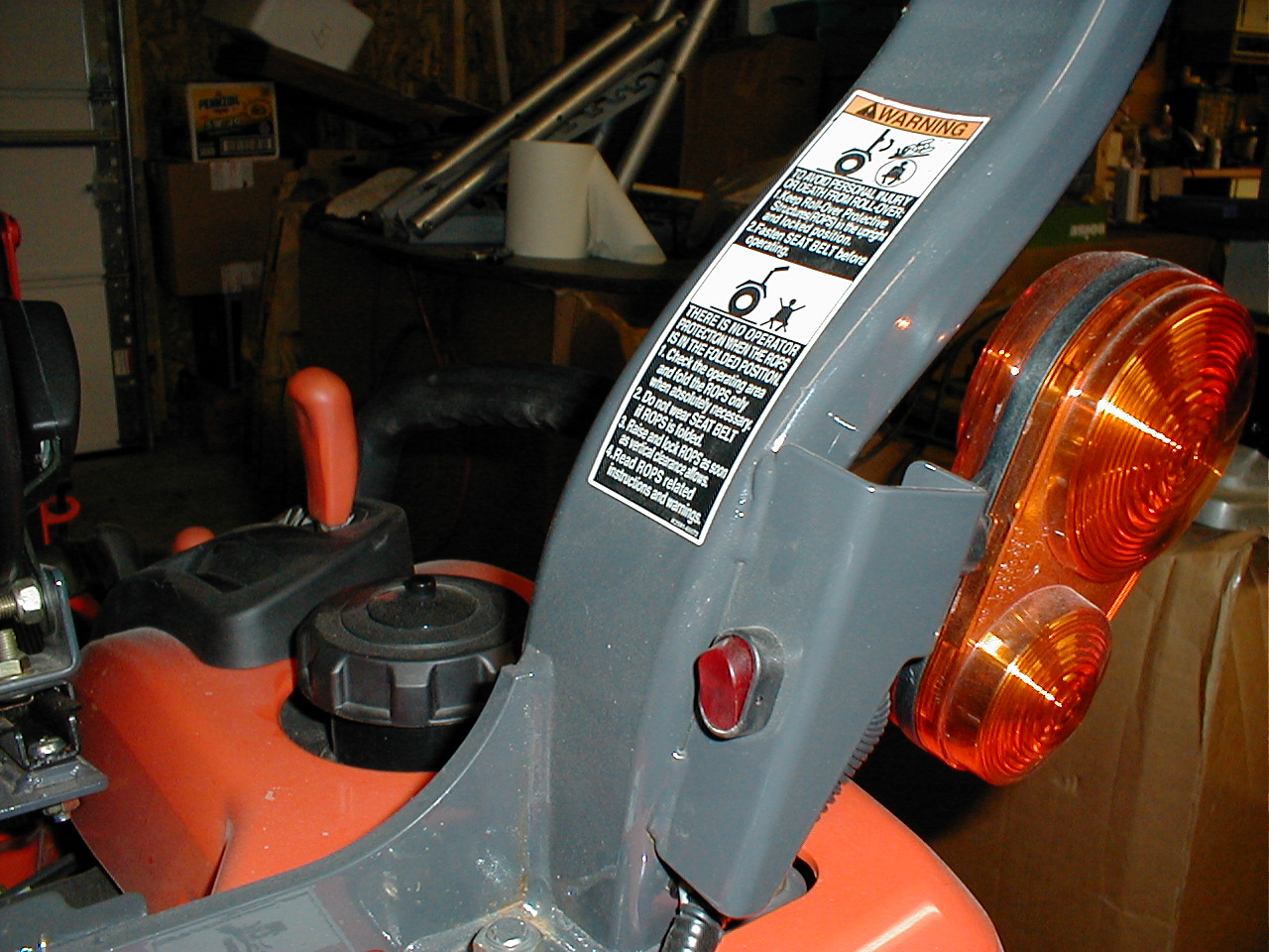

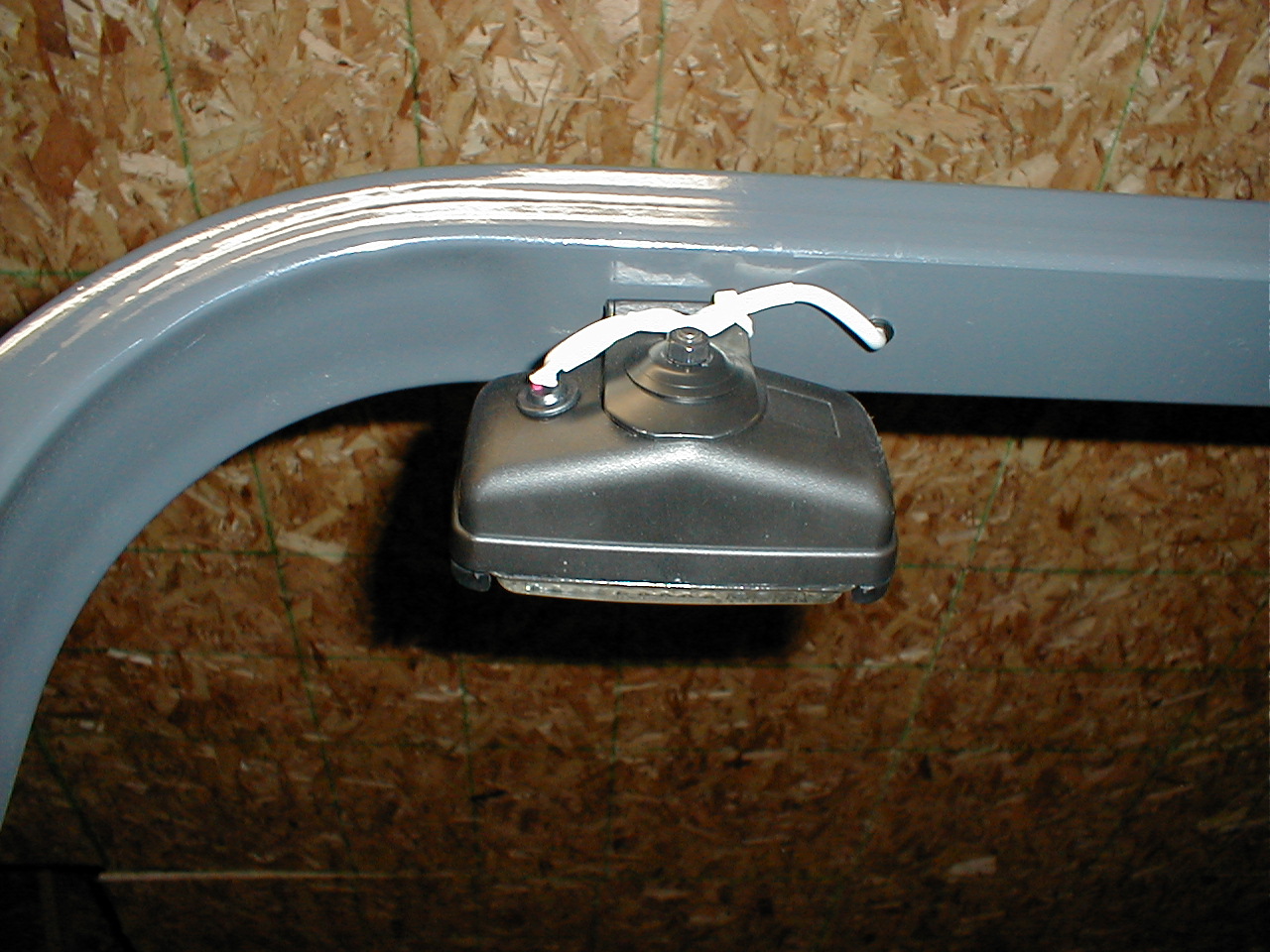

Here is an option to consider, a bit more detail work but secure, sealed, and out of the way. I purchased the 75w trapazoid halagon lights from TSC, the rocker switch from Walmart, and used other misc. grommets and wire from my local stash. Mine are mounted forward becuase I want them more suited for my FEL. If I want light to the rear I can easily rotate one or both around with the spare length of wire secured from the ROPS.
I drilled six holes, four for the wire entry points into the tubular ROPS and two for the mounting of the lamp bases. I also drilled one 1/2" hole for the rocker switch. I looped the wire inside the tubing at the pivot point to avoid wire pinching. I have not had a wire exposed or pinched, since my garage height is too low and I have to drop the ROPS each time in and out of the garage. The switch is mounted on the bracket where the flasher is mounts and is completely protected. I also used the existing wire shield to route the wires to the switch.
Lights are secure and have no vibration and provide excellent viewing of the FEL, no glare, and light spans over the top of the FEL when down while the front headlights provide forward light with the FEL in the up position.

JEW - Nice job on the wiring. Looks very nice. Do you have any pictures of the whole tractor to see how the lights look?
Chris
   / BX2350 Lights on Rops - FEL work at night #17
I like it... So, JEW, as I understand it... there is a loop in the wire inside the ROPS to hopefully prevent it from getting crunched when raised or lowered... humm, my plans might be a changin... ;)
