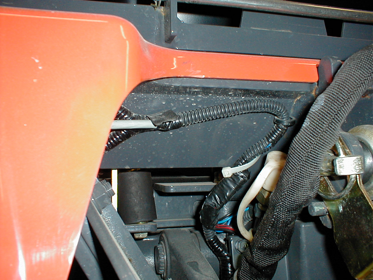

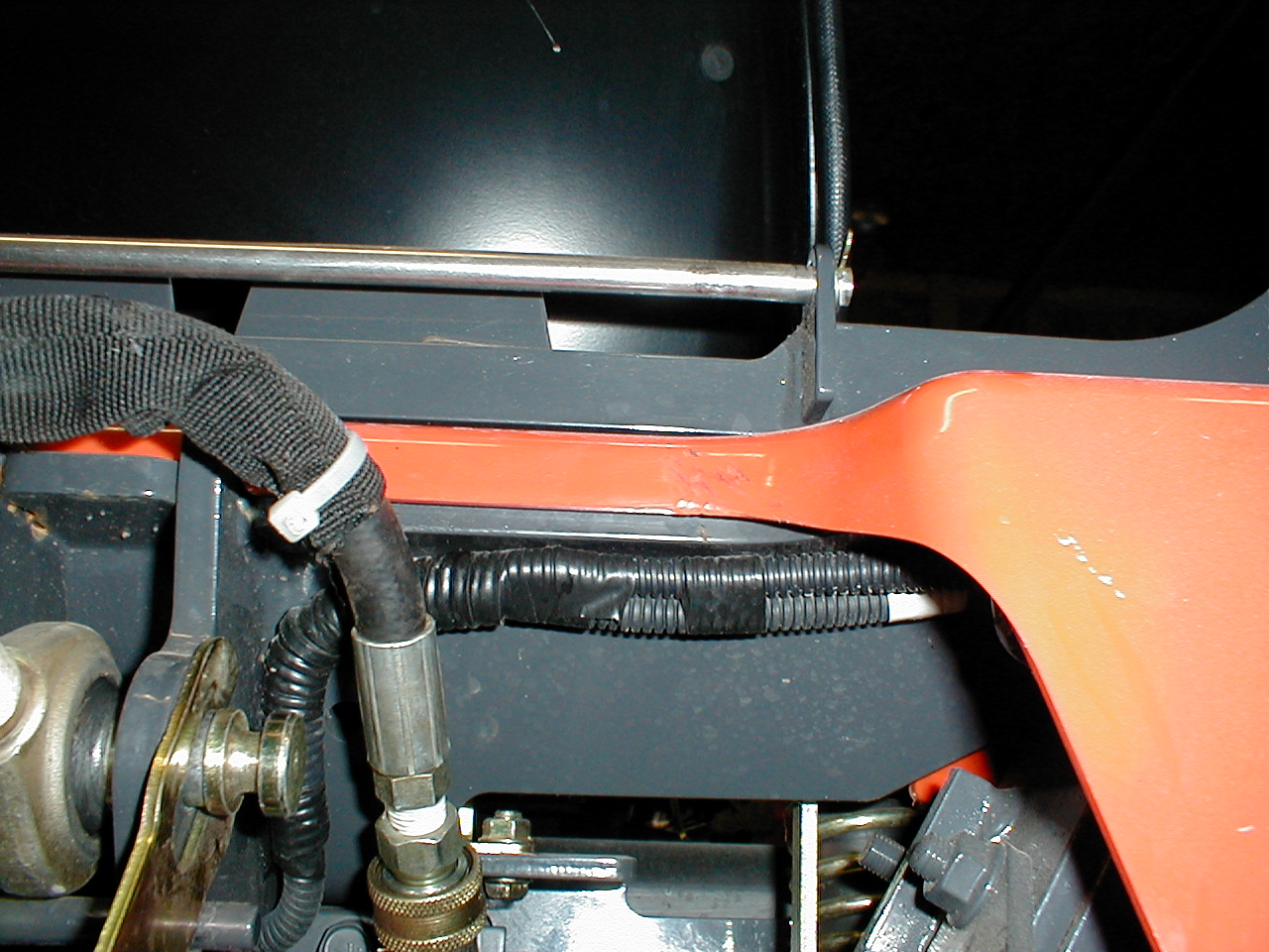

I like it... So, JEW, as I understand it... there is a loop in the wire inside the ROPS to hopefully prevent it from getting crunched when raised or lowered... humm, my plans might be a changin... ;)
Here are some additional pictures of how the light pattern projects from the ROPS. When I've used my BX at night I have a very good pattern and peripheral light for seeing around you as well. The illumination is good because the lights shine from above your head.
To assemble the ROPS with the insulated wire inside the tubing, with the ROPS unassembled at the pivot point, I inserted a loop of wire into the base (where it attached to the frame), and then pushed a loop back into the upper section of the tubing around the pivot bolt and then fished the line down the base and out the hole that I drilled. The key is to have enough slack and allow the wire to rest around the bolt so when the ROPS pivots the wire does not get pinched.
As you can also see the wires are totally contained within the existing cable run. The connection is located just behind the auxillary hrdraulic connector for the BH. The wires at the switch have heat shrink tubing around them to waterproof them as well as protect them from any stray fingers from touching bare wires, even though it is only 12vdc.
