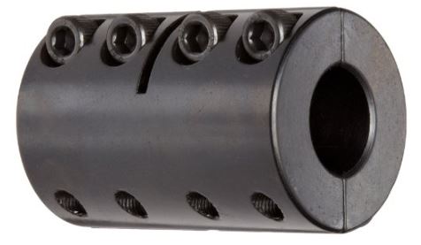

So have a BX2360 here. Broken HST Fan which is not that unusual.
I drilled a 1.5" hole above the fan to easily access the bolt that hold the rear coupling on the tranny side. That allowed me to remove the bolt in under 5 minutes easy as pie. I installed a metal cover which friction fits the hole perfectly.
Going to slide the engine forward with a hoist I borrowed from a friend. Would prefer not to buy yet another 150+ pound chunk of metal for a one or two time time use if this happens again.
I saw in another thread here or on orangetractor that someone suggested possibly cutting the shaft when it was off and fitting it with a rigid two piece coupling. Idea is that in the future if the fan should be hit again the coupling can be removed and the rear portion of the shaft easily removed without messing with the engine side at all.
Looking at the specifications for the coupling at Mcmaster for the following part:
McMaster-Carr
Image of the coupling:
I measured the shaft as 20mm.
Specifications from the site:
Material: Steel
For Shaft Diameter: 20mm ï¾— 20mm
Overall Length: 65mm
OD: 42mm
Maximum Speed: 4,000 rpm
Maximum Torque: 3,095 in.-lbs.
For Shaft Type: Round ï¾— Round
For Shaft Misalignment Type: None
For Motion Type: Forward/Reverse, Start/Stop, Continuous
When I looked into the details of the engine torque for the BX2360 I found max torque of 44 foot-pounds which converts to 528 inch-pounds. Since the part is rated at 3095 inch-pounds it should be able to handle the torque fine.
Link to Torque chart for the Kubota D902 engine:
DieselEngineMotor.Com - Kubota Diesel Engine D92
Part is available for $56 plus tax delivered.
So what are your thoughts on this? Are my torque figures wrong? Am I crazy to even think about doing this? Please give me your feedback negative or positive.
Thanks!

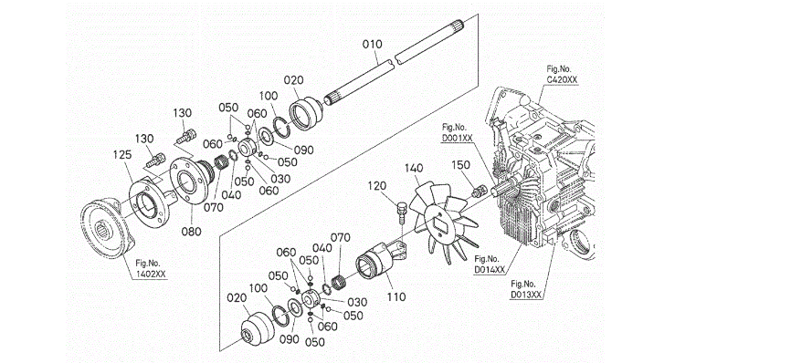

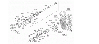

Thanks well thought out reply Ron. I have seen most of your ideas in different posts by different people - many creative ways to address this out there.
Saw one person add external hydraulic cooler for the HST. It involved moving the lines from the filter location to a spot he placed it up by the ROPS. Major work in fabricating the lines etc. Looked beautiful when he finished it and cooled the system much better than the stock fan if I remember correctly. Out of the scope of work I would want to do though.
Squirrel fan I tossed out due to space issues and the other cons you mentioned.
Skid plates - possible cooling issues and not guaranteed since nothing is.
Two piece fan...I saw mention on one forum where a person fabricated a metal fan which I believe was two pieces. Never found the original post - would love to see it since I think there were pictures of it. I believe the fan bolts on from the transmission side - hence can not get to those until the shaft is slid forward. Wonder how that would affect what you are considering. Would love to see this finished if you can get it to work.
For the coupler I was looking at the clearance to separate them in the future...hopefully enough there - will be tight. I figured worse case is I have to spend another $75 for a new shaft if it doesn't work out. Never dealt with couplers - reason I am asking here in the first place. The one I linked uses eight bolts to tighten it down, supposed to have solid tight friction clamping. Appears to be the best one of the various couplers I have found for higher torque and RPM ratings and I trust McMaster to be accurate about those. Not sure how that would be loose when mounted like you mention you have seen in the past. I figured that would be an issue with ones that only used set screws to hold them in place.
