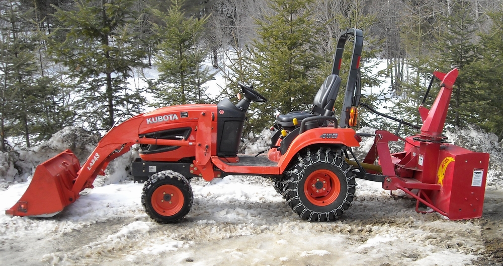

So I plan to get a BX2360, I would like to be able to use it for snow removal in the winter, I live in Canada near Niagara Falls so occasionally in the winter we get heavy lake effect snow. I plan to have a box blade and obviously the loader however our driveway is around 400feet long and I am guessing these are not very efficient for snow removal. Basically what I am wondering is which is the most time efficient implement to remove the snow, and what are the approximate costs of these implements for this tractor. I am going to guess there is no one right answer or they wouldn't make all three but I was just hoping for some input.

My preference is a rear snow blower on my BX2660. With the rear, I still have the full use of the FEL. I paid $2000 for my Meteor 51 inch blower. The Meteor blower is made in Canada.
Click on attached thumbnail to enlarge photo.

The three point hitch snow blower will be much better in your case as it will require less power for the same width of snow blower and will require less work to install and maintain.
Purchasing and having dual remotes on the BX 2360 allows you to operate the snow blower from the cabin with no open windows or doors to control the spout or chute and the dual remotes will allow you to use other implements with ease.
It is no secret that I like the Pronovost line of snow blowers;
The Puma 48,54,64,72, and 74 come standard with hydraulic chute control and the hydraulic spout control is optional and your tractor has plenty of power to operate all of them.
Buying and having rear chains and lquid ballast are tremendous assets for snow blowers dealing with melted snow pack or drifting snows as they will become heavier during the daylight hours if the sun is out or the temperature rises during the day.
Please remember snow fall that is unmelted weighs in at 21 pounds per cubic foot and weighs more as it ages with temperature increases and aditional snowfalls and gravity.
