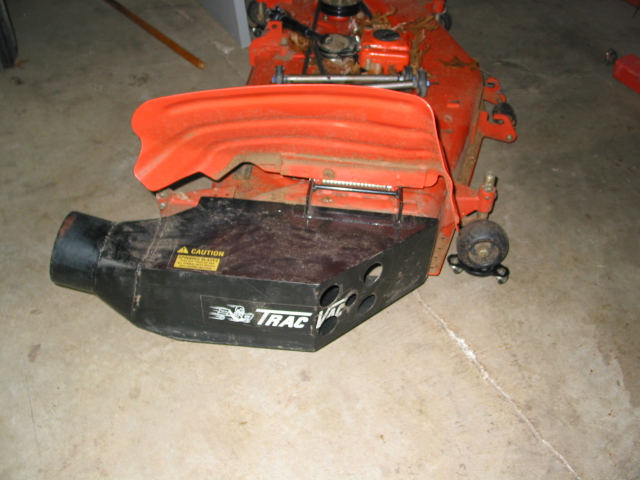

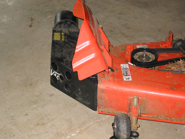

Thanks for braving the cold for the pics. My JD X300 had a similar chute design to yours.

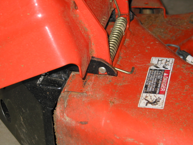

I'm just plain stumped - another 10 minutes working with the thing and I just don't see anyway to leave the grass deflector in place. Taking it off is a bit of a pain, with the spring and all, but if I have to that's what I'll do.

One other thing, I had to grind a little bit off of the front ear for it to fit under the grass deflector. I'll try to find the part number for the correct shaft for you.

Part numbers......... K5651-47160 Pin, discharge
75599-52525 Pin, spring

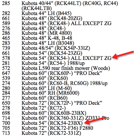

I think I solved the problem, and will confirm it later this morning: the wrong adapter was ordered. Check out the attached image, and see if you concur. The part # that was ordered is at the first arrow, the part # I believe should have been ordered is by the second arrow. The difference being that the second # refers to BX series decks.
The right tool makes the job a lot easier!
And the dealer ordered the correct part # for me this morning...

Both my decks have a pin that looks like what "638" posted, my brother has a BX with a 54" deck and his also has the deflector pin like in "638's" picture, I think your pin is not the original pin that Kubota puts on their deflectors.
