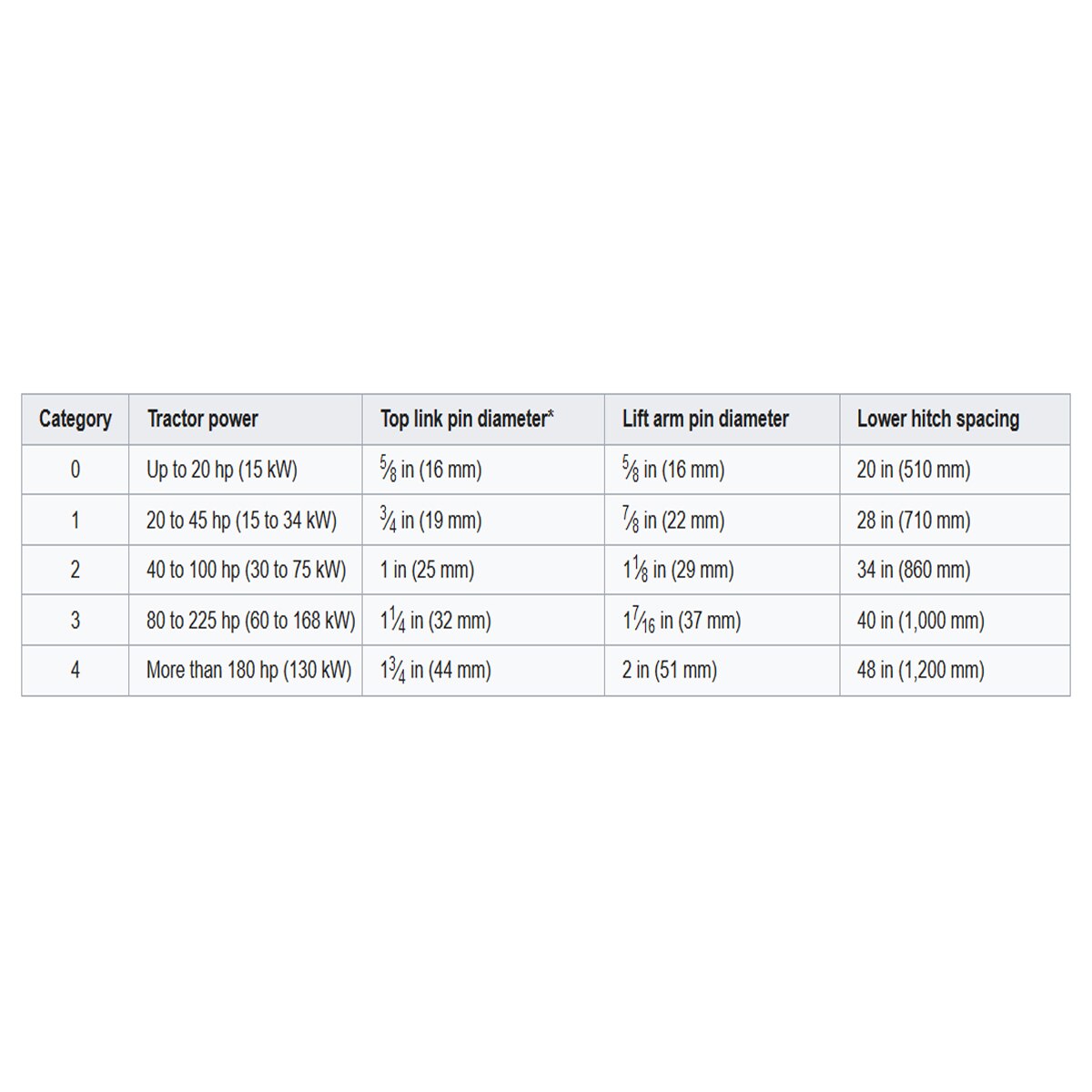

Tractor implements are rated by power.
You're probably looking for Cat 0 or Cat 1 depending on the 3 pt hitch size.
