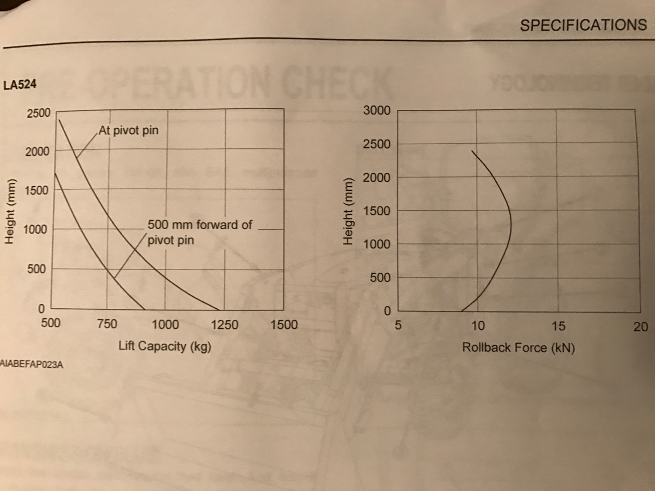

What is the term for lift capacity at "ground level" or something like that?
I think it's a mistake to compare these tractors at max height, since they have different sizes and FELs. The 2650 max height is probably quite a bit higher than the BX, right? A fair comparison would be to consider them all at the same height, in which case the 2650 will look even better. This matters because the lift capacity is weakest at max height and increases as the loader goes down. The 2650 capacity will be higher at an equivalent height to the BX's max.
You really need to consult the lift curve in the owners manual for the FEL to get a feel for this. And realize that most of us use the loaders to lift stuff down low, where the lift capacity is much much greater. If I remember right, the capacity on my L3200 near ground height is more than double the capacity at full height.
My 1,200lbs rated loader on my L3200 would get "1,200lbs" big square bales to 4-5'. Add in the 200+ lbs for the forks & the bales sticking 4' out and it was dealing with 20-30% more than rated capacity. More down low, yes, but not near double.
Here's the curve from my L3200's LA524 loader owner's manual -- you can see the 520kg at max height at pins (which is where the "52" in the loader model number comes from). Follow the curve down to zero height and it's approximately 1200kg, slightly more than double. Again this is at the pins -- the curve will be different depending on whatever is mounted on the loader arms, but for the OP's purposes I was talking about specs and the curves in the owner's manual.

That would be listed as breakout force, the height varies based on the tractor but usually it's a few feet of lift.
Breakout is the "prying force" developed at/near the bucket lip, and not quite the same as the lift capacity at zero height (which would be given at pins or a distance from pins). Normally you see breakout force numbers specific to a particular bucket. It depends on the leverage the bucket develops with the heel of the bucket resting on the ground. There's an ISO spec for this with more details.

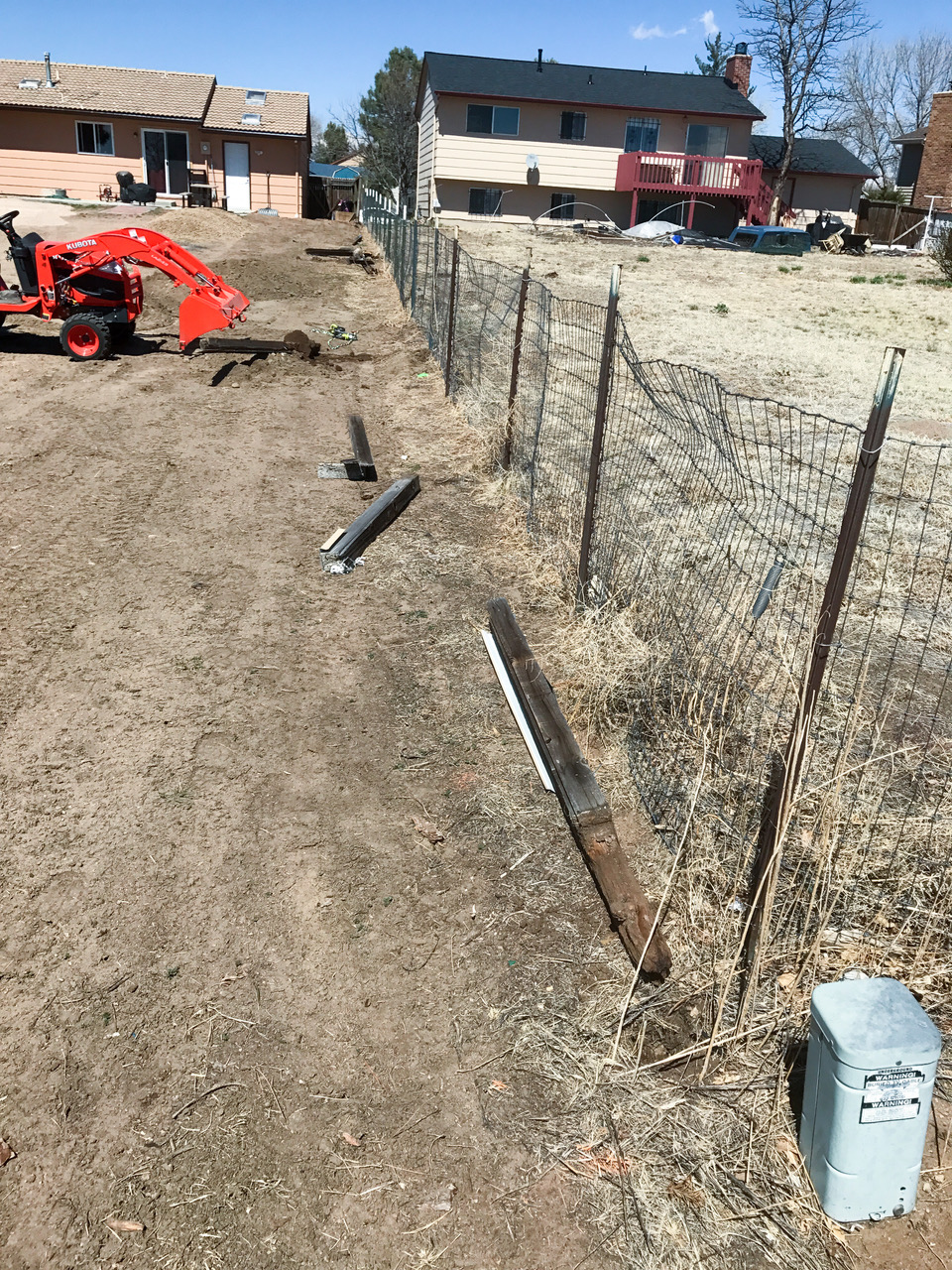

Spent a few hours on the BX2370 today. Yesterday I staged the materials. 6 yards of fill dirt. 2.25 tons of pea gravel, 4.5 tons of 3/4" river rock, 2 yards of garden dirt.
Pulled a few old 4x4 fence posts. BX had no issues will all but 2. Pulled them with a Hi-Lift jack.
