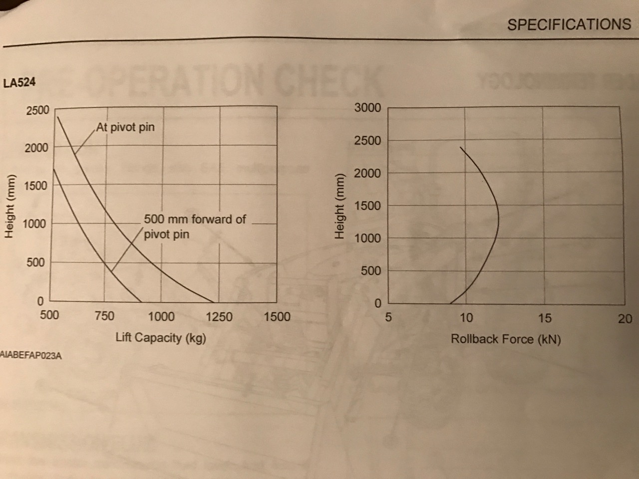

Here's the curve from my L3200's LA524 loader owner's manual -- you can see the 520kg at max height at pins (which is where the "52" in the loader model number comes from). Follow the curve down to zero height and it's approximately 1200kg, slightly more than double. Again this is at the pins -- the curve will be different depending on whatever is mounted on the loader arms, but for the OP's purposes I was talking about specs and the curves in the owner's manual.

That would be listed as breakout force, the height varies based on the tractor but usually it's a few feet of lift.
Breakout is the "prying force" developed at/near the bucket lip, and not quite the same as the lift capacity at zero height (which would be given at pins or a distance from pins). Normally you see breakout force numbers specific to a particular bucket. It depends on the leverage the bucket develops with the heel of the bucket resting on the ground. There's an ISO spec for this with more details.

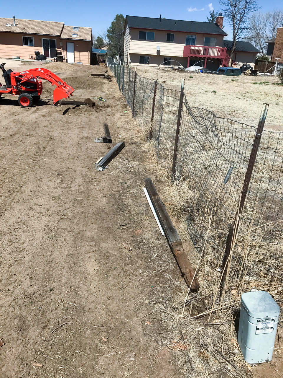

Spent a few hours on the BX2370 today. Yesterday I staged the materials. 6 yards of fill dirt. 2.25 tons of pea gravel, 4.5 tons of 3/4" river rock, 2 yards of garden dirt.
Pulled a few old 4x4 fence posts. BX had no issues will all but 2. Pulled them with a Hi-Lift jack.
