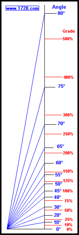

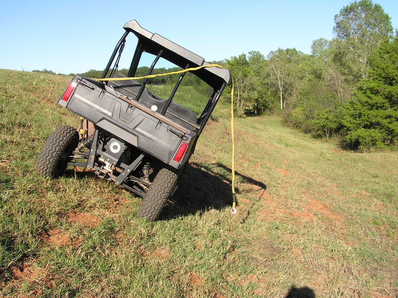

A 25% grade would be no problem.

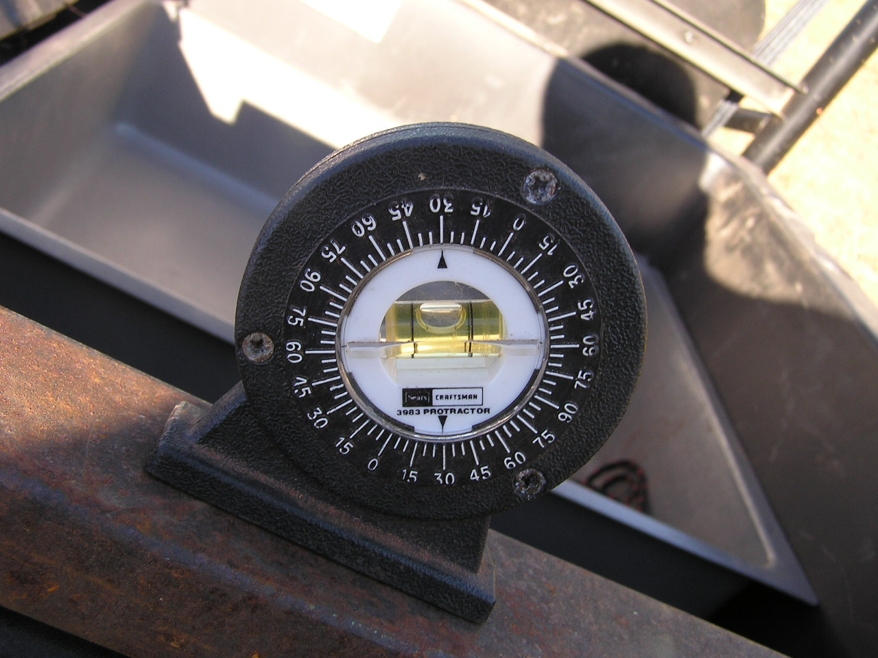

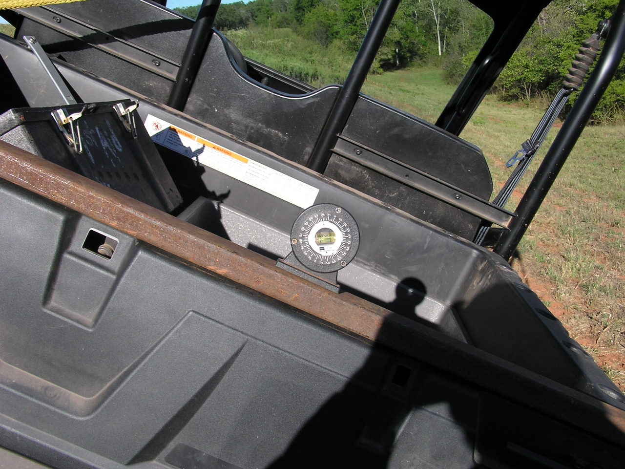

This is a 50% grade, or about 27 degrees of slope.
Showing 30 degrees of body lean, (the sway bar is disconnected).
Angle to grade chart.
Grade to angle chart.

Hi Chuck, I have a BX2360 and I use it for most everything except mowing. It is tippy. Here in the Adirondacks, most every piece of property has a hill or two and mine is no exception. I got a skid plate right away from BXpanded. fits right on with no problems. I can tow logs that are 12" in diameter and 15 feet long with ease. I would say that if you don't lose concentration, the hills should be OK, but looking at the chart above, I would not try the 27% one myself. Good luck.
