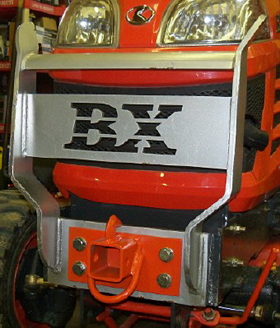

This is what I use and have moved all my trailers around uphill 25% grade and down (4wd needed on hills!) handiest thing ever bolted onto my BX.
This one is from fabworksoem.com (Fab works OEM)
Not sure if this is the same guy that sold mine (eBay) but it’s the same hitch. I just raise the loader up as high as I need for seeing where I’m going.

There is a guy building the front hitch on eBay. This is the same guy I bought mine from. The first one he sent had a funny bend on it and he sent me another one and told me to keep the bent one.
Search “Kubota BX front hitch” on eBay and it comes right up.
