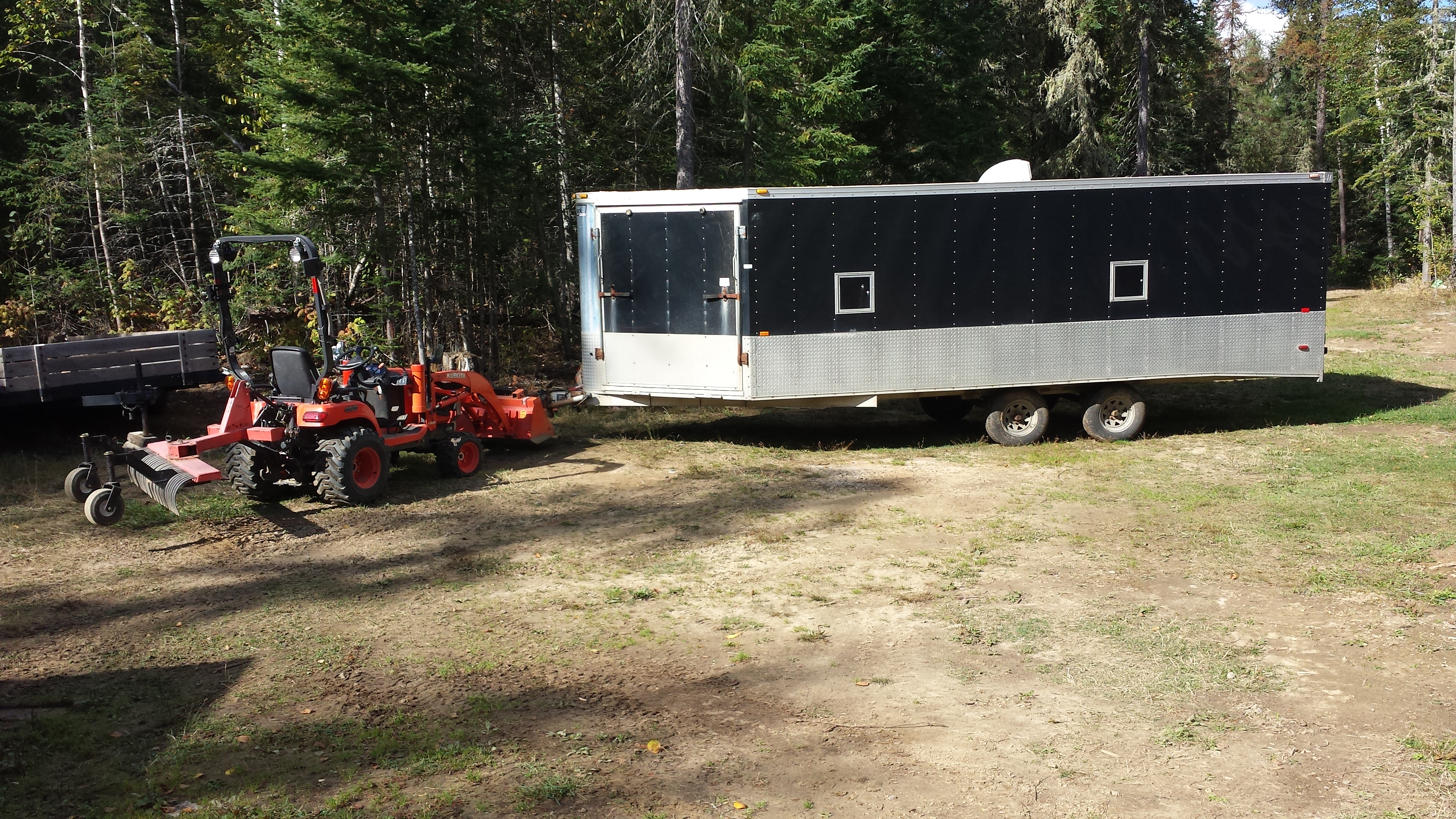

Don’t understand your logic... tongue weight is far less on any reasonably small to large home or farm trailer. If a BX can lift almost 1000 pounds way out front, it can surely handle the weight just in front of the axle. Also with a hitch in the front you’re going forward not reverse except when first hooking it up.
I don't get where the 1000lbs up front? My BX2200 LA210 can only lift ~450 lbs and that is pushing it.
All I know, is that trailer I have attached in the picture is roughly 200 lbs unloaded at the tongue. Even on the back of the tractor unloaded it has pushed me. The trailer weighs about 2,000 lbs unloaded.
So I'd never want to try attempting to ever move it with the loader or the front in fear of loss of control or worse - a tweaked loader or front end.
I suppose the front option only for moving light garden trailers?

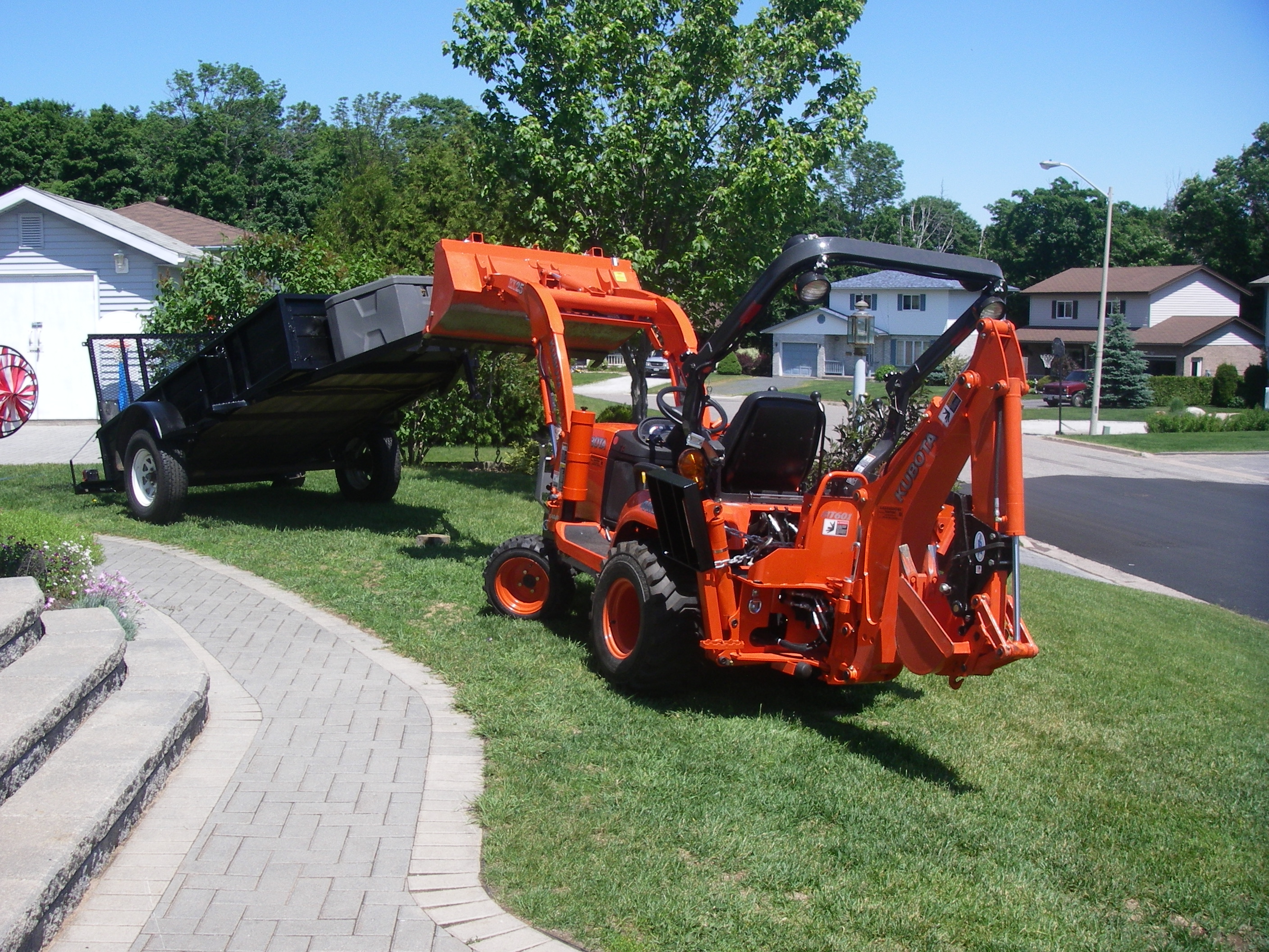

I guess it's up to your own personal needs and your own comfort level. I moved a 25 foot Haulmark enclosed trailer (empty) and like I said - there were initially some scary moments. But I learned from them and I would have no fears moving the same trailer with a BX again - going slow and not taking chances if the terrain was wrong. I have also moved my 16 foot Big Tex car hauler and my 5 x 10 utility trailer and a couple of boat trailers into and out of some pretty tight spots. Here's another use for the bucket hitch. I lifted my 5 x 10 up in the air to do some touch up work on the underside that I couldn't have reached otherwise. I did block the wheels, lock the loader and put a couple of satey braces under the tongue while working under it.

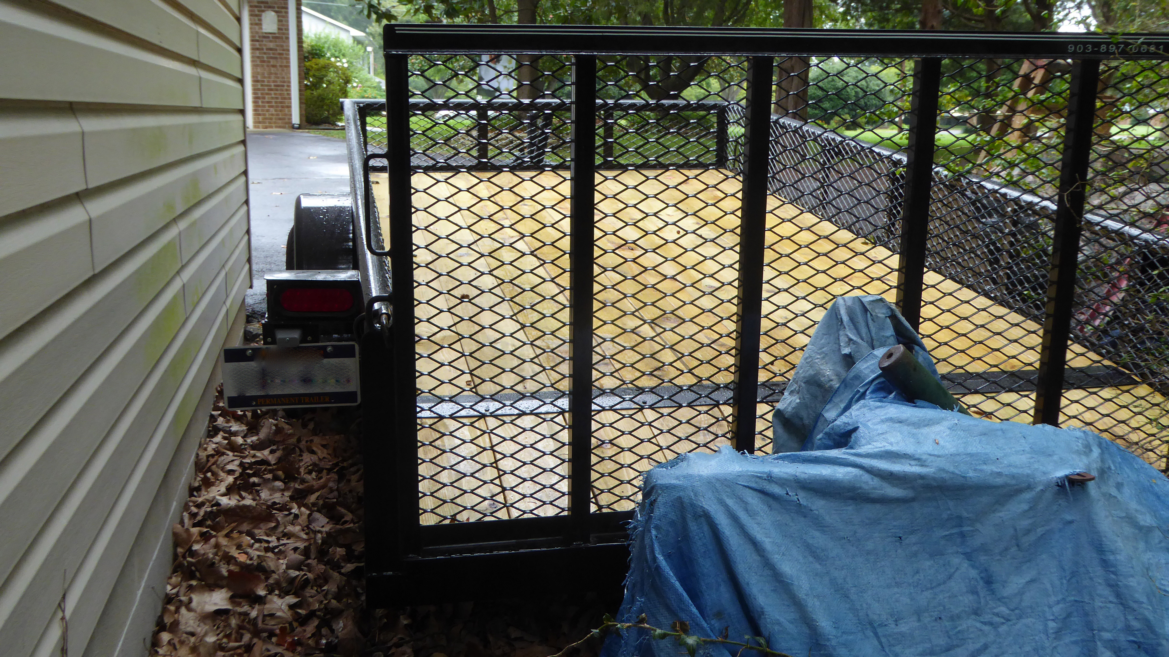

Well said GRTkub. Handy...and not over do things. I do not see any need to cringe regarding this handy (in many cases indispensable) method for moving trailers and stashing them. There are always ways for clumsy people to do silly things and you really cannot prevent disasters that those people will find a way to accomplish.
Here is a spot where I stash a 14ft Stage Coach trailer that cannot be done with a pickup (unless you take all day, cut and try, and like to repair siding.) Not easily seen in the pic is a wood pile close to the right side of the trailer. It is being parked between a wood pile and garage.
