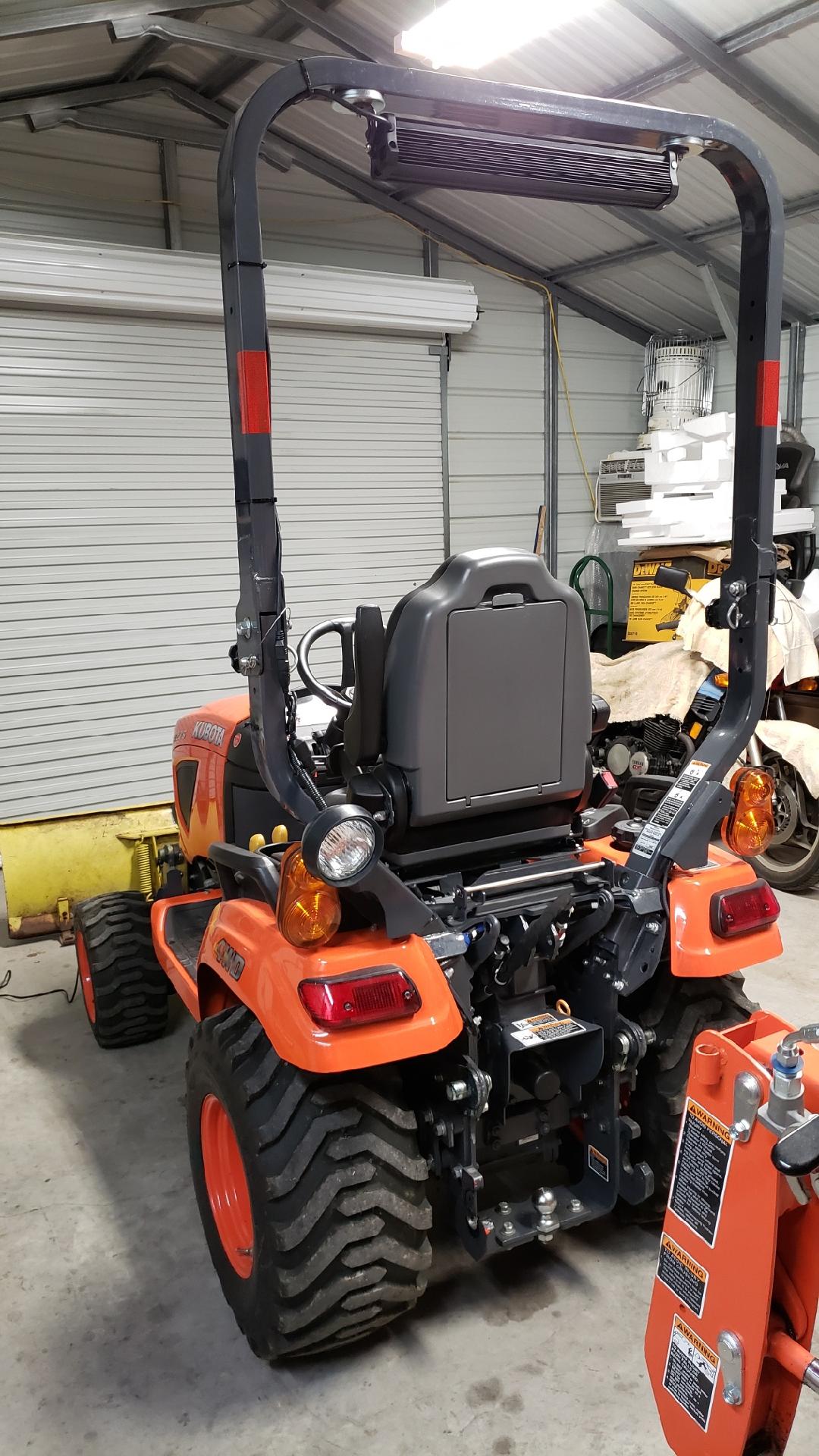

I finally added a 21.5in LED light bar to the under side of my ROPS today. I then added a small 55watt utility tractor light to the left rear of my BX. (i`ll switch the rear to LED next summer when i have more time, and its warmer out)
Took it out after dark, wowwwww, what a HUGE difference with these LED lights! I think i`m around a 8amp draw with my added lighting. (wired to its own circut with a switch installed just ahead of the factory headlight switch on the dash)
All my wiring is routed to the original factory wiring harness with zip ties. Took about an hour to install the full harness. (i used 7/16 fuel hose from the inner dash exiting down next to the radiator to protect the LED wiring harness & zip tied)
I went with Harbor Freight, bought two 95lb rated magnets to attach my light bar for now. I do have some 1/2in squared U-bolts, but still need to make some brackets. That`ll be a project for summertime. That way i can paint the brackets Kubota gray.
Later next summer, i`m adding two 50cal ammo boxes to the ROPS so i can keep my chains and some tools in them. I`m thinkin Kubota gray color for the tool boxes.
I`ll add some pictures of mine in the next post below so you can see my light bar install. I really enjoy making/doing MODS for this lil BX tractor.

My light bar on the ROPS with magnets, and a the rear (temporary) utility 55watt light.

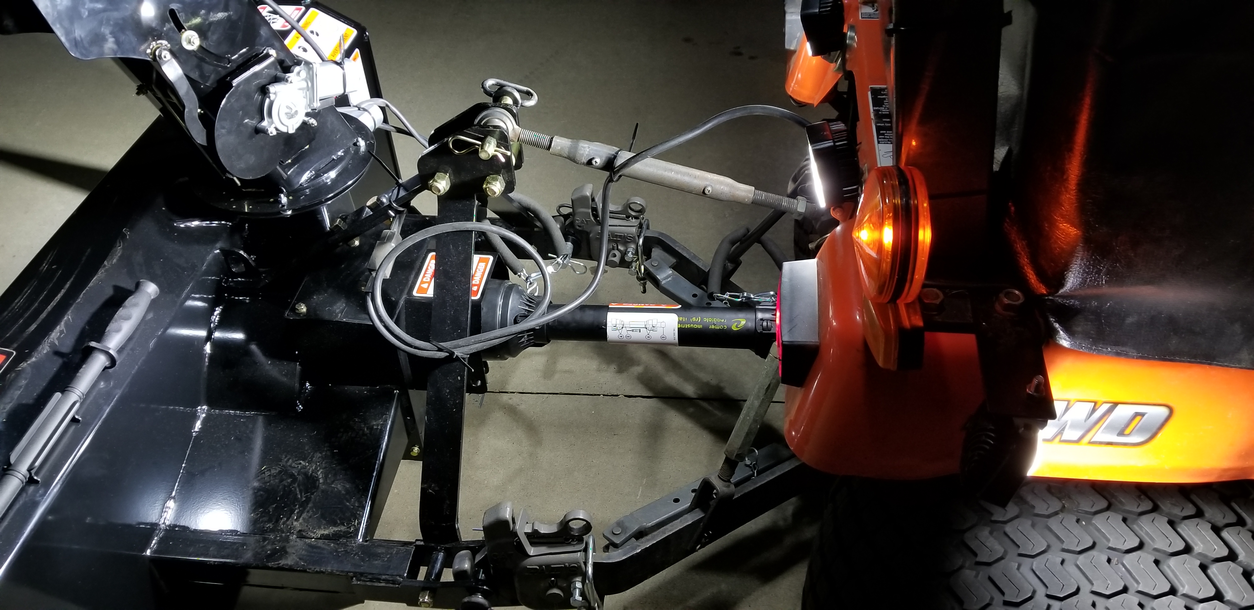

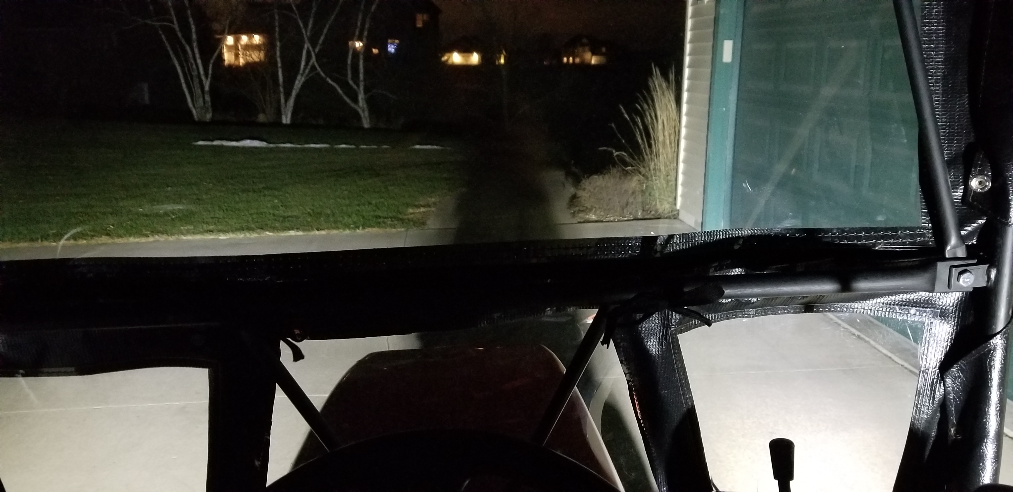

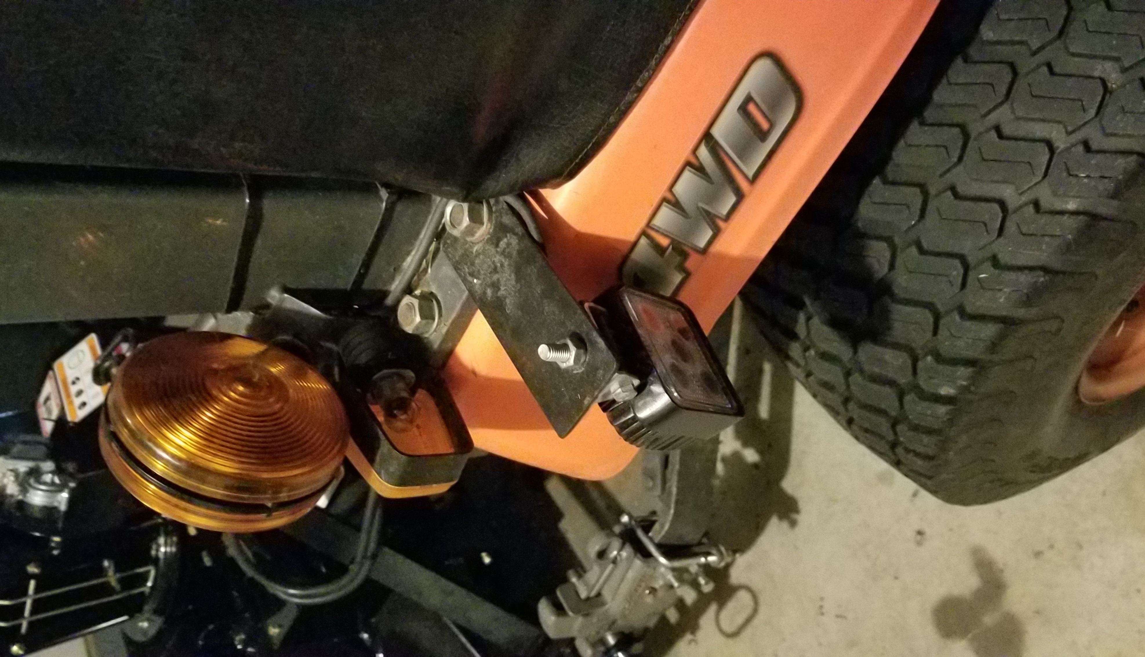

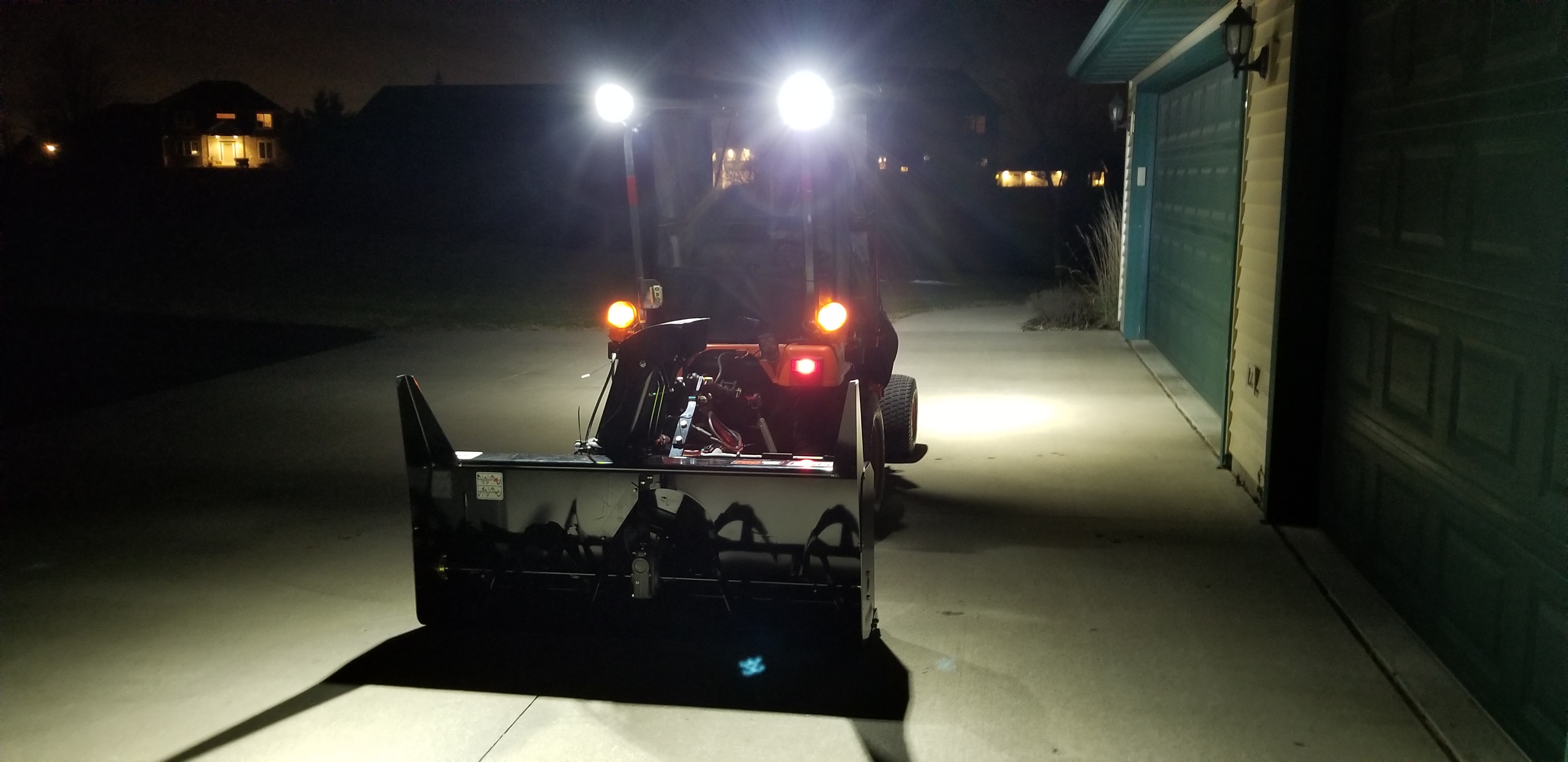

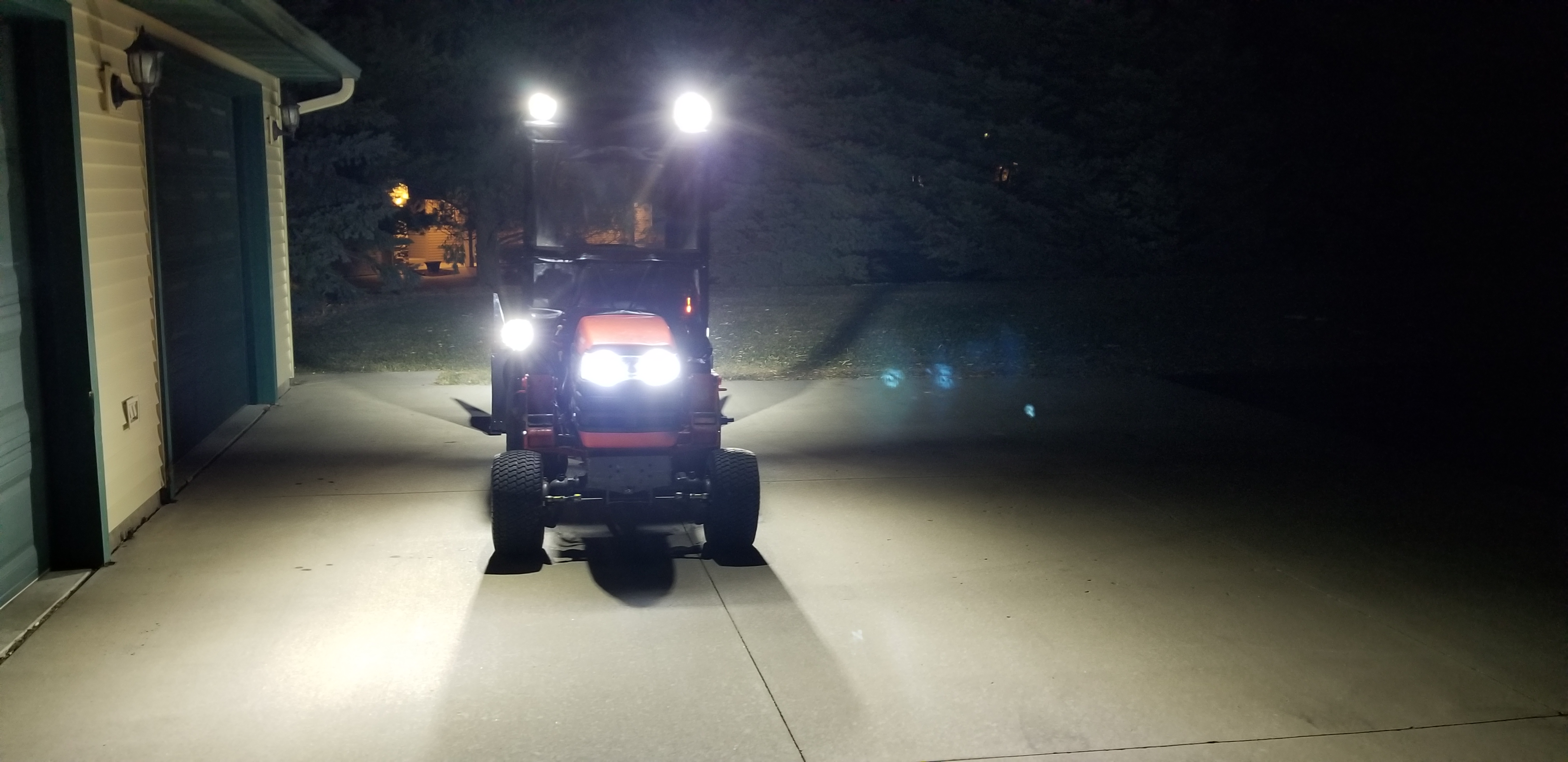

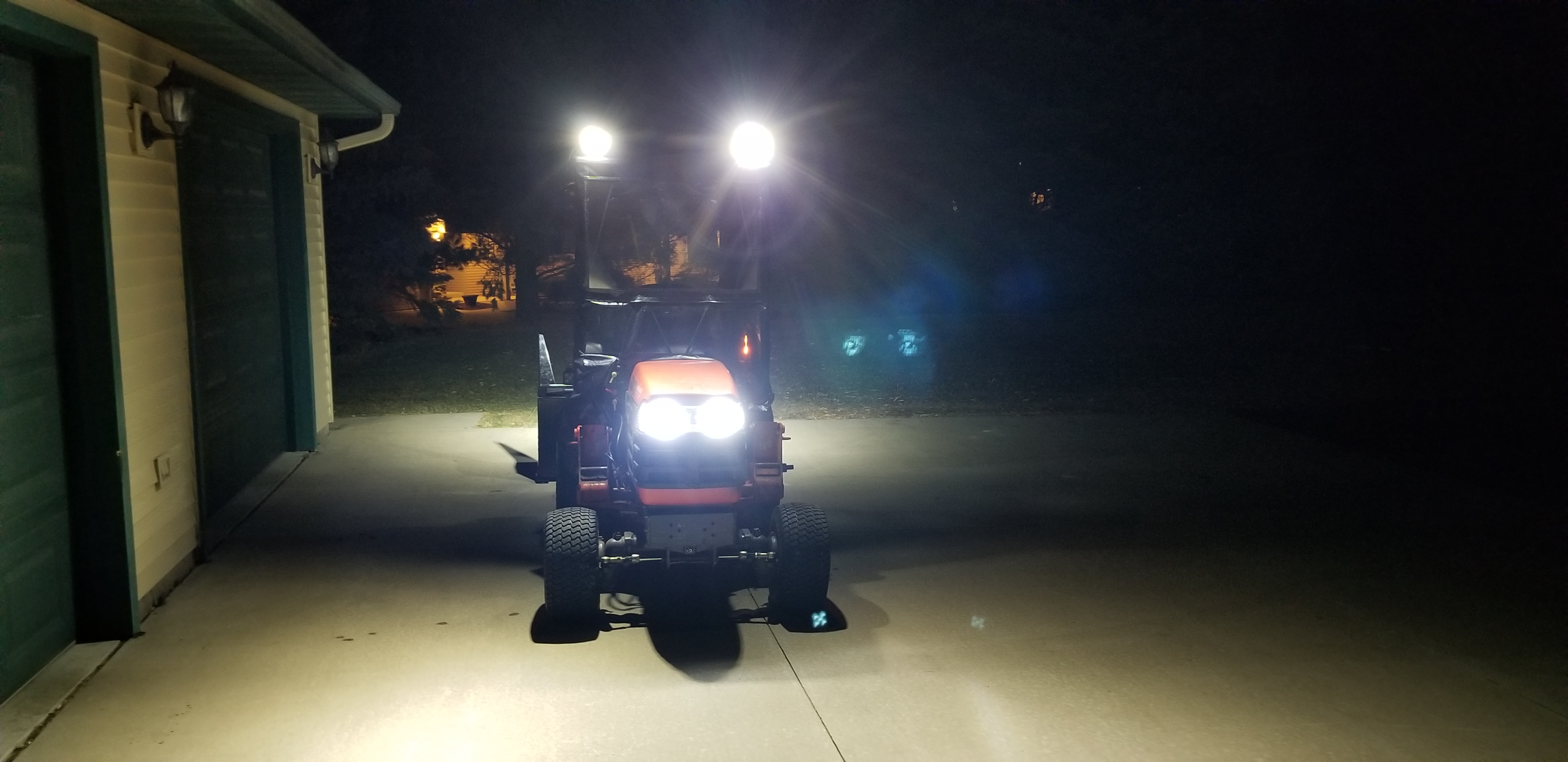

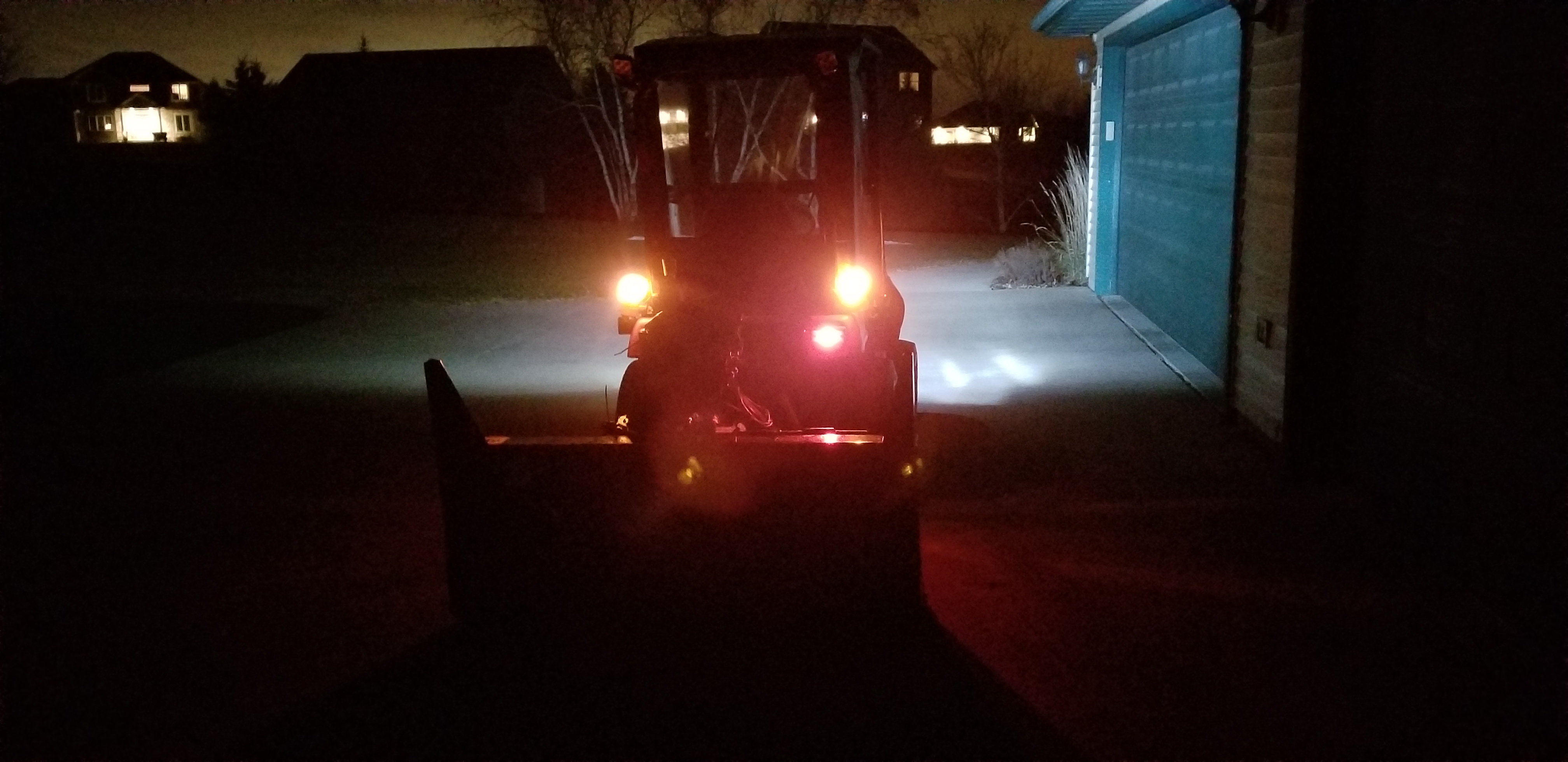

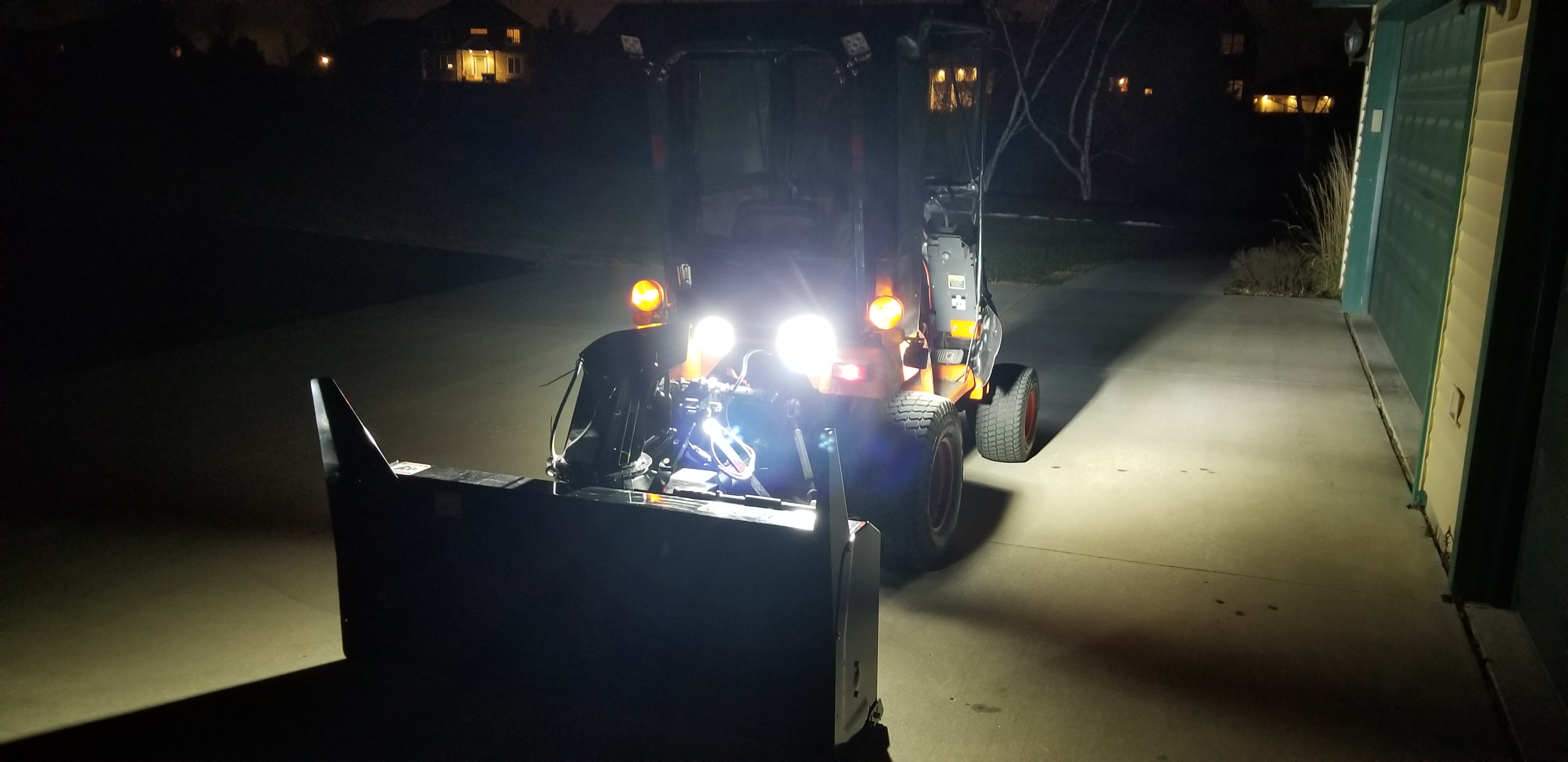

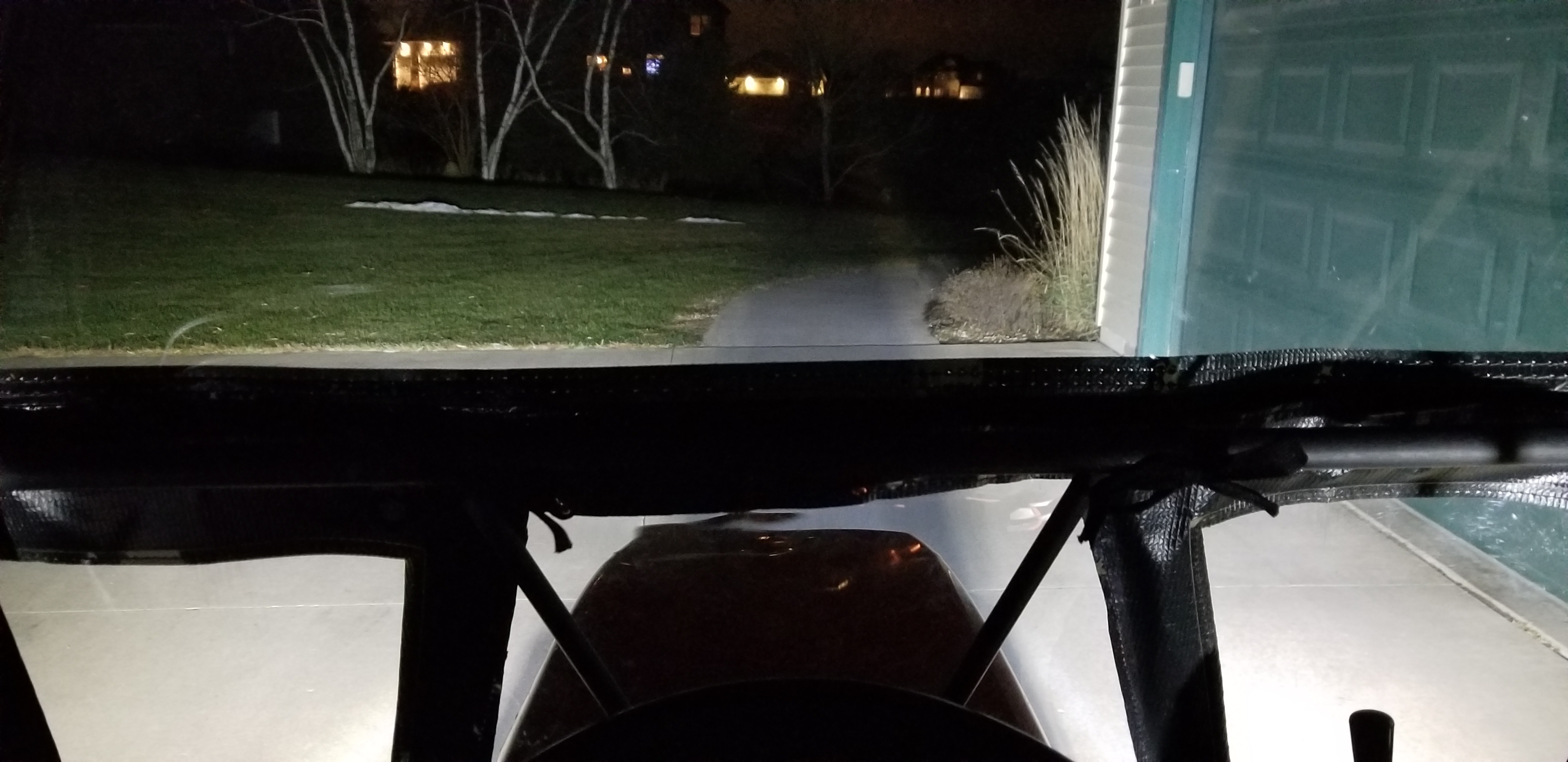

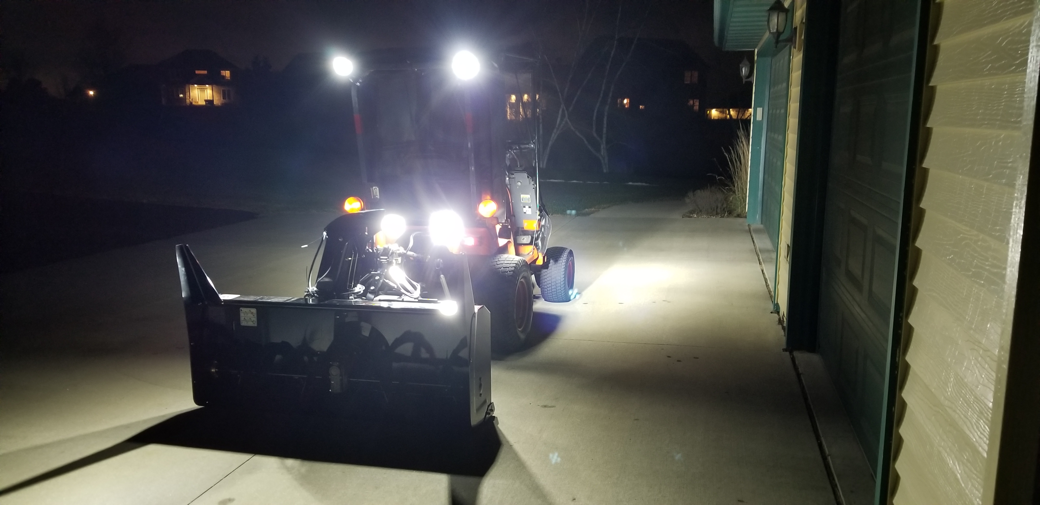

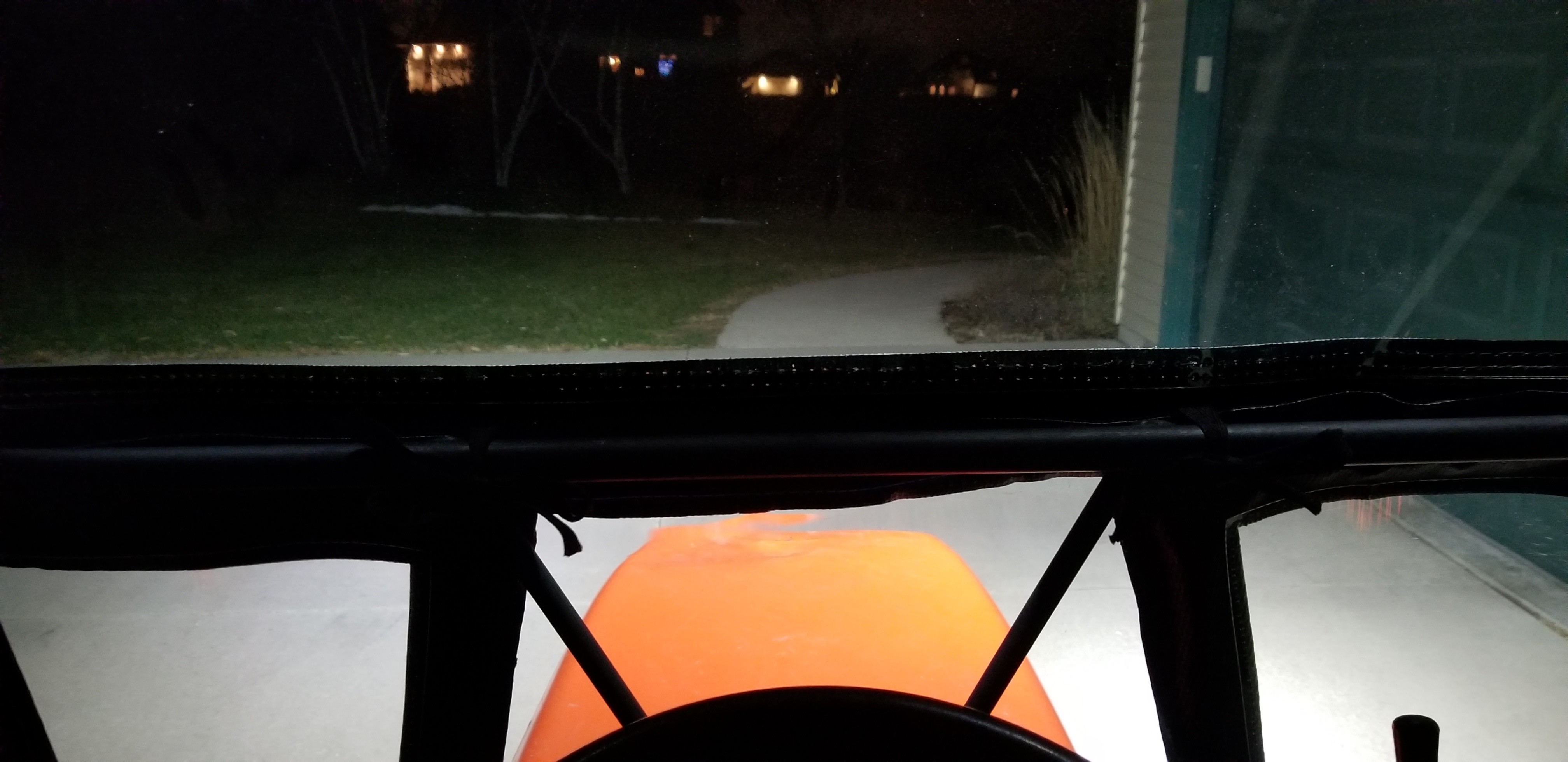

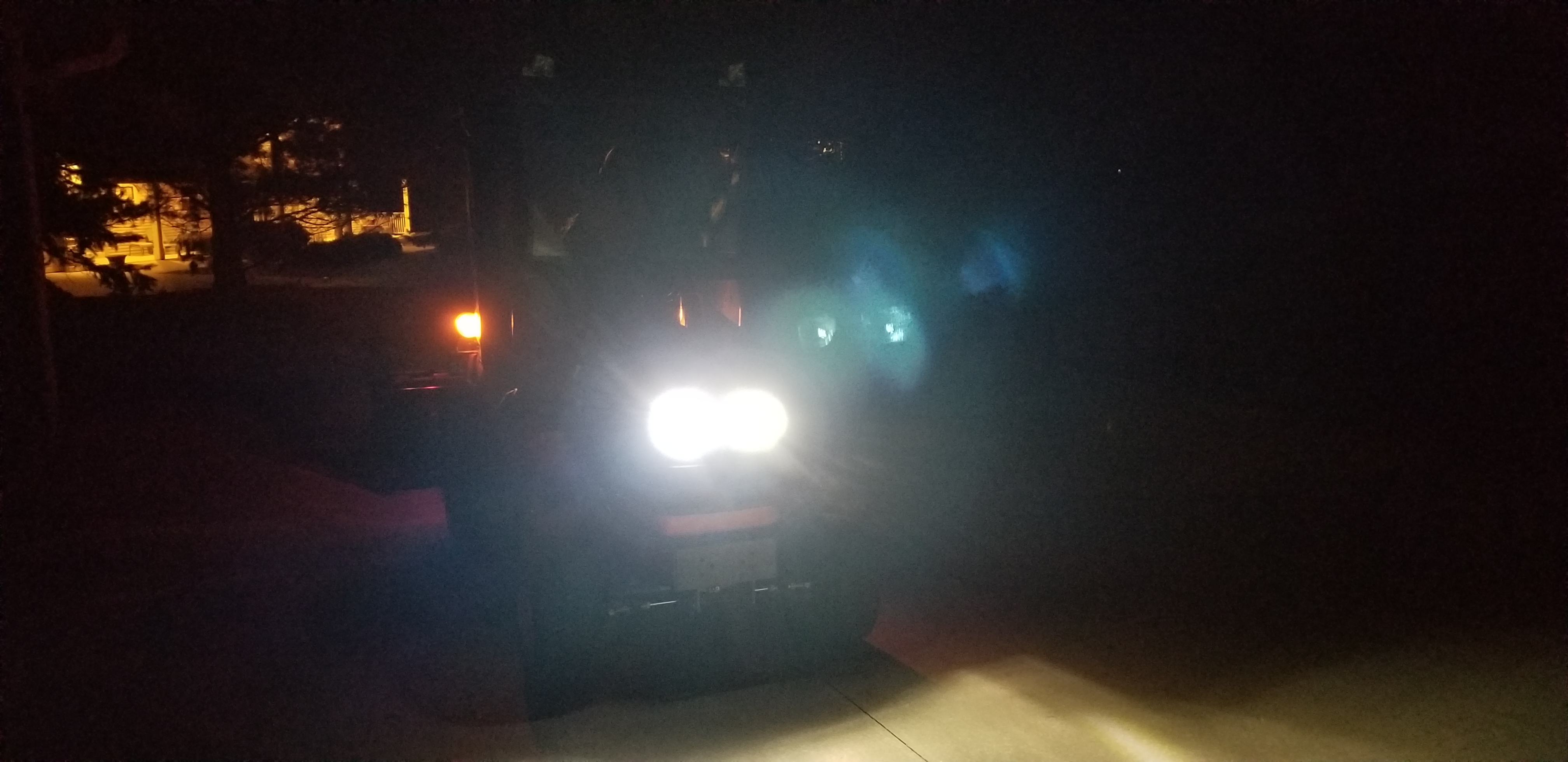

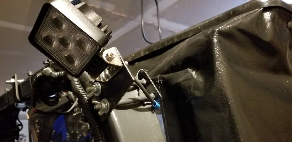

I'm not a welder, so my fab skills have to rely on a hacksaw and drill. So here's how I mounted my fender lights. I did basically 2 pieces like this with bike innertubes stretched around the pieces to prevent scratches and 4 long bolts with wing nuts and lock washers on each pair to make a sandwich around the ROPS. I offset the actual light hole so that it allows a little more flexibility on position. For winter, I flip the sandwich so the lights are up top and for summer, I put them inside the ROPS facing forward for mowing.

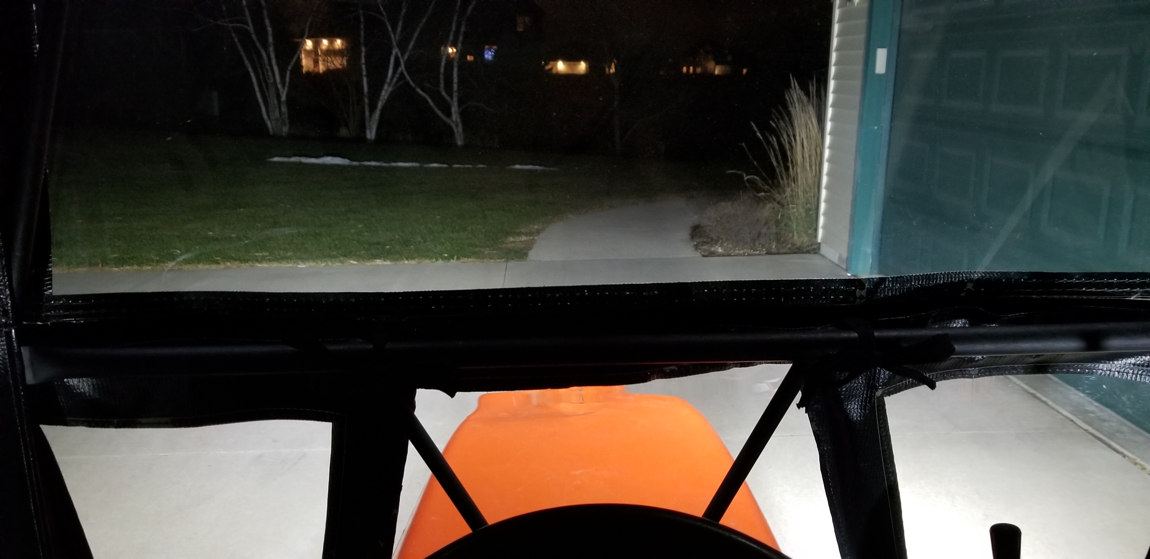

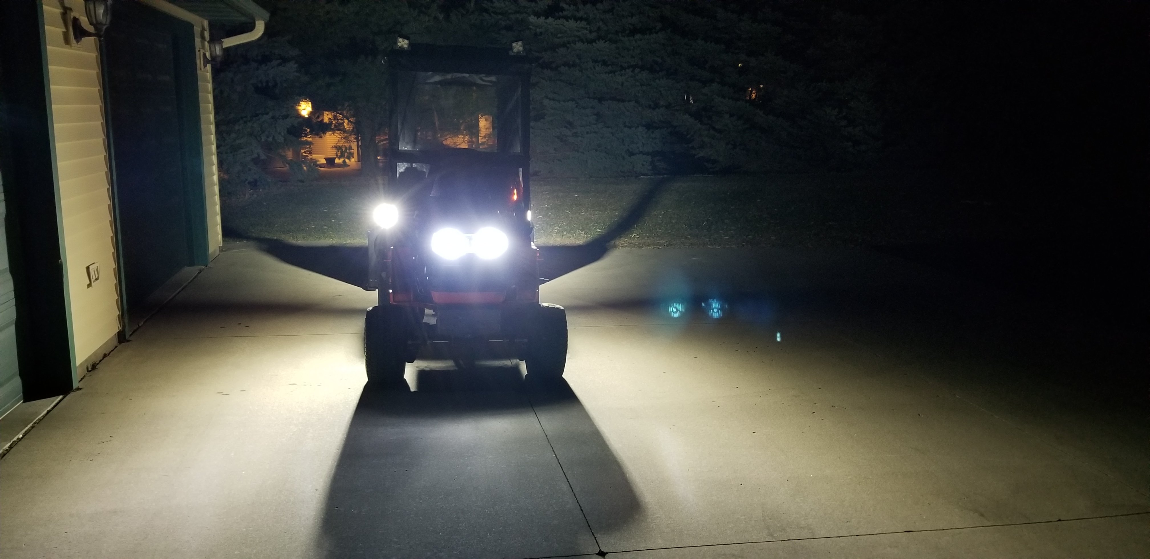

Here's the results, first just stock lights (well, 1156 LED replacements):
No point in even shooting the drivers view with this.

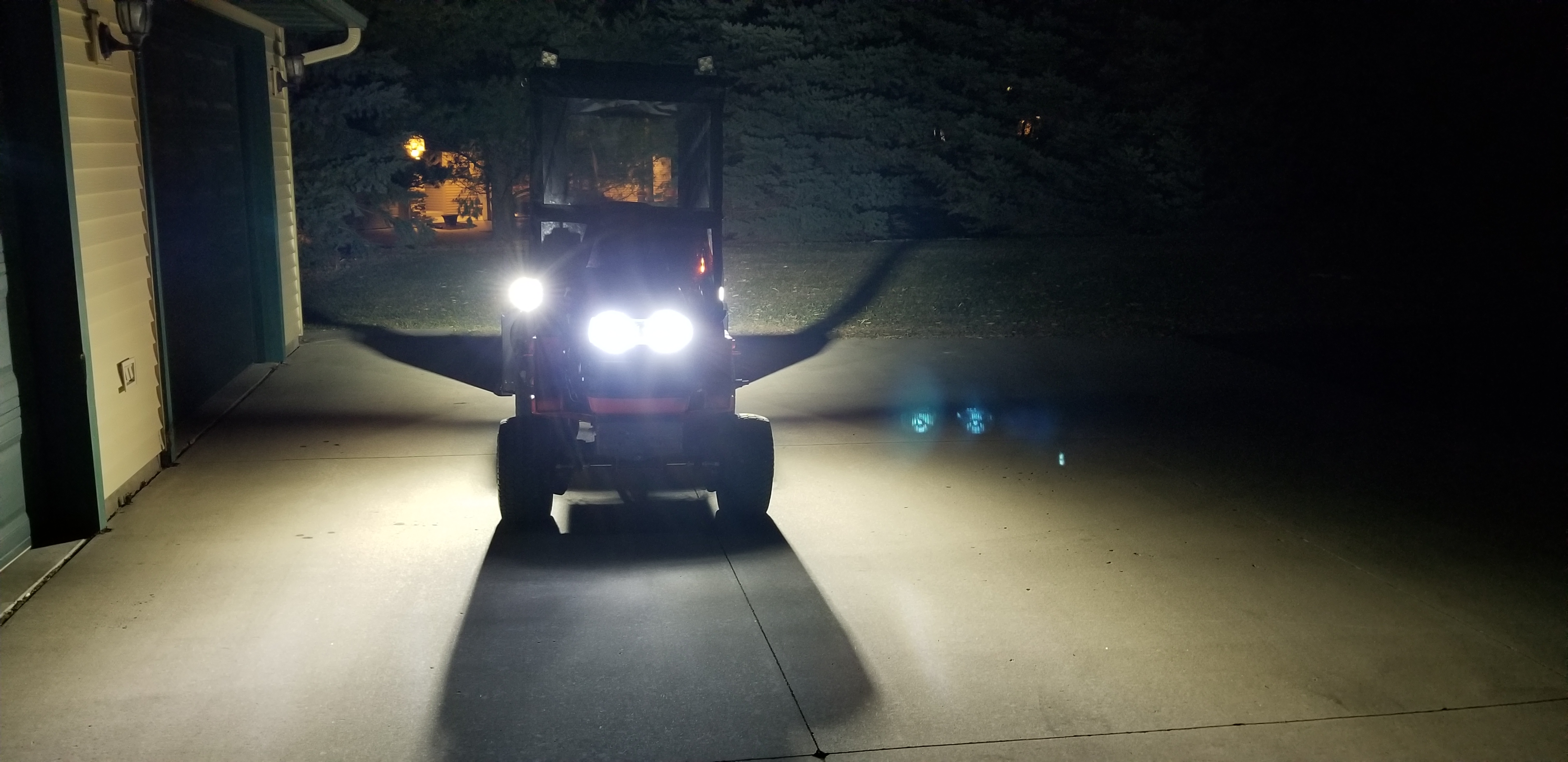

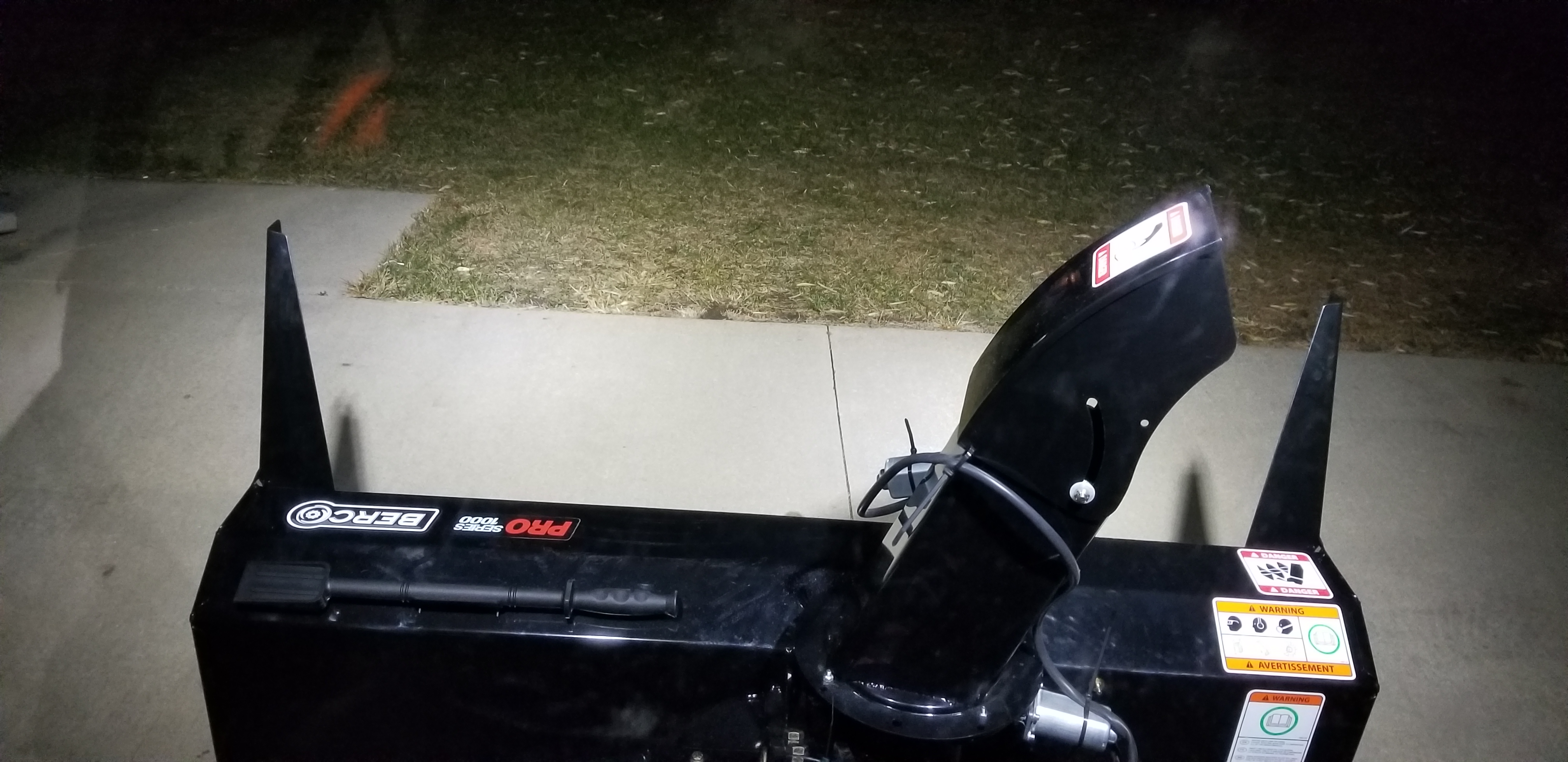

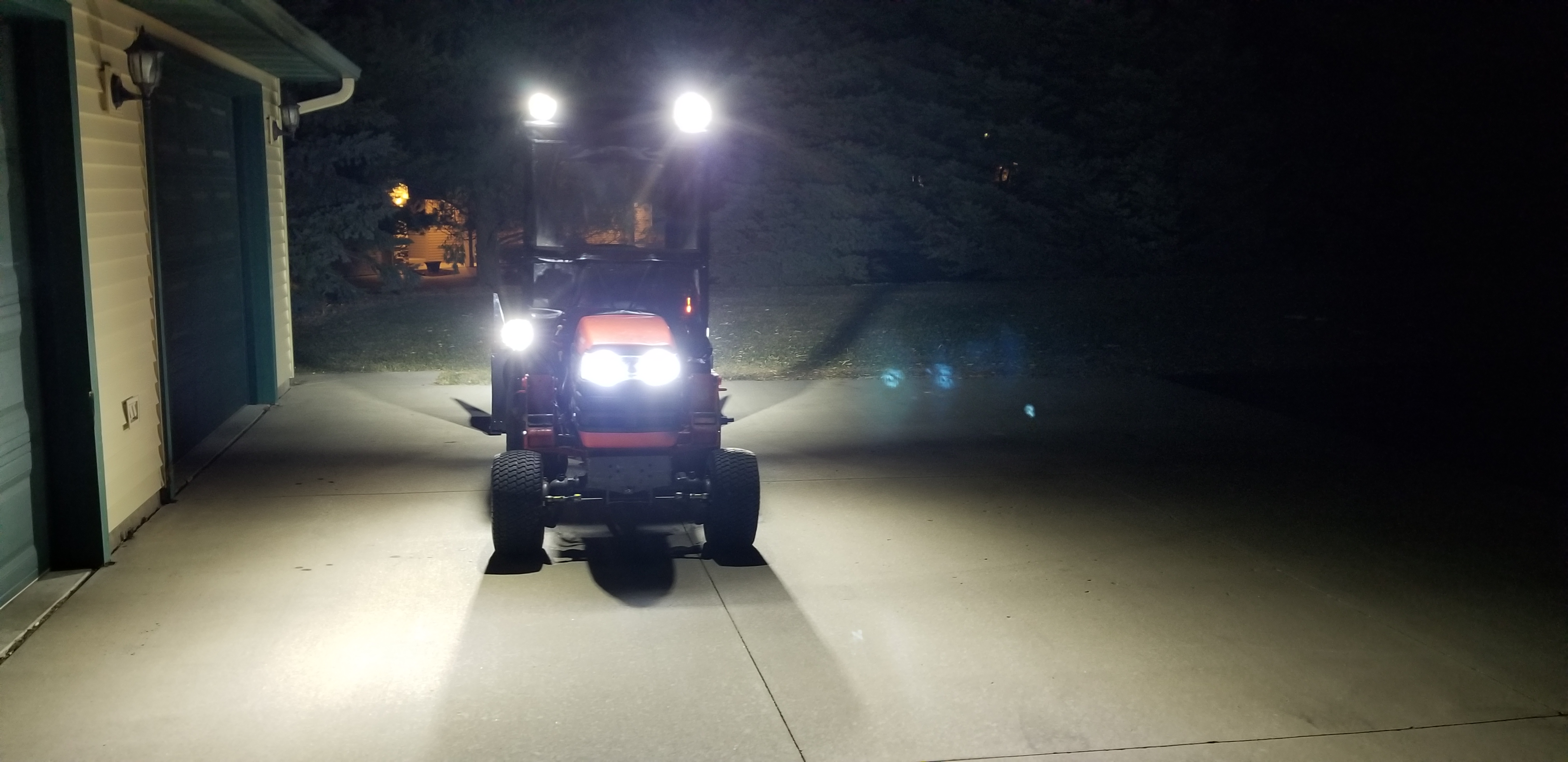

Now add the fender lights and rear bar lights (which are magnet mounted). These first 2 show that the headlights do help some as the sidewalk comes into view:
Or the ROPS / cab lights:
Or run the whole lot of them...
View attachment 629243View attachment 629244
View attachment 629248View attachment 629249
View attachment 629253View attachment 629245
View attachment 629250View attachment 629251
View attachment 629246View attachment 629247
View attachment 629254View attachment 629255
View attachment 629256View attachment 629257View attachment 629258

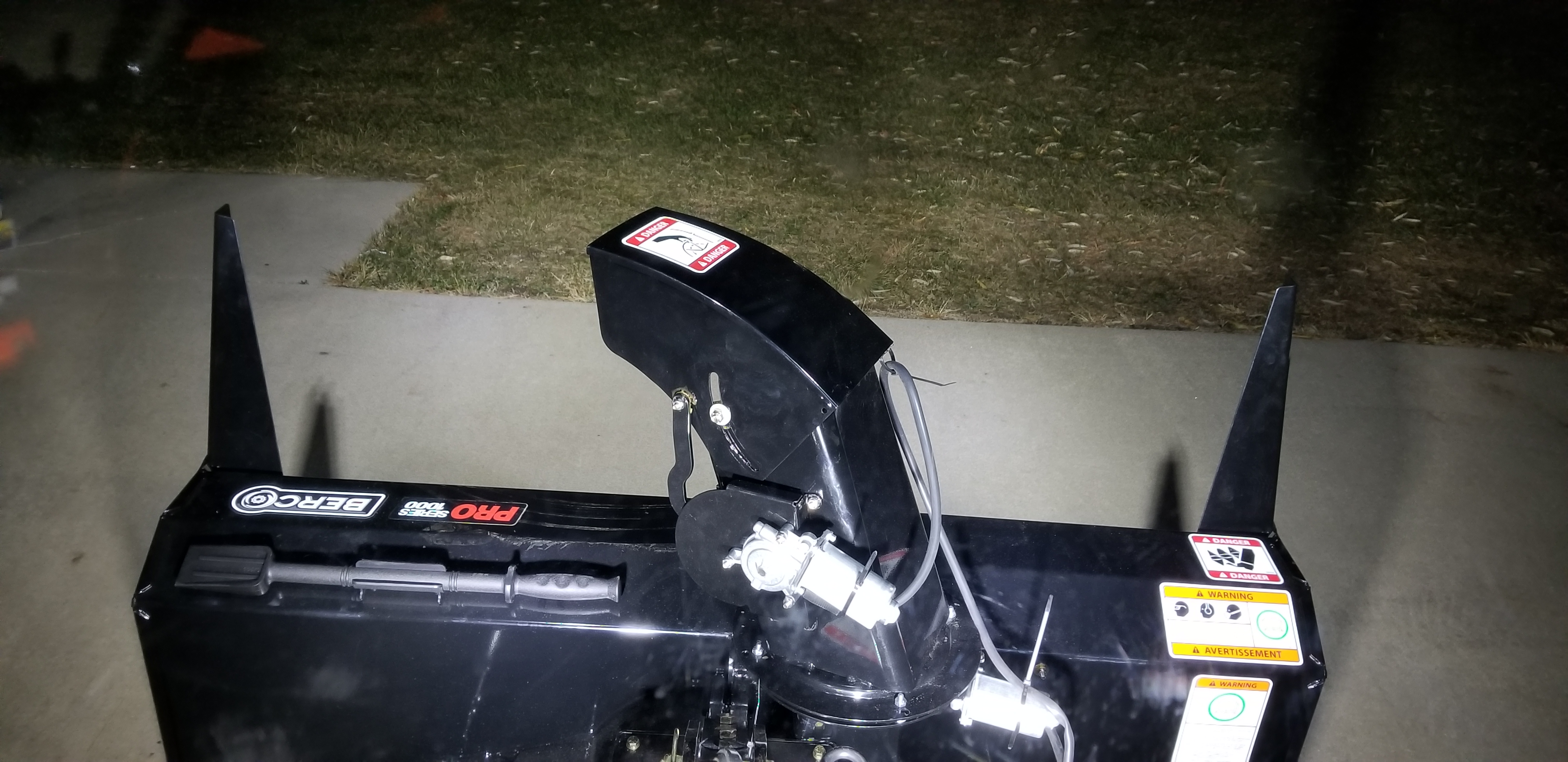

Thanks PaPow. I just got the blower a week ago, cut the driveshaft on Saturday. I was only missing the rear ROPS lights last year (6 lights instead of 8 now). It was ok for using a blade and bucket. Of course the bucket isn't mounted on any of these shots and does tend to render the headlights useless. I might still build a pusher for the bucket so I can still use my horse mat squeegee w/o changing over to the blade. We got about 5 inches of snow a couple weeks ago, but haven't seen a flake since I got the blower. Yes, it really must be that good! :cool2: :shocked::laughing:
The cab is from Original Tractor Cab company. It was new in box, but several years old and dusty as heck. Found it on eBay or CL, can't remember. Cost me about $650, but here's a link for what I have. Hardtop Cab for Kubota BX 183, 223, 15, 18, and 222 Sub-Compact Tractors 11486 I did have the front panel altered where the diagonal rods reach down to the dash. It was all black vinyl and I had more lexan put in this summer. I don't know if it was worth the $40, but I'm going to pretend it is.
