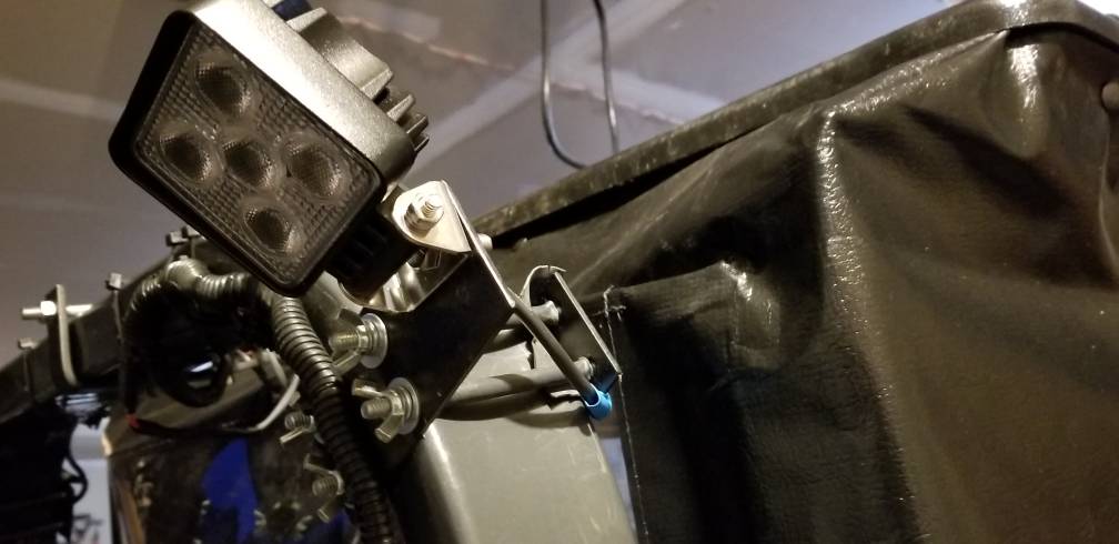

I hadn't grabbed a shot of the sandwich I mentioned earlier. This let's me move or flip the lights around any way I need for different seasons, out and high for snow, in and protected for mowing, when it's more likely to hook branches.

Ray, that is a heck of a great idea!!! Thinking ahead keeps more money in your wallet...lol. My kinda thinkin...sometimes...lol
Utttt ohhhhh, now i`m looking into those rear LED lights for my BX again. Your set-up has got me thinking ;)
