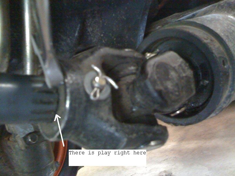

I have about 230 hours on my BX23.
A couple of weeks ago while doing some extensive fel/grapple work I noticed some clunking when I backed up and turned at the same time. It's not audible but more of a feel through the floorboards almost not noticeable. I kinda thought it was a stick stuck up under and rubbing on a tire. I couldn't find anything rubbing but when I grabbed the front driveshaft it had some play. I figured is was the universal. I got time to check it out more and it's not the universal it is play in the slpines that the universal attaches to. I think this is where my clunking is comning from.
Here is a pic.

Thats what i am feeling too. Its not much but enough to put a thought in my head that it shouldnt be there. I had not checked where, nor did i feel that i should since i only have 14 hours on it. The play where you have play is no good IMO. My guess is that it would only get worst over time. I wouldnt thing that there would be any slopp at that point. I could have it at the same place and who knows, maybe its how it was designed....

The way it is designed there is no way to eliminate play. It just slides on and a pin goes through it and is cotter pinned. No way to tighten it. I am just going to let it go until it becomes a problem. Who knows maybe it never will.
The side in the picture is the drive shaft side, you can't see the axle side but it has play also. Changing a drive shaft is no problem but getting the slpine shaft out of the axle seems like a major undertaking. I could saw a split in the joint where the spline shaft goes into it and put some sort of a "U" clamp arond it but that seems like overkill and it would weaken the joint, even though the jiont is probably the cheapest part of that sysem, about 40 bucks

Are there grease zerks on those U-Joints???
Craig
   / BX24 4x4 clunky... #29
No. But the joints themselves are tight.
