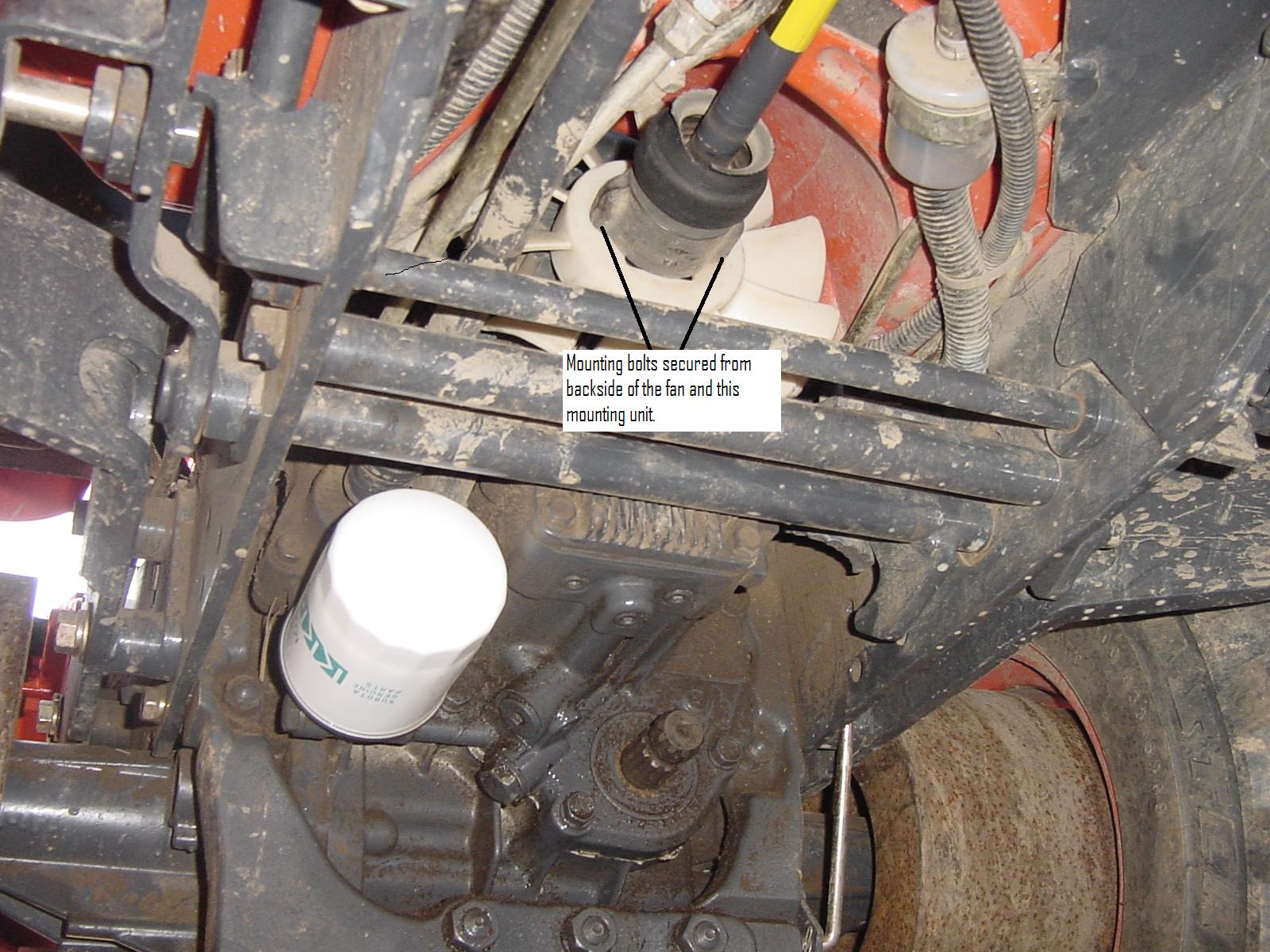

OK, this is a continuation of my post of me tearing up the fan by driving over a twig after about a year of use (I guess you can say that I got a little comfortable with it and forgot to pursue the skid plate addition). I did ask the dealer about any kid of protection for that fan back when I bought it, and he stated that he hadn't heard of any problems with that fan nor any kind of protector for it. Needless, when I called him this time, he did say Kubota came up with a little protector that blocks anything that comes directly up at the fan.
Reading the forums, I read that some were able to slice the fan and wiggle it;s way around the shaft and secure it. I took a look at my set up and it appears that the fan is bolted onto the mounting stump on the shaft by bolts from the back side of the fan. This would make it very difficult to access even if I could get the new fan around it. Can that be moved/slid in any manner?
Dealer quoted 4.5 hours x $75 an hour plus the cost of the $7 fan. Has anyone ever gotten Kubota to replace it under warranty?

Here's a picture of it...this is not my tractor but one I found on the topic of the skid plate...however it is the same setup...As you can see, there are cooling fins on the HST block that should also be kept clean (i.e. more justification for some type of skid plate).

I still think i would section the shaft when I have to replace mine.
Cut shaft with sawzall have shop machine both half's for rigid shaft coupling
put both half's back in with new fan and rigid coupling. next time it will only take 1/2 hour.

In defense of dealer, it's not all that common. But it is such a PitA to replace (and made worse on the BX24), you see complaints here a lot. This site is huge with Bota drivers and the vast preponderance of them have not broken a fan (yet).
So for a dealer it might seem relatively rare.

Replaced mine once, have been using a skid plate ever since when the MMM is off, over 5 yrs. now, can't see a reason to have to do it again unless I leave the plate off.
/ BX24 HST fan replacement #10
I am in the process of putting my tractor back together after ruining my fan last week. I cut the fan in half and tried to put it back in, but just couldnt get the second bolt in the second section. I had to remove the fenders and floor deck which also means you have to remove the ROPS as well.
I got the fan bolted in and epoxyed the cuts as well to make it a little stronger still. Still a real PIA job, but at least I didnt have to unbolt the motor, move it forward, etc.
I am making a skid plate tomorrow, I just cant justify 180 bucks for something I can make myself.
/ BX24 HST fan replacement #11
last year I made a skidplate roughly 24 inches long from plywood with a few odd cutouts where needed (for oil filter) , then hung from 1/4 bolts using plumbing strapping cut to length (roughly 3 inch pieces to reach to four existing holes in the frame , double nutted the bolts so they stay in place while just needing to remove one nut to slide straps off ..........works for me , can take on and off in ten minutes, and 3/4 plywood will stop any stray sticks. If I hit anything that can go thru the plywood then I should not be driving.
