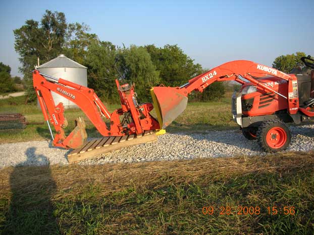

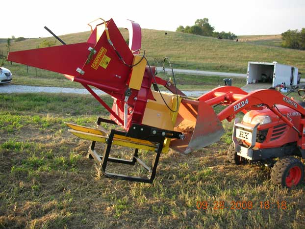

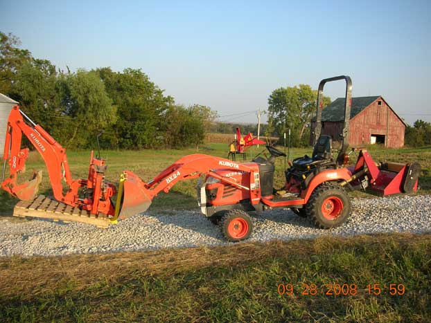

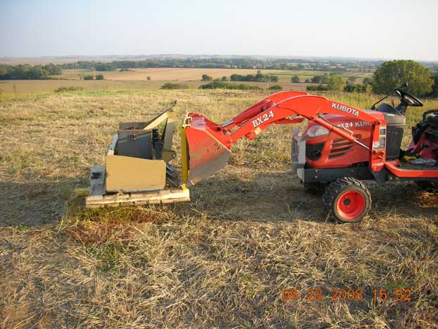

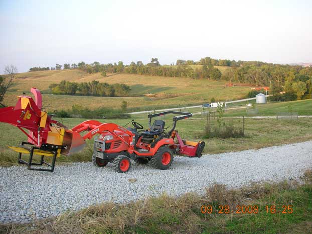

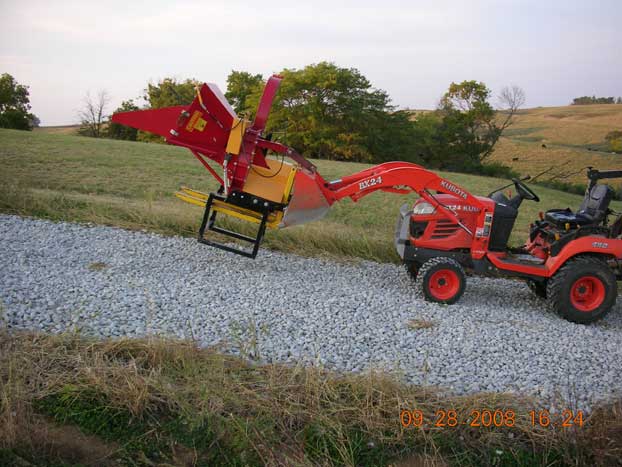

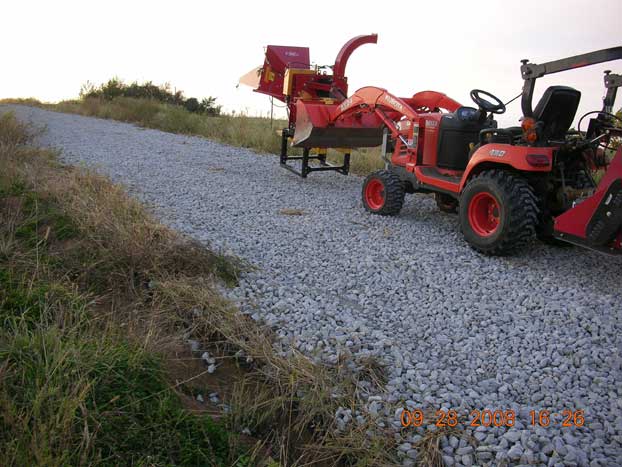

Here are the real world pictures promised.
When lifting the backhoe, the front bucket will not lift the hoe, so I start with a slight tip on the pallet.
Then just curl the bucket. PS. There is not enough curl power either. My BIL has to exert about 75 pounds of additional force to end up with the result in the second picture.
Of course, the tractor has no trouble lifting the 250 pound boxblade that has an additional 300 pounds of ballast.
The toughest item to lift and move is the 6" wood chipper. It is over 800 pounds and my BIL is required to stand on the flail mower to keep the back end on the ground. Once again, the loader will not lift or curl the chipper, however, with the BIL, it is movable.
tbncarsceLiftChipper.jpgtbncarsceHaulChipper1.jpgtbncarsceHaulChipper2.jpgtbncarsceHaulChipper3.jpg
I believe the loader would lift any and all implements I have if the weight of the implement was "in the bucket" and not 4' out in front of the bucket.

As you can see in the picture of backhoe on the pallet, the backhoe is farther away from the bucket making the leverage point worse. If I could get the entire backhoe in the center of the bucket, lifting would be no problem.
I read somewhere the BT601 backhoe shipping weight is 617 pounds.
Zick,
Good observation on the curl. Yes, the thumb does add some weight way out front and when I chained the backhoe into the bucket (similar to BXpanded), there was no trouble curling the backhoe till it was almost all directly over the bucket, then lifting.
The pallet is much faster for loading and unloading in the trailer as opposed to getting off the tractor and chaining the backhoe to the bucket. (ok, just a couple of minutes faster)
