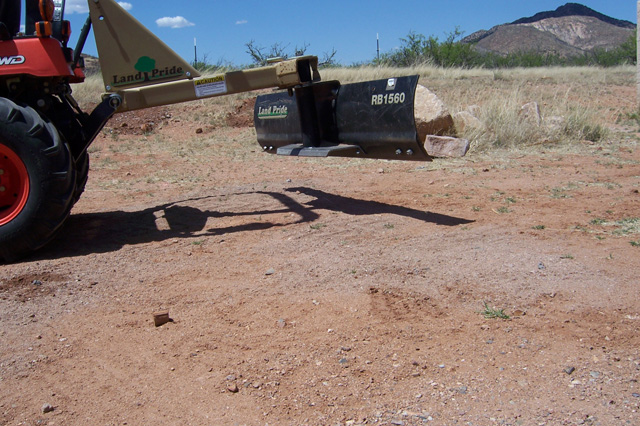

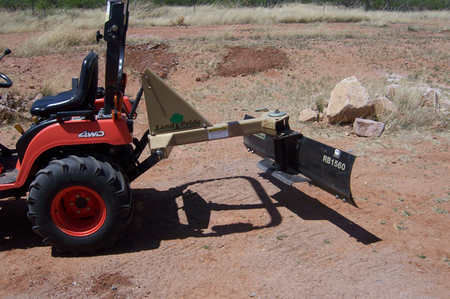

Ask and thou shall receive here are three pics of my BX22 with a RB1560 on it.

   / BX24 - Land Pride Rear Blade - R0560 vs R1560 #10
Can you tell me if in these photos your are using a stock Kubota top link. Also can you give me the length of the top link pictured here.
I just purchased a BX25 and a RB1560.
Thank's
