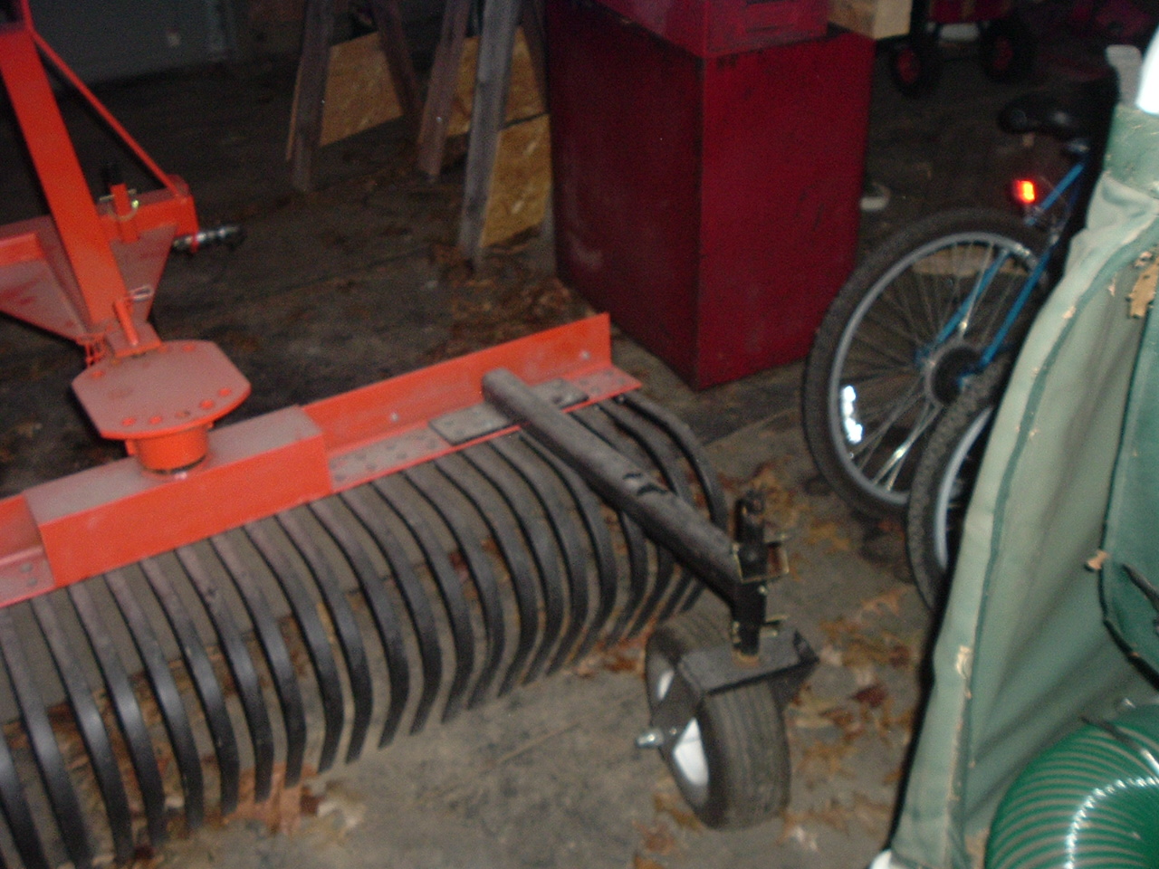

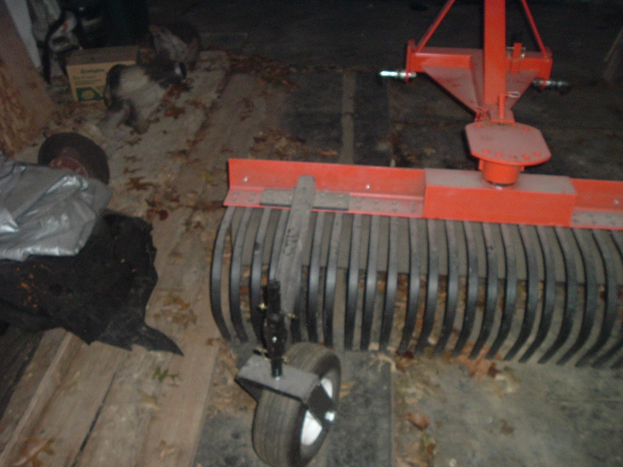

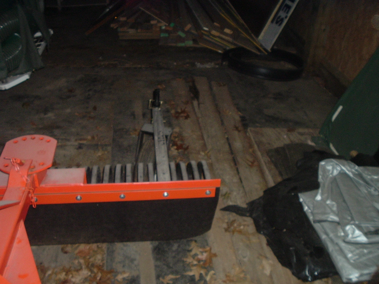

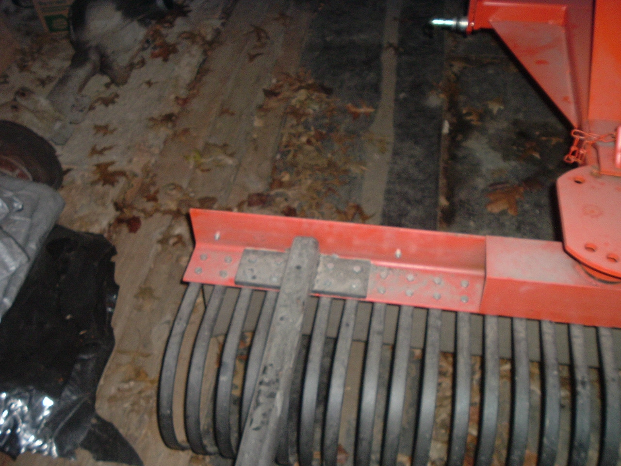

Singlecoil, Here are some pics. of my gage wheels on the Farm Force rake.

Thanks CHDinCT and ActionAJ for the pics.
Mine looks just like CHD's. It looks like the wheels would be a snap to install. I'll be adding those to the wish list.
