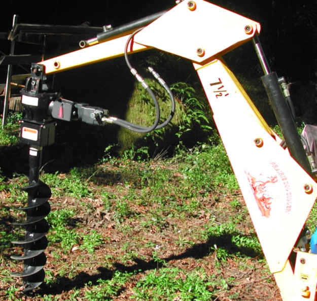

My Danuser 8300-2 hydraulic PHD cost right at $1400. A 9 & 12 inch auger with a 14 inch extension ran the price up to around $1800. I hang it on my BH in lieu of my bucket. I cut the lines to the bucket actuator and installed quick disconnects. The PHD hangs from a knuckle swivel and the bucket curl lever operates forward and reverse. :cool: I also modified the included knuckle swivel to fit the pin for my bucket for $115 :eek: for a piece of 2 inch round stock and machine shop labor.
hugs, Brandi
/ BX24 PHD

Here is a photo of my Worsksaver PHD. It has a homemade
plumb indicator.

No problem. :) I haven't got any photos of the lines down to the digger. Yet.
The first photo shows the quick disconnects and clamps I installed :cool: after the hose shop cut and crimped on new fittings. The 2nd and 3rd photo show the PHD on the backhoe. You can see the machined mount in brighter yellow that is welded to the swivel knuckle, which is a flatter yellow. Sorry I didn't get a close up. Anyway, I just got the line fittings for the auger motor, so I don't have any shots of the finished line installation. :( I hopefully have it all ready to dig holes next weekend. The 4th photo shows the BH blocked up for line removal. The line bent up in front of my pickup tail light is where the disconnects go. The 5th photo shows the cover off of the control valves. Quite a can of worms. :D
hugs, Brandi

I finished my Hydraulic PHD installation today. :cool: Here are a few photos.:D
It runs good and sweet on low rpm. :) hugs, Brandi

It is easy after taking off the 24 inch bucket and thumb ;) , as the PHD hangs from the same point. :eek: See photo below.
hugs, Brandi
