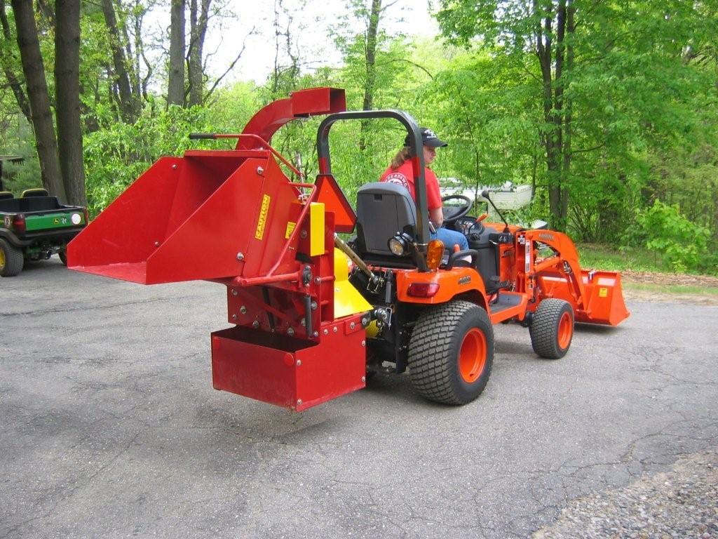

6" Ginma chipper currently used with BX2660, and worked fine with my BX2230. Need to run at full powerwhen chipping. On ocassion, when the blades are getting dull, with some old petrified branches approaching maximum size it would lug the tractor down. Biggest concern is weight of the chipper. Definately want to have front end loader on as balast when transporting. I use this alot and have no complaints.
