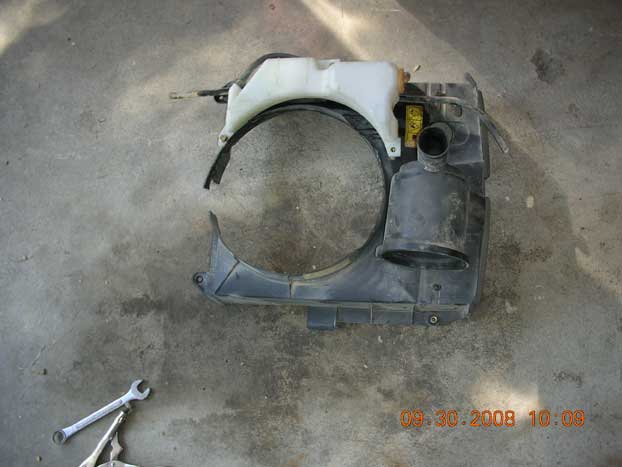

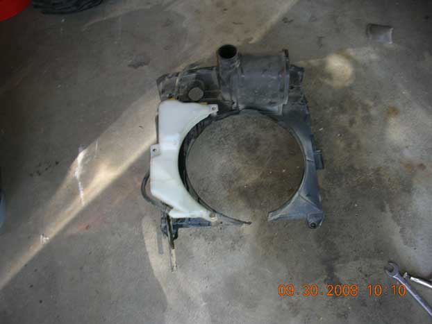

When the 2" diameter hardwood tree branch thrust up through the radiator fan shroud, and into the radiator fan, the Kubota BX24 made a noise so vile, sent shrapnel flying, and shook so hard that chills ran down my spine. After all, I had just killed my favored companion that has lasted longer than some of my relationships. The tree branch even managed to bend a few radiator fins.
I coaxed my companion 300 or so yards to the trailer, loaded her up, and rush her to the ER room at the Kubota dealer. (65 miles away)
The Kubota doctor wanted over $300 in labor to replace her radiator fan and much more to replace her HST fan, so this is the story about repairing the companion.
And so the story begins.
The radiator fan was about $22 and after looking around a little bit, the $7 HST fan was missing a blade and was ordered also. The shroud was $56 and only about 4" of the bottom was broken so an administrative decision was made to not replace the shroud.
Parts will not be here until Thursday (3 days from now) and my hope is to have her apart, cleaned up, and ready for the parts by Thursday and back on the job by Friday morning.

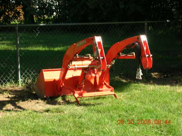

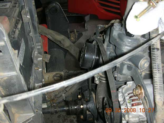

Start by removing the flail mower, removing the loader, and placing the tractor in the garage.

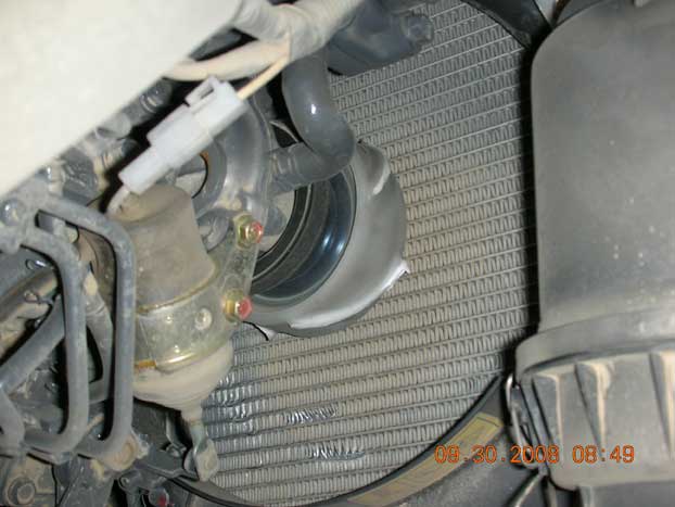

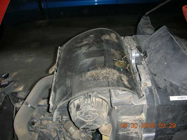

A few pictures of the damage.

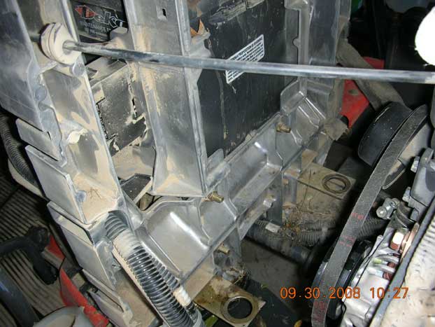

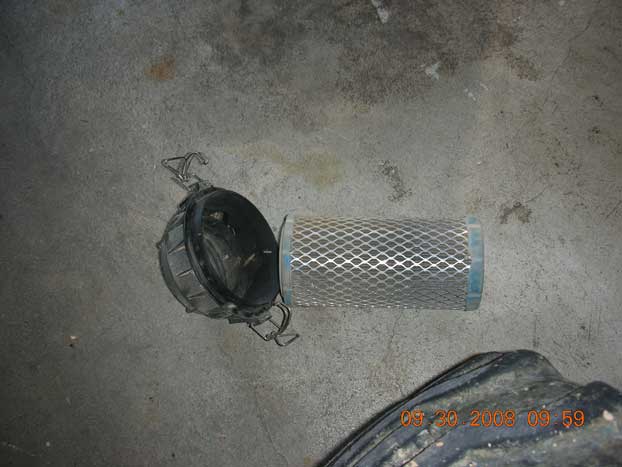

Remove the grill guard, the bonnet side and the air cleaner. Be sure to plug the air intake to keep junk from going in the engine.

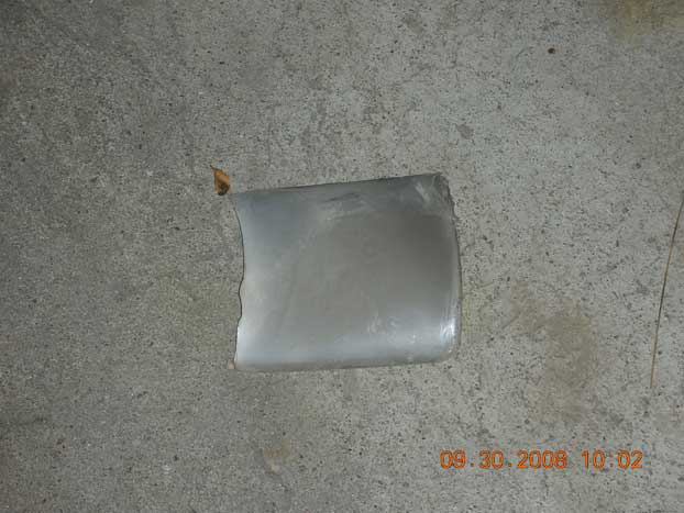

Found a piece of the fan.

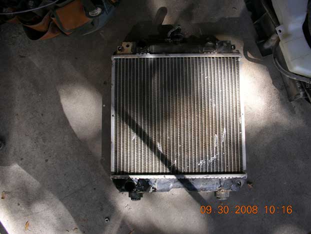

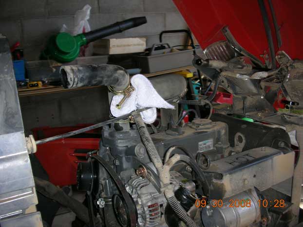

The fan shroud, or what's left of it and the radiator with just a few bent fins. I straightened what I could. And put a pan under the tractor to catch the coolant, otherwise you have to clean the floor before the parents notice.

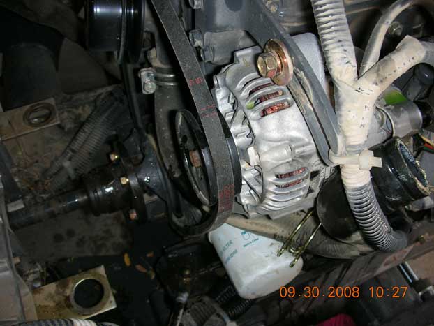

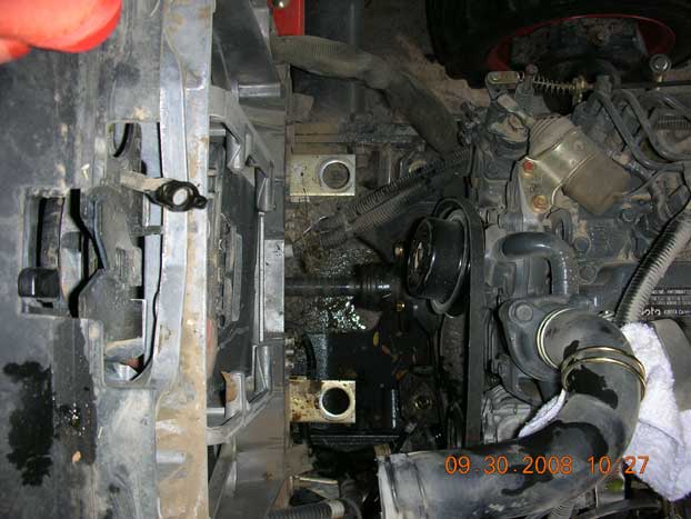

A few pictures of it apart. Oh, and yes, loosen the alternator.

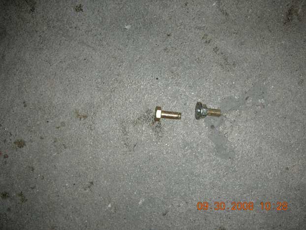

Only 1 broken bolt. The stick must have hit hard.
The fan that does not provide much cooling.

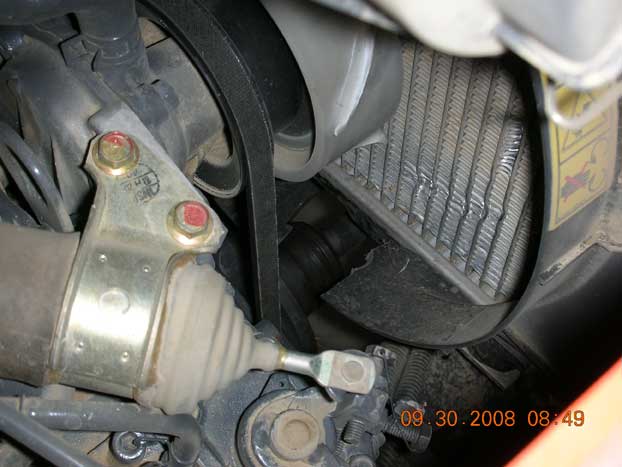

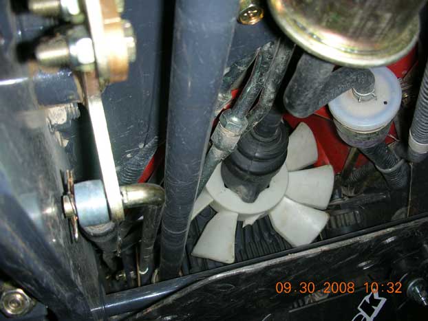

A picture of the HST fan that will be replaced also if I can figure out how. Tomorrow's project is taking the HST fan out. Any suggestions or guidance?

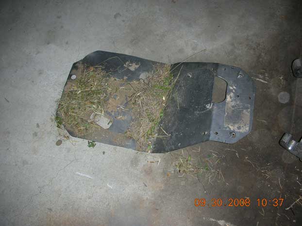

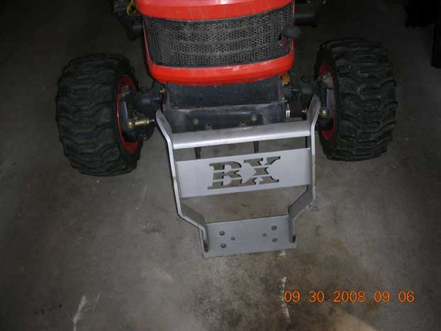

Remove the Bro-Tek skid plate.
Overall, less than 2 hours, spent a little quality time with the parents, and it appears I'll be back on the job Friday morning.

The parts for the radiator fan replacement finally arrived this morning. 4 days for parts. :mad:

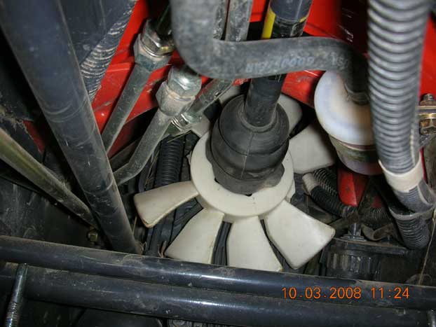

The first item I reviewed was the HST fan.
After figuring out the fan replacement was not an easy fix (for me) I decided to let it go for this job and replace it when I get back home in late November or early December.
When the stick went into the fan, it damaged the boot at the engine end of the driveshaft. This too would require removing the driveshaft and would be better served at home. An old inner tube, a little "Goop", and a couple of tie wraps should hold it together for 45-60 days.
I learned that the shroud has to be in place (not bolted), then the fan goes on, then the radiator slides in, then the shroud is fastened. If not in that order, you can try again, and maybe again. I was never very good at origami.
The tractor is back together, running just fine, and not overheating or leaking.

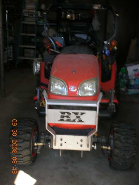

The next step (besides getting back to work) is to work with Bro-Tek on extending the skid plates more forward so this can NEVER happen again.

Hi Carsce,
As promised, I've got the Radiator/drive shaft guard done.
Let me know what you think, PS. never mind the PTO hydraulic pump in the picture.
Richard

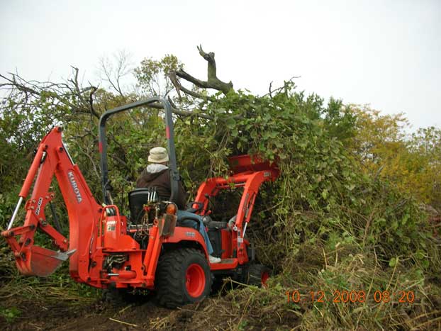

That looks real good. Just got back from another 18 hours of seat time over the weekend. It would have been 24 hours except I took another stick in the HST fan this time. Tomorrow the HST shaft will be torn out and the fan replaced.

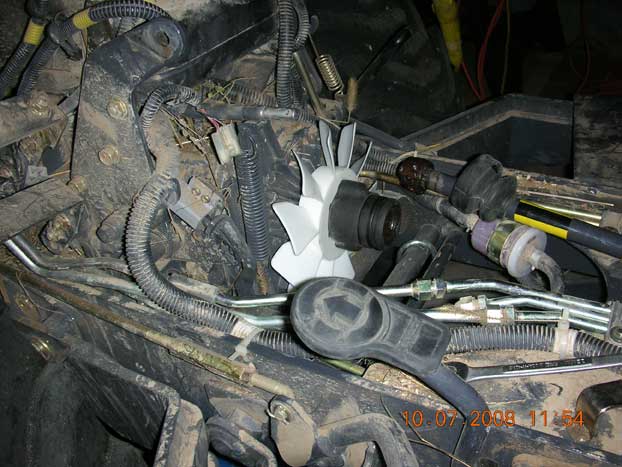

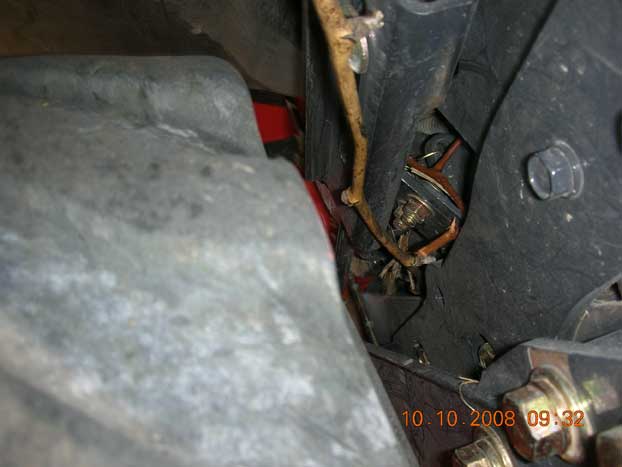

Just finished putting the BX back together from the HST fan replacement. Moving the engine forward was not as tough as I thought it would be. The worst of it was getting the handles off the levers for removal of the fender. It appears as if the handles had melted to the metal lever from the Arizona heat! The entire job was 10 hours of work over 2 days.
   / BX24 Radiator fan replacement
#13
It didn't take long to get another stick in the HST fan. Just under 24 hours of seat time and I heard the fan noise twice.
The pictures are of my new fan installed and almost completed and my new HST fan with a stick. The last picture is the same stick except from the fan end. The stick end is barely visible near the fan.
Nothing was broke, it just made lots of noise. :eek:

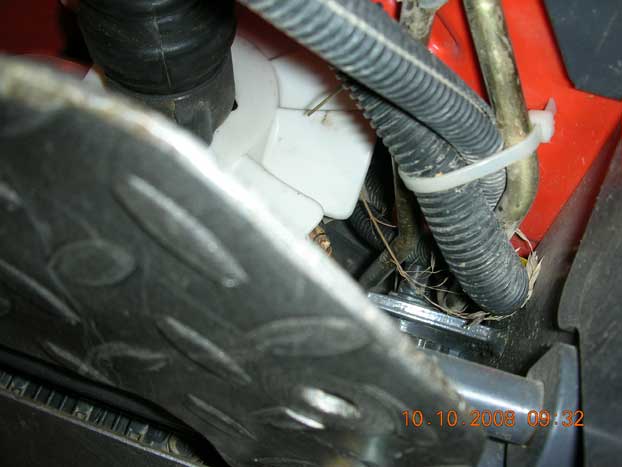

If I had not been cheap and would have bought the Bro-Tek front skid plate with my rear skid plate, the HST fan would have been safe. Richard (Bro-Tek) is building a radiator fan protection plate and I will post results here after a week or so in the woods.
Santacruzer, get all the skid plates you can! I like Bro-Tek's.
Donn12, The HST fan shaft (referred to as the propeller shaft) has 4 small ball bearings and rubber ring dampers inside. They sit in grease. I stuffed as much grease as possible behind the snap ring and washer, then put the inner tube fix over the top. Dirt would sure make those small parts wear out faster IMHO. And yes, I would recommend Bro-Tek's skid plates.

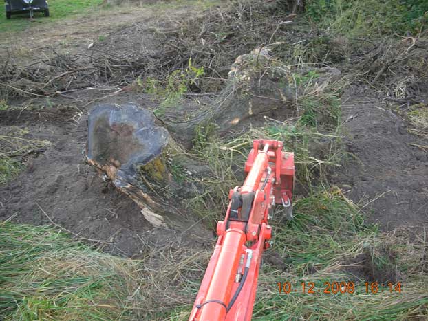

If Bro-Tek's plates can protect my BX24 in this stump row cleanup, it'll protect your BX also.
