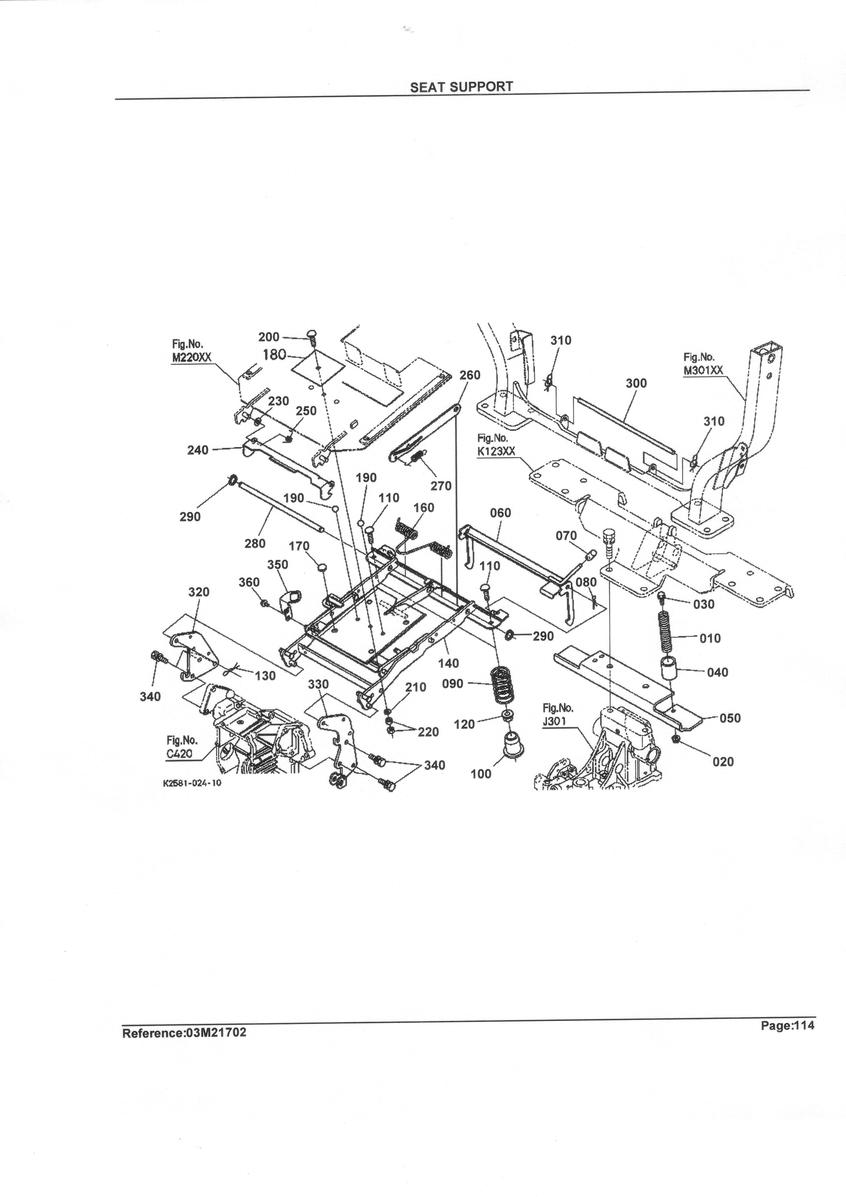

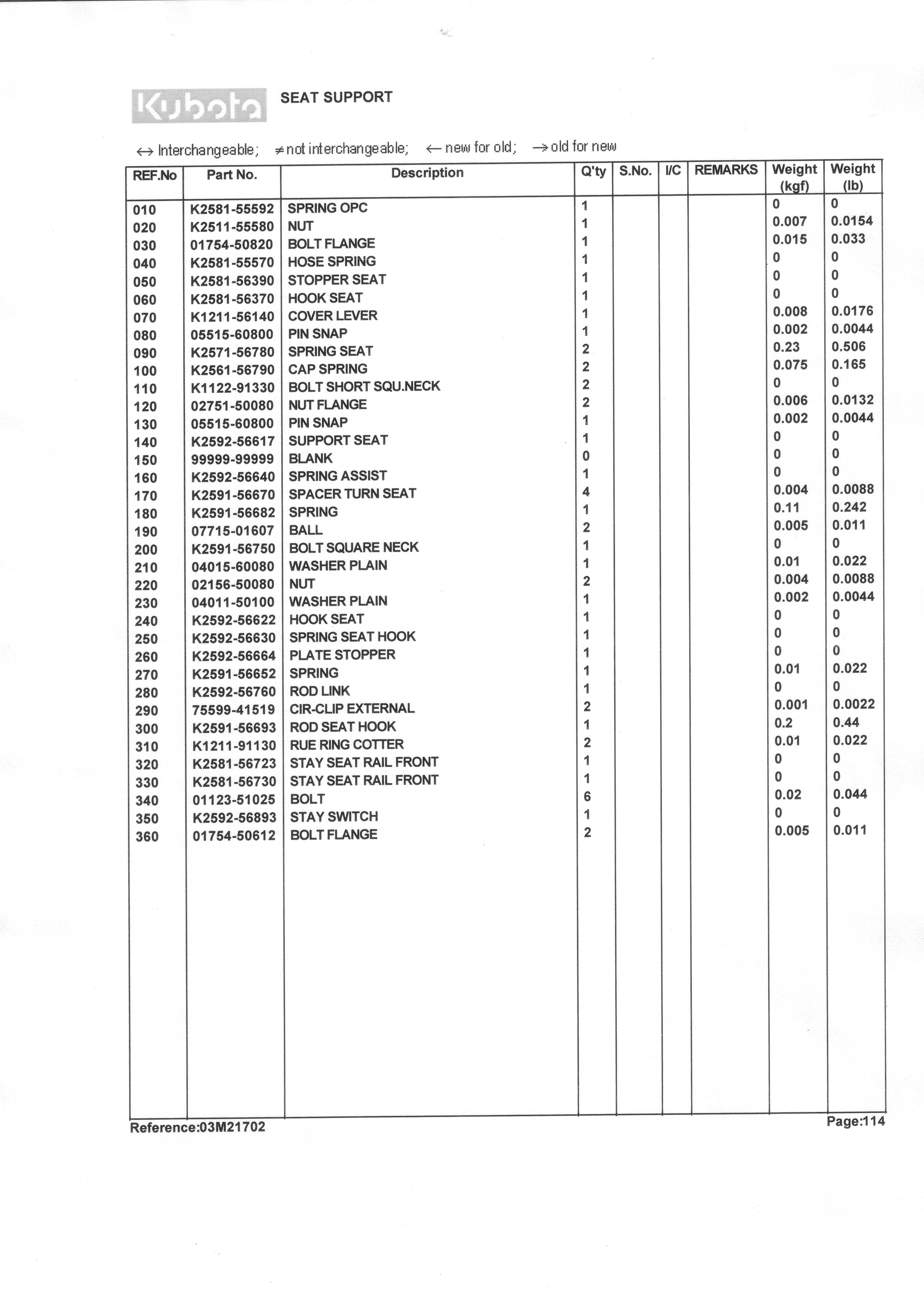

Same thing just happened to me. I've lost one of the ball bearings and one of the nylon pads. (I'm a bit annoyed by this; the tractor is just 2 months since purchase so shouldn't the dealer have picked this up during pre-delivery?) In case I find the missing bits does anyone have a diagram showing how it all goes back together?
   / BX24 swivel seat mechanism came apart
#14
these might help.
You've probably got it fixed by now, but this will show you if you got it right.
