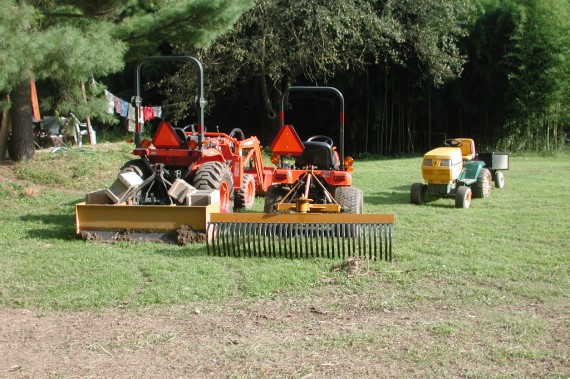

   / BX24 vs B21 TLB ? #9
Apples to oranges comparison from my view point.
Attached is a photo showing a my BX2200 next to my B2910. The BX is very close in size to the BX24 and the B2910 is close in size to the B21 (same rear tires).
IF you get some experience with the B21, I would venture to guess that you will NOT be satisifed with the BX24 afterwards if you have to do much work with it.
It is just SMALLER...smaller takes longer, backhoe reach is less, digging debth is less, and so on.
Hope the picture is worth the 1,000 words it is supposed to be! /forums/images/graemlins/grin.gif

   / BX24 vs B21 TLB ? #10
I think Jim is correct if you have little tractor/TLB experience it might be worth testing the B21. Seeing what a TLB is capable of will be useful. However, I'd try to get the dealer to set up some way for you to perform a similar task with the BX24 on his lot once you've experienced the B21. As everyone has said, the B21 is a much more capable machine. Kinda like trying to assess if you'd be happy with a Ford Ranger pickup on the basis of test driving an F250.
