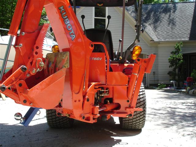

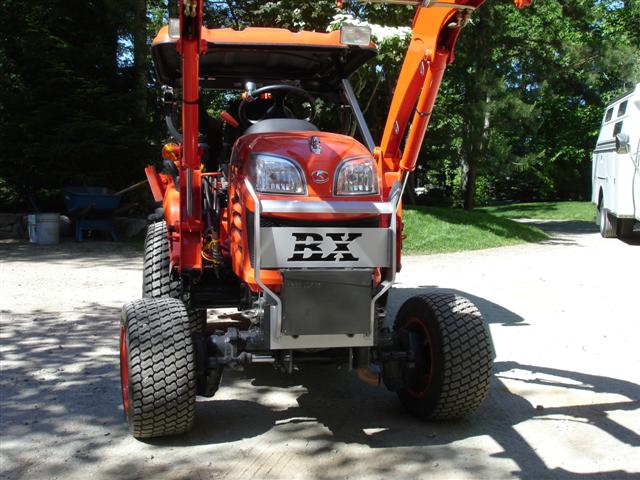

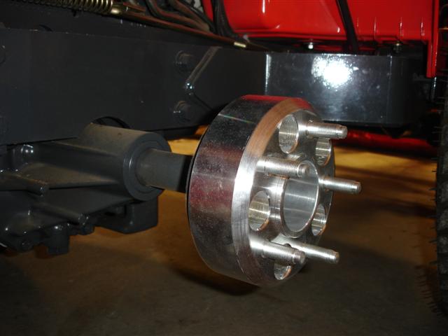

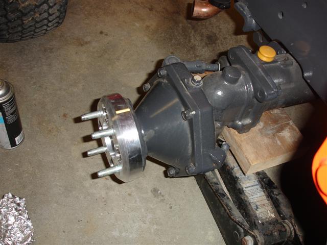

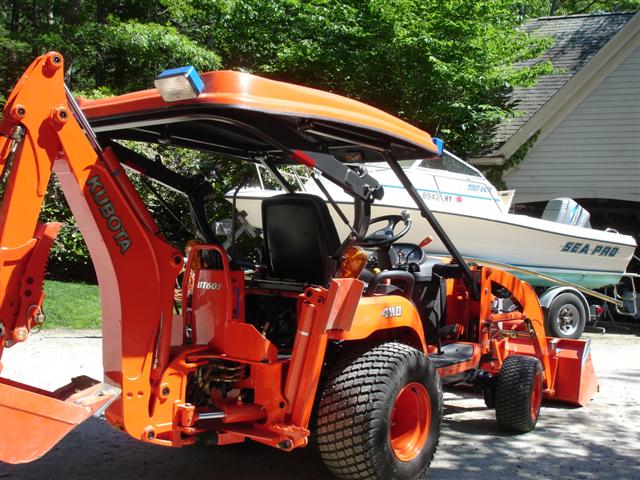

I ordered a rear set and had Richard fabricate a front set also, though not quite as wide. They are aluminum and nicely finished - a note of caution though - I found the studs were not pressed fully in & had to redrive all in with a punch prior to mounting them. Prior to install I would get the creeps at about 15 degrees - now the tractor feels more stable. The rear wheels still track inside the FEL. If you have grades to deal with it's good insurance. You can see the wider stance in the pictures.

I notice a difference with the rear spacers. Seems much more stable, especially when turning around on a hill which scared the crap out of me before. If I have to replace seals or something it's cheaper than a funeral.
