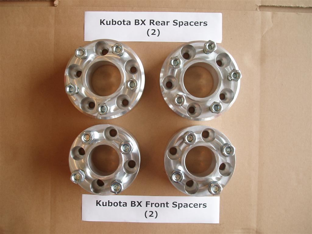

Sneak Peek...
2" front and rear BX spacers. Stay Tuned. We are currently doing time studies and polishing the design and CNC production methods for possible sale to the public.
More information to come. --

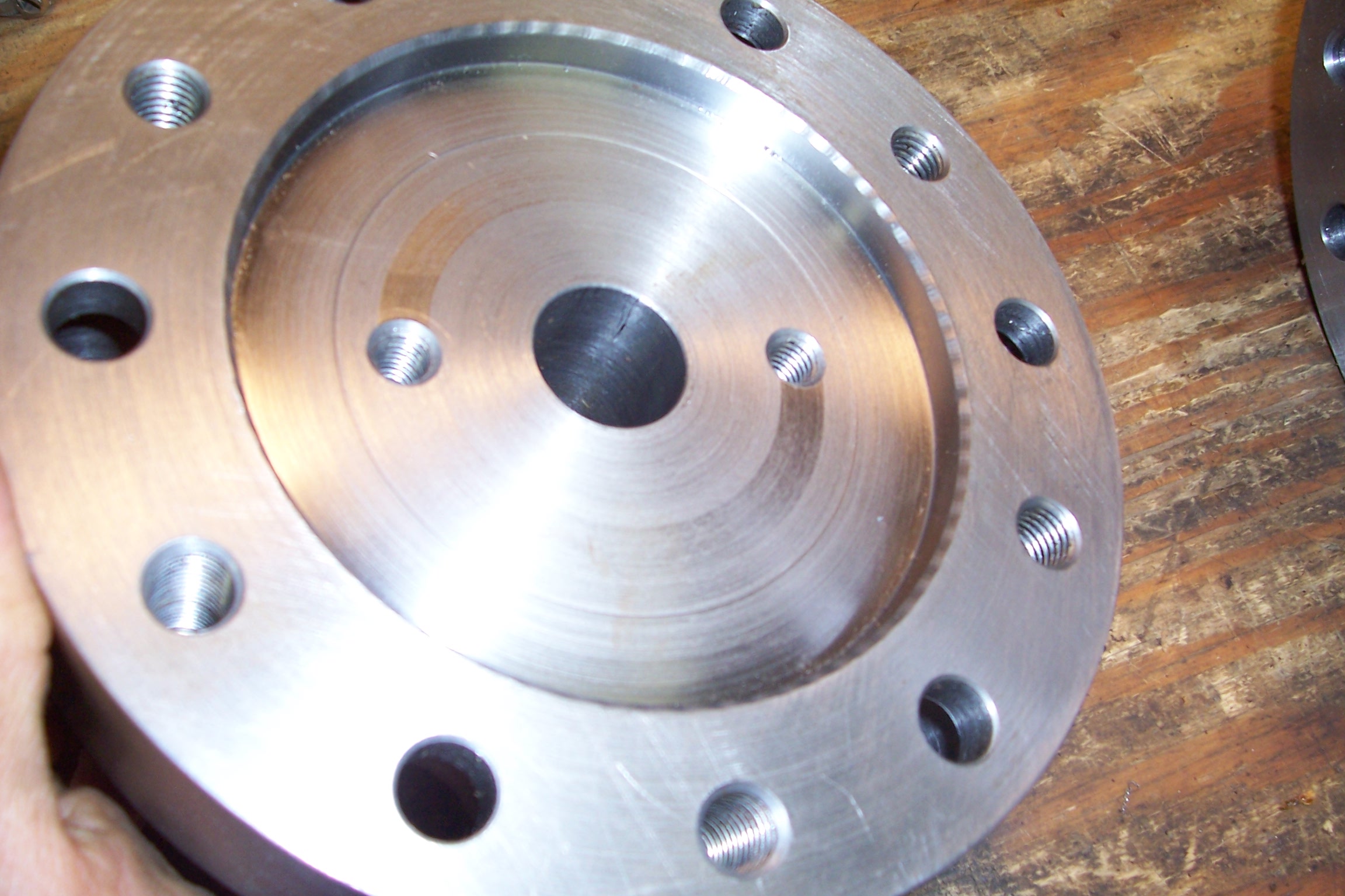

hello in my oppinion the ebay ones arnt to good becase they dont have the turned diamitor to fit in rim when bolting down ,also they need the counterbore to mount extention to weelhub if thats not there u are running on bolts.

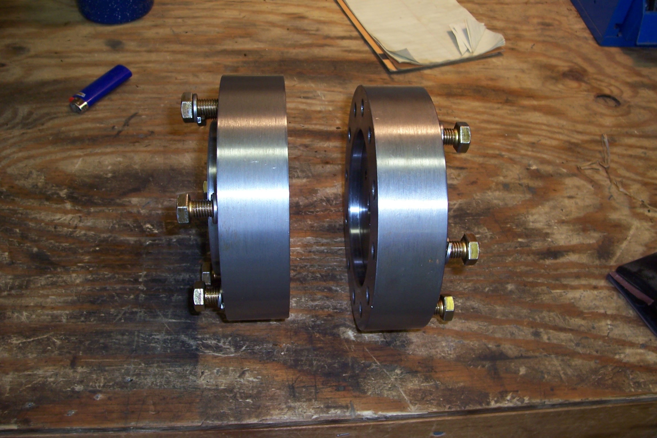

for jd 2320
100_4128.jpg[/ATTACH][/ATTACH]
   / BX24 WHEEL SPACERS DIFFERENT SUPPLIER #16
Turns out generous welding means seriously welded as to be differentiated from just tack or spot welded, doncha know, eh?, and inside bolt holes are tapered to fit lug bolts and spacer fits over hub shoulder as well and outside is smaller diameter with radius to fit into rim, so they fit up snug and work just fine for me, but suit yerself!
