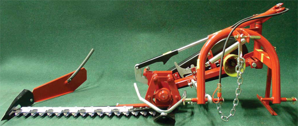

Sickle mowers for small tractors here (these are new, from Italy) I don't know anything about them, just found the website.
DCM Italia s.r.l. - Sickle bar mower BF MJ
Seems to be available in the USA (Texas) for $5213 (new).
I'm still planning to fix my $150 mower.
